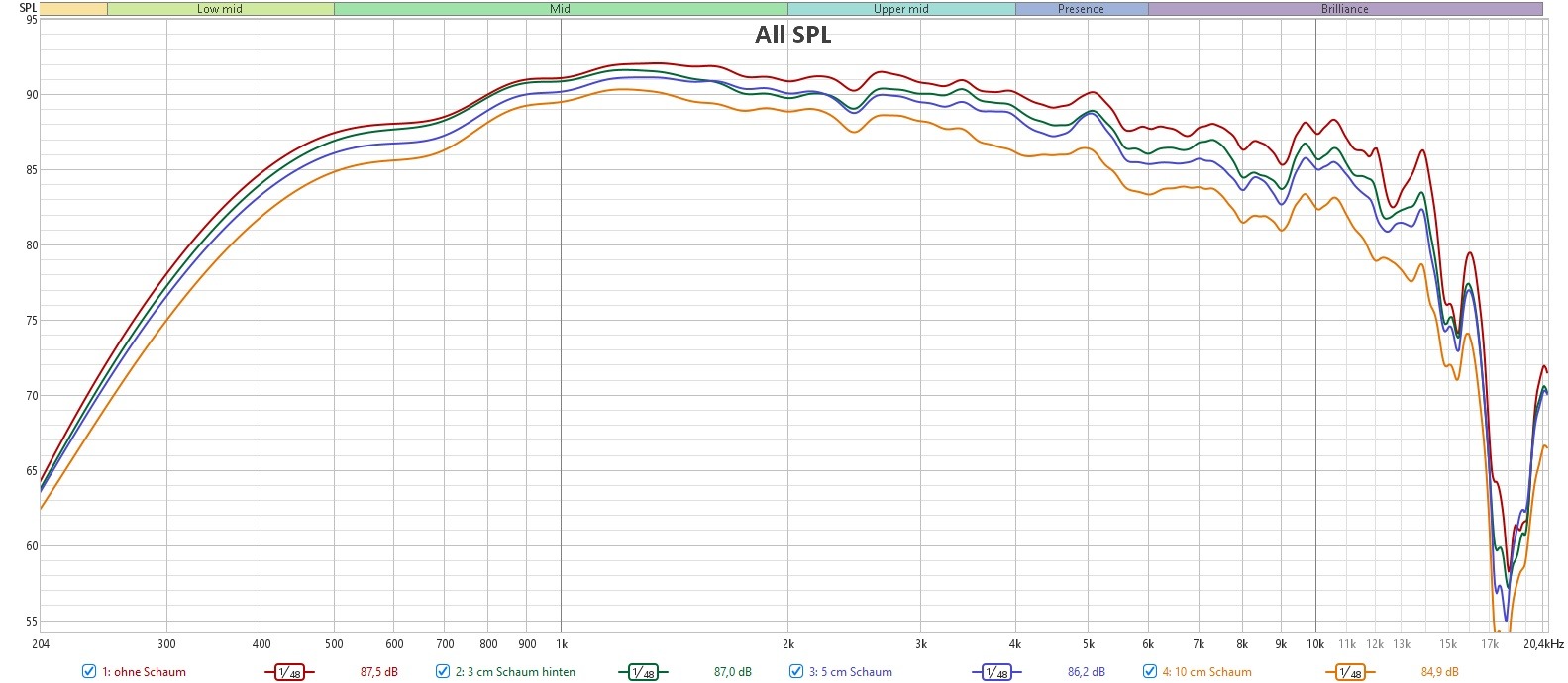

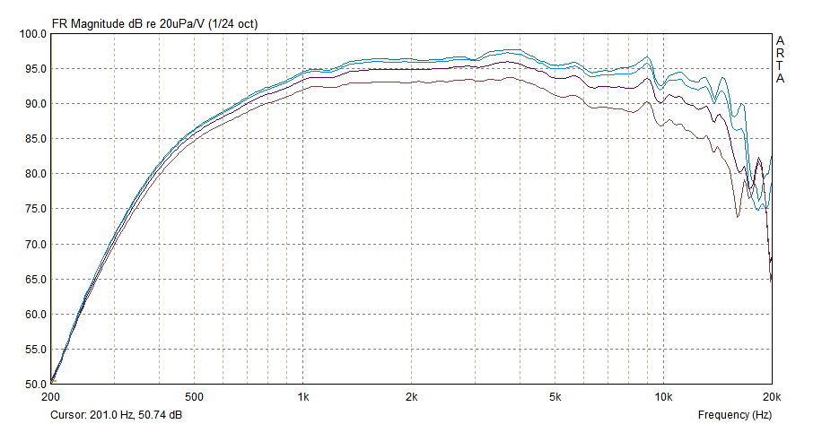

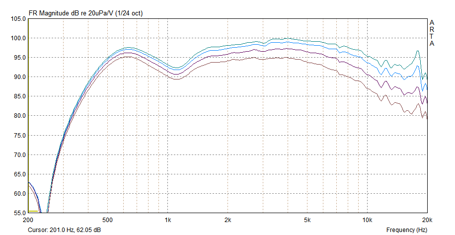

I tried damping the Enclosure with open cell foam and got rid of most of the wiggles and reduced the dip at 2700 Hz but I couldn't got rid of it entirely. Maybe i have to try different damping materials or the suggested open back enclosure by oleg. I guess one would lose some low end extention with an open back though?Are the wiggles >6k also there without the enclosure? Could be multiples of the first resonance.
I also tried the foam plug in the throat extention and that reduced some of the sharp high frequency swings by the cost of sensitivity. I lost around 2dB in the midrange and up to 10dB in the upper treble. But the distortion at 90 dB SPL is still down at -50 dB so it should be easily EQable for home listening levels.
That's probably not a good trade-off, 10 dB is a lot (too dense foam). But I was interested in your findings. When I tried this with an extended throat, it behaved differently - gave almost a flat level reduction across the band: https://www.diyaudio.com/community/...-design-the-easy-way-ath4.338806/post-7475065I also tried the foam plug in the throat extention and that reduced some of the sharp high frequency swings by the cost of sensitivity. I lost around 2dB in the midrange and up to 10dB in the upper treble.
In fact, it reduced the level of the extending resonance the most, which is perhaps expectable after all.

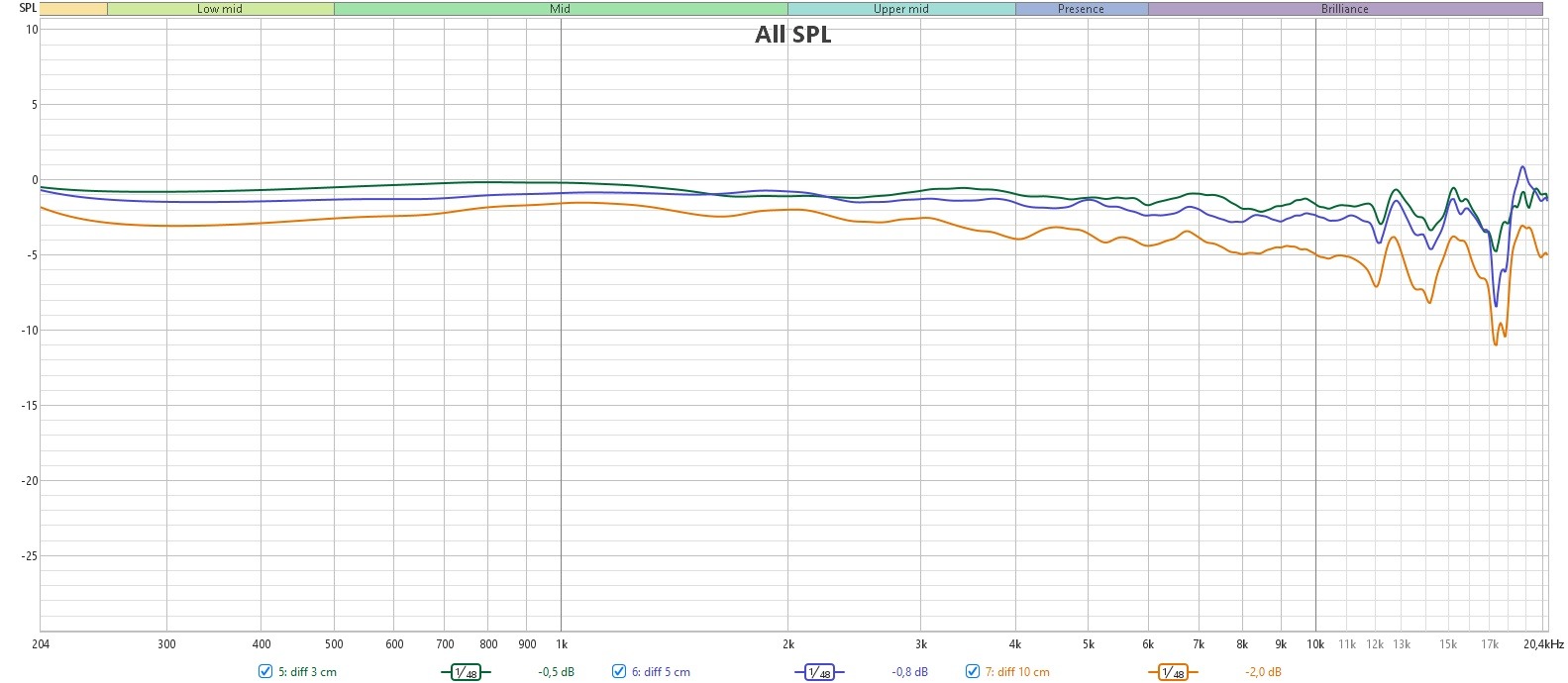

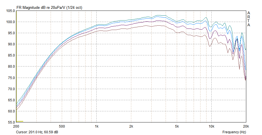

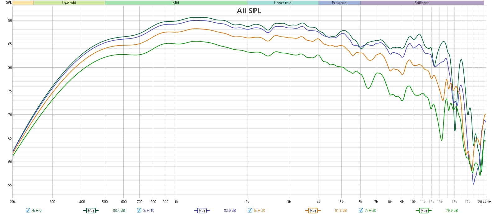

OK, i just plugged the whole extention with a 10 cm long cylinder yesterday. I just now tried a few different lengths.
red: without plug; green: 3cm plug; blue 5 cm; orange 10 cm
differences between no plug and 3, 5 and 10 cm.
With these results i think I'll stick to the smallest size of 3 cm. here I have the lowest loss in the midrange but still a bit tidier upper trebble than without a plug.

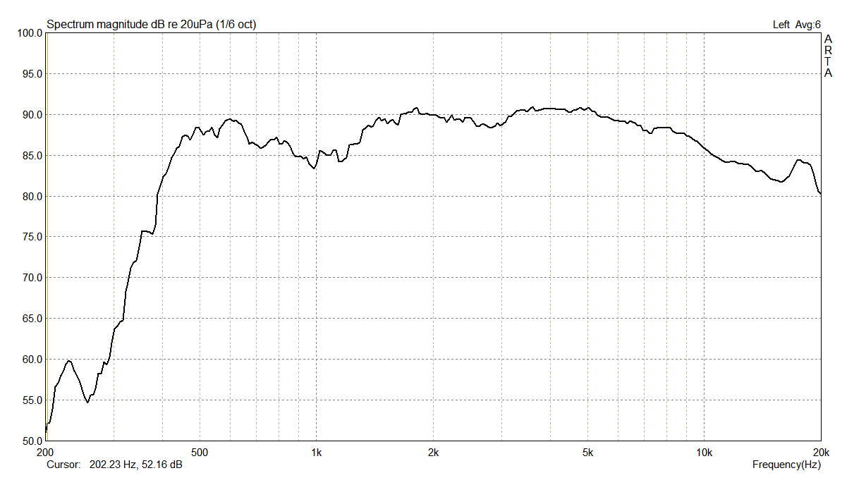

Do you have a measurement without the back enclosure attached? it seems as if acoustically it is not doing any good.With these results i think I'll stick to the smallest size of 3 cm. here I have the lowest loss in the midrange but still a bit tidier upper trebble than without a plug.
Thanks for the input.

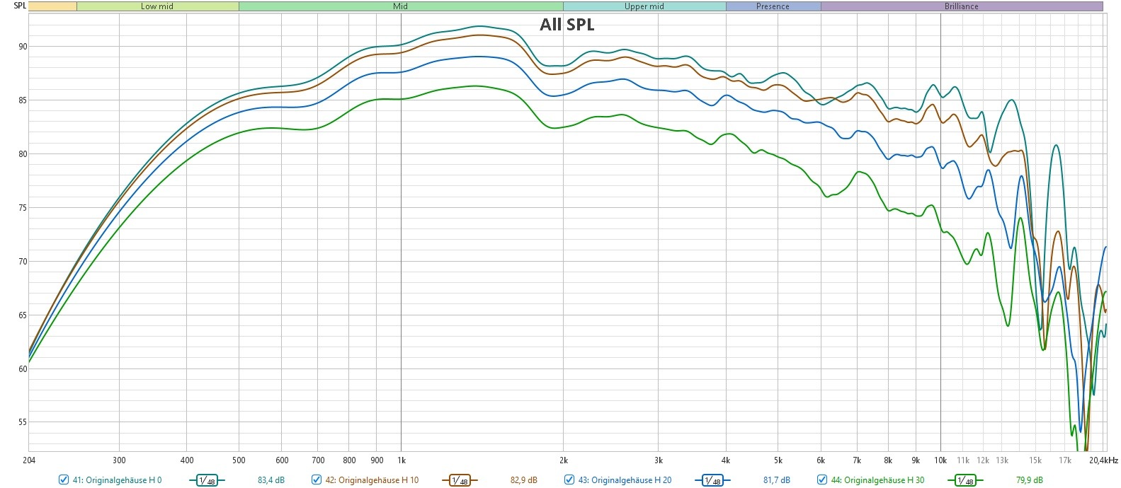

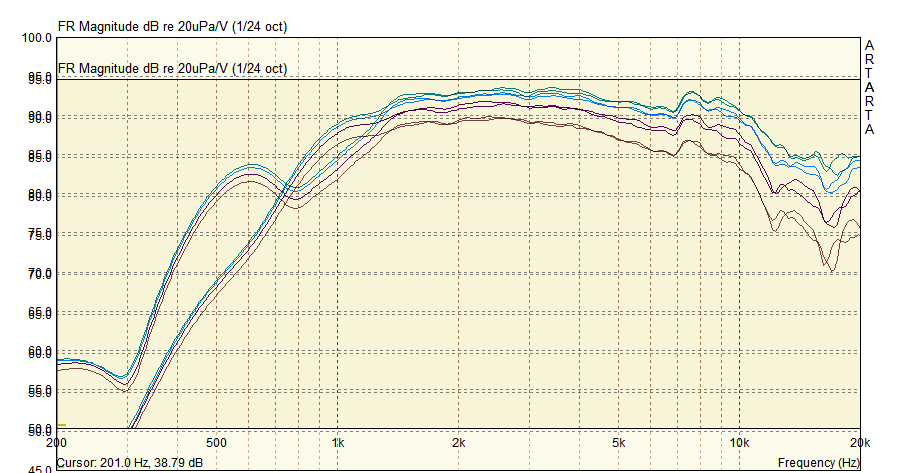

Original enclosure
larger, 3d printed enclosure, all else being equal
I don't know... both enclosures have some peaks and dips. In my opinion the midrange of my enclosue looks a bit smoother except the dip at 2.5 kHz.
Your enclosure is certainly better behaved and I wouldn't expect this difference. Such narrow, relatively high-Q dips, like the one around 2.5 kHz, are typically not audible at all. With a custom casing I would expect that it should be possible to get rid of all the additional resonances, simply by enough damping (?).

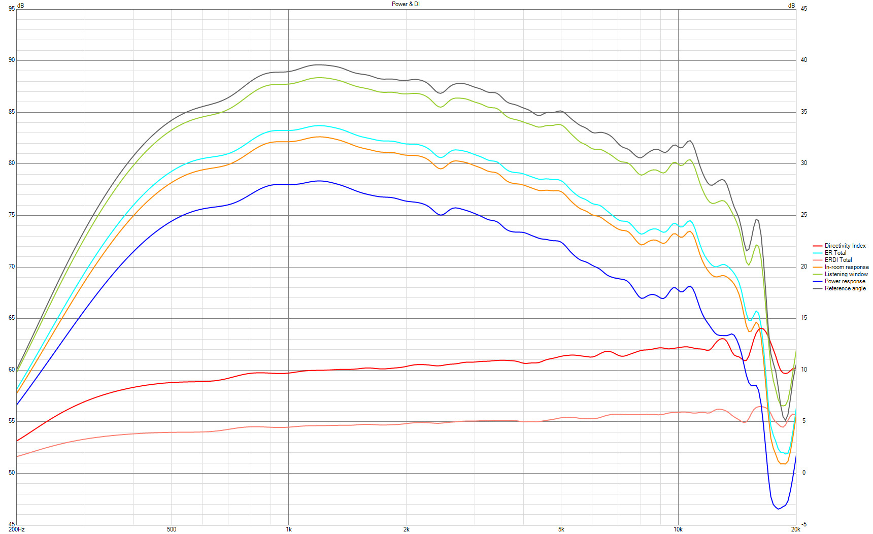

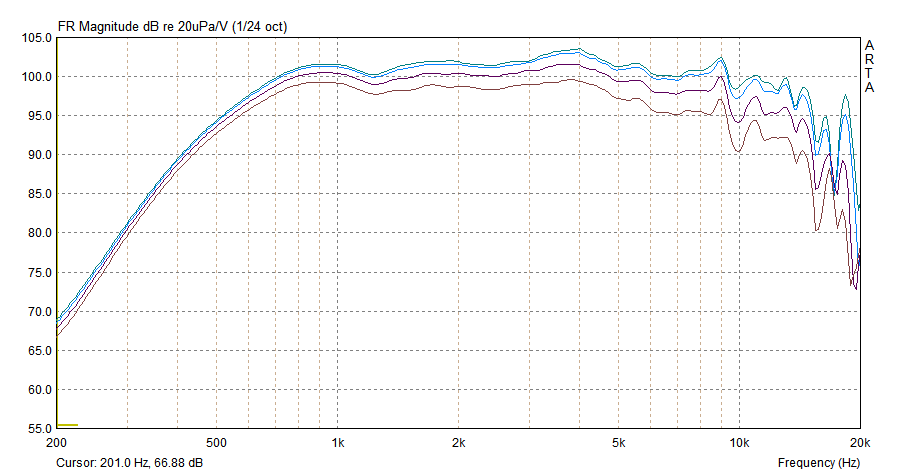

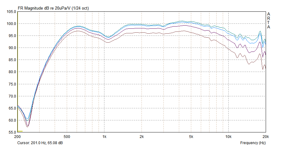

DE360, A520G2 with a) 25-STD-1 and b) a simple conical 1->1.4" extension + 36-STD-1 (absolute levels do not match):
a)
b)
I think I really need to collect all the available data and look properly into this to gather what's going on. There must be a simple and predictable principle, since at these wavelengths (below 2 kHz) it must all be at lumped-element level. This seems as a nice study case. The cut&try approach is not very sustainable...
a)
b)

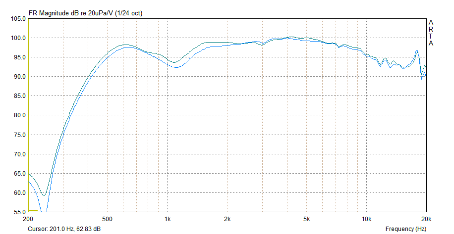

The Fane CD131
800Hz / 8 and 6 BQ
https://www.fane-international.com/downloads/Fane-CD131-DS240316.pdf
Is the impedance in the spec sheet correct?
Looks OK! The sensitivity looks lower than the other drivers.
DE360
800Hz / 6BQ
800Hz / 8 and 6 BQ
DE360
800Hz / 6BQ

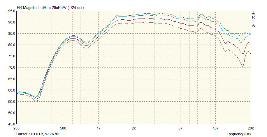

1" Faital HF108 with A520G2, the same driver with two different throat adapters.
25-STD-1 (12° opening angle)
25-STD-2 (31° opening angle)
