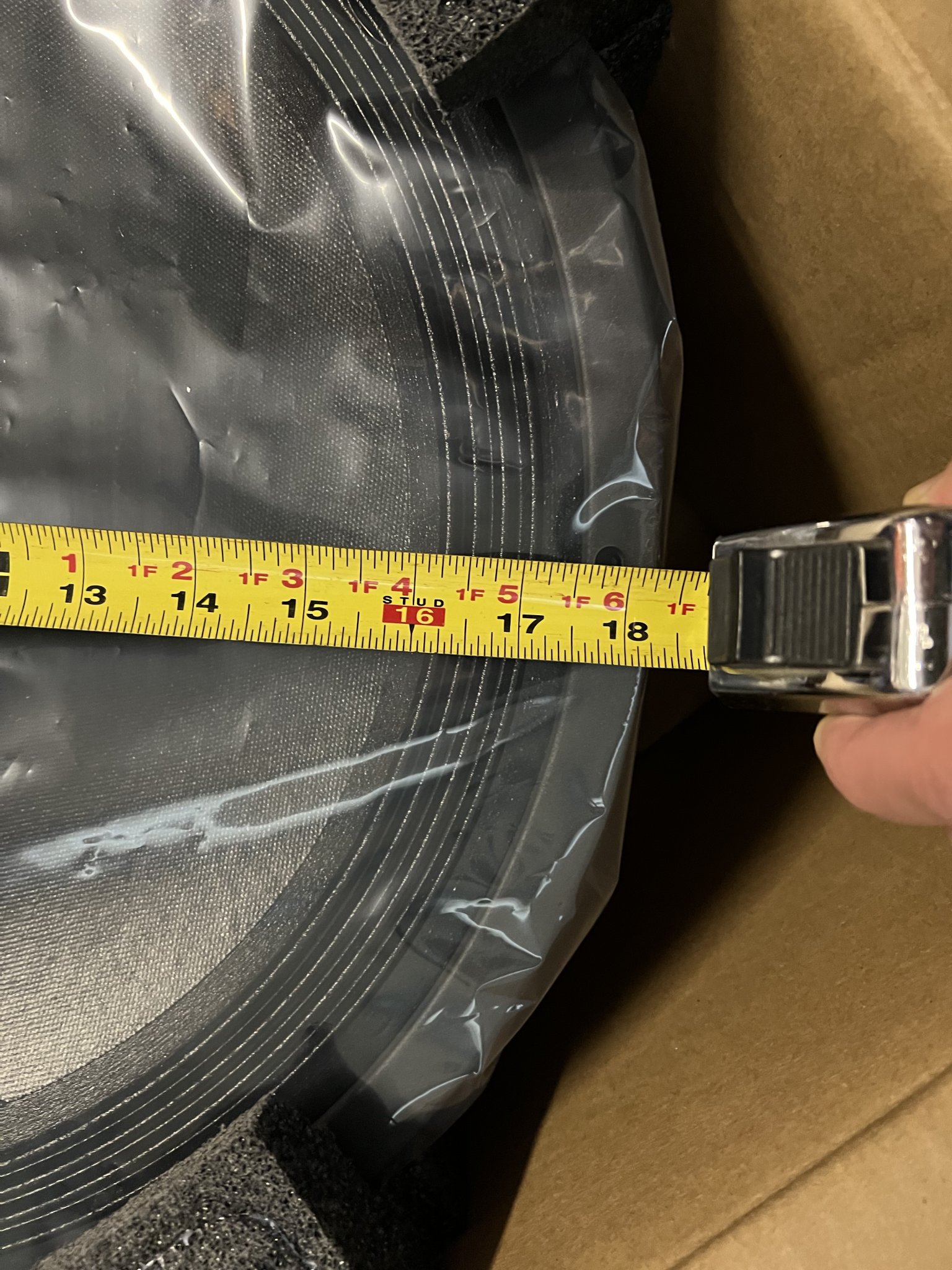

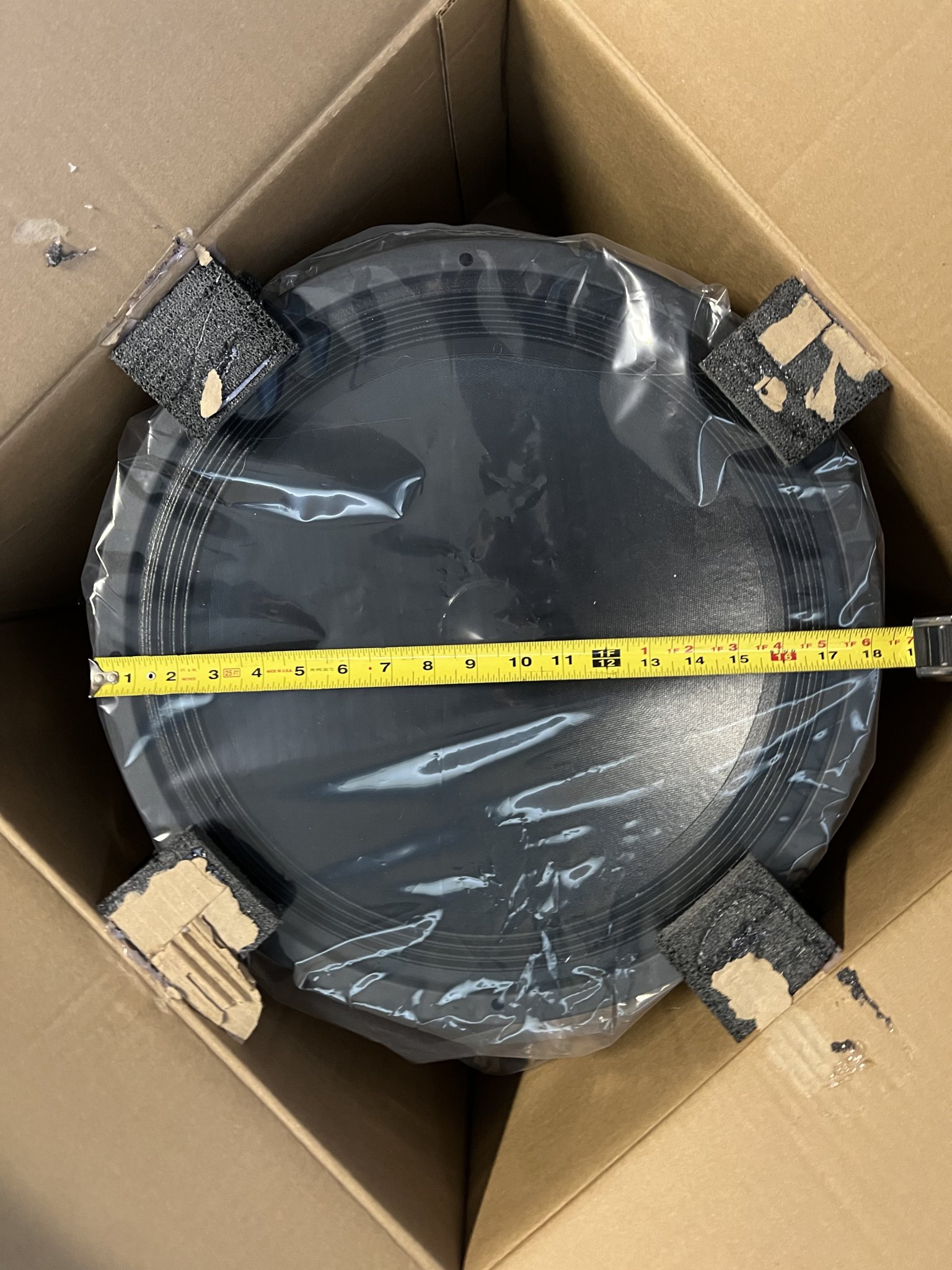

Not sure how much info you need.
This is a Dipole 18 I had sitting in the garage that came back a while ago from a recone.
With the rubber gasket in place on the frame I would call the diameter 18 3/8”.
I measured bisecting two mounting holes opposite each other.
Posted in other thread after seeing tech drawings…there’s a discrepancy that would make me wait until I had the drivers and could actually measure them.
Now that I think of it, when mine was rebuilt (just after Covid) I thought the owner mentioned having to find new sources for materials.
This could result in some dimensional discrepancies I would think.
