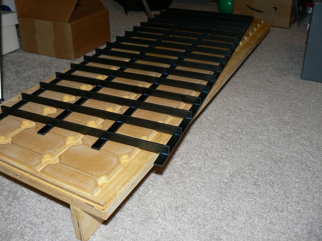

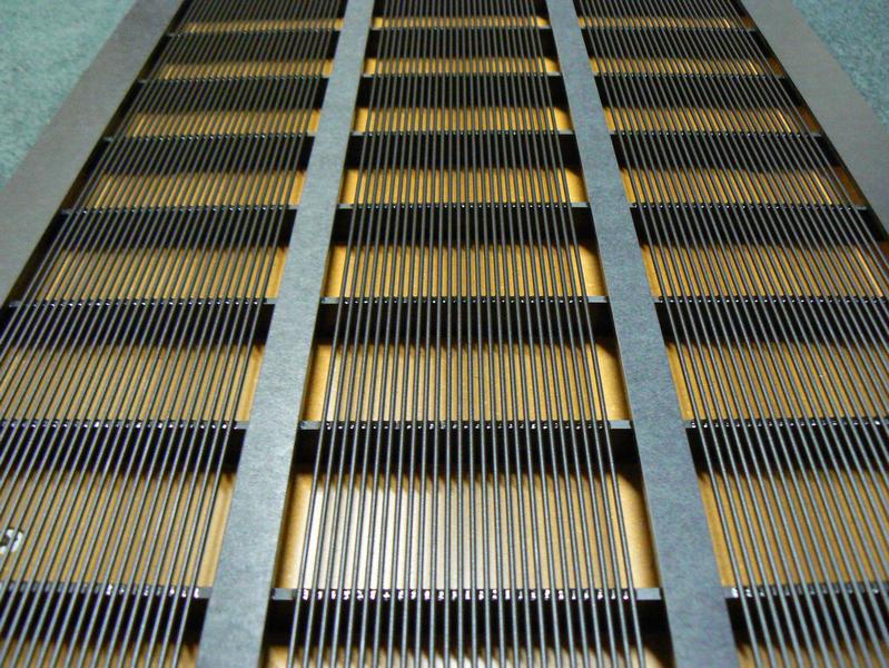

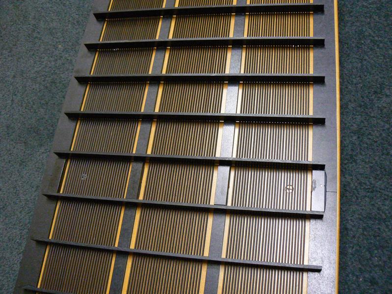

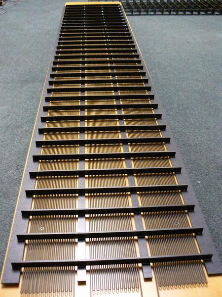

Bolserst, I'm curious on the construction of your FR4 panels. Would you mind posting a picture or two?
I don’t have any pics of the FR4 panels, but the construction is identical to my other phenolic panels that I do have some pics for. The differences were only in thickness and width of the different spacers. In particular, I reduced the width of the inner spacers to minimize loss of radiating area.
Besides the top and bottom view of the stators I had previously posted elsewhere, I recently located two other pics on an old cell phone. The first one shows a stator frame section after removing from my gluing jig. The jig lets me build stator frame sections up to 36” in length. Then I can glue 2 or more sections together to get whatever height ESL I want. The second shows the glue joint between two stator sections.
For those who haven’t seen them before, I posted other details and polar measurements for one of my ESLs here:
http://www.diyaudio.com/forums/planars-exotics/245454-glue-wire-stators-3.html#post3708397

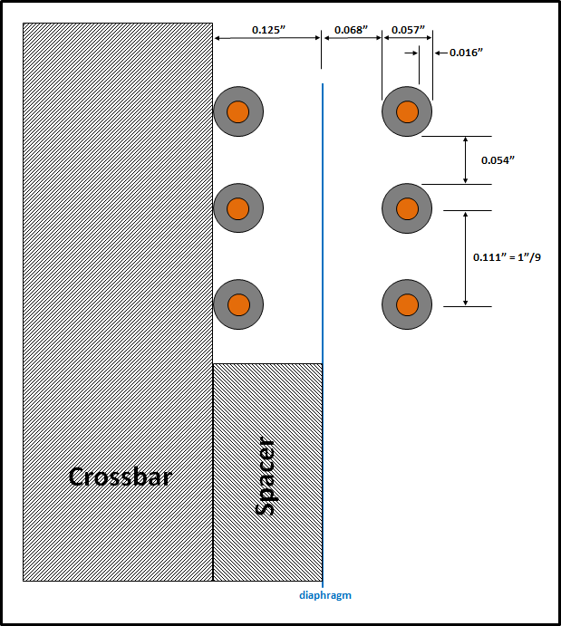

…I can use relatively thin 0.093-0.125” sheet glass epoxy laminate for spacers/perimeter mounting strips achieving required D/S without additional spacers.
Exactly. This approach used by Audiostatic, Capaciti, Silberstatic and others really simplifies the construction process.
By juggling spacer thickness and wire diameter you can get most any D/S spacing you desire.
Last pic is an early Silberstatic panel made with clear polycarbonate or acrylic….not sure which.

Thank you for the pics! Indeed a picture is worth a thousand words.
I noticed a couple of things.
Your panels have roughly 50% open area. While there is an opinion that smaller ( 30-35%) open area yields max SPL I thought that smaller open area should result in lower SPL. Dependence of SPL on open area has a bell curve. At 0% open area SPL=0 because all sound radiated by diaphragm is reflected. As open area increases the % of reflected and diffracted sound decreases and SPL increases even though electric field force decreases. Actually ML increased open area in Xstat panels to more that 50% and they claimed that it allowed them to increase SPL. Do you believe that max of the bell curve is around 50%?
It looks like you are gluing diaphragm directly to the stator. According to Capacity it could result in bad CSD and he was suggesting “adding a damping layer at the outer edges of the membrane area to minimize longitudinal resonance modes.” http://www.diyaudio.com/forums/planars-exotics/168069-esls-have-bad-decay-plots.html.
What is your experience?

… Do you believe that max of the bell curve is around 50%?
It depends on many factors including comparative size of gaps between wires relative to the D/S spacing. But, it is generally closer to 40%. However it is a broad bell curve, not peaky. So, you can use higher % open area without losing much sensitivity. The benefit to higher % open area is increased acoustic transparency in the top octaves from reduced internal reflections.
Yes. Damping of the diaphragm resonances is accomplished with acoustic resistive mesh. (Capaciti did not use this technique). I experimented with damping compounds applied to perimeter and it was very sensitive to application technique, and didn’t work as well as acoustic damping. BTW, the 3M foam tape that is often used by DIY builders for spacer material does not provide much if any damping.

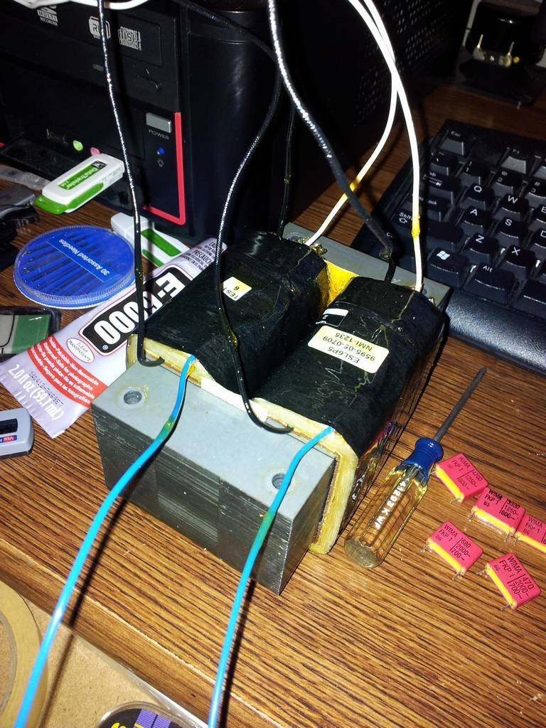

Bolserst......can you tell us what setup tran you use with your panels....an the best sounding you found..for full rang an above 80hz....thanks
For segmented panels the best transformers I have found are those built using twin bobbins and simple winding technique on UI or C-core. Attached is a pic of the transformer I had wound to drive those panels.
More details here:
http://www.diyaudio.com/forums/planars-exotics/286989-about-take-esl-plunge-11.html#post4633075

With this winding configuration there is a lot of flexibility to trade off power handling and parastics. Also, the octaves above 20kHz are clean from the multiple resonances often seen in toroidal or EI core transformers.
Is your bass equalized, and how far down do you have usable lows?
As mentioned in the post I provided link for, bass is equalized thru segmentation and carefully chosen and damped diaphragm resonance. Response is flat down to about 65-70Hz where it starts rolling off at 18dB/oct, although it sounds clean even at 30Hz.

With the FR4: if a person were to build panels just like yours but use welding rod glued directly to the FR4 instead of insulated wire, would it make any difference(insulation wise for the various segments) between the black(probably containing carbon) and the natural. Most likely not, but I was just curious since I'd prefer the black just for the looks. As you can tell, I'm having a difficult time in comprehending the theories of good ESL design.
Again, sorry if this is OT. Any more questions, I'll post in another thread.

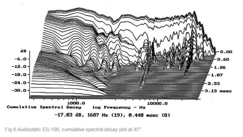

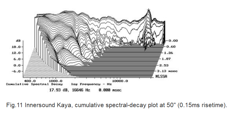

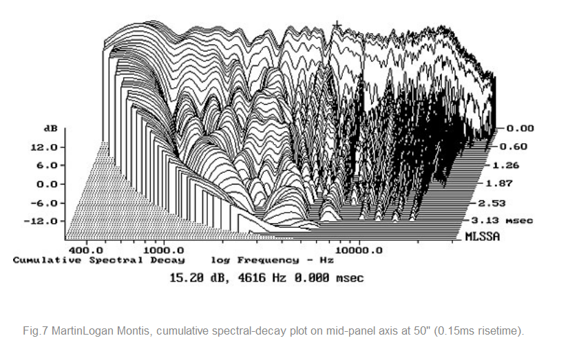

I did not pay enough attention to the fact that the majority of published hashy HF CSDs belongs to curved ESLs. I did find in Stereophile some what hashy HF CDS which belong to flat ESLs. They still look better than those of curved ESL

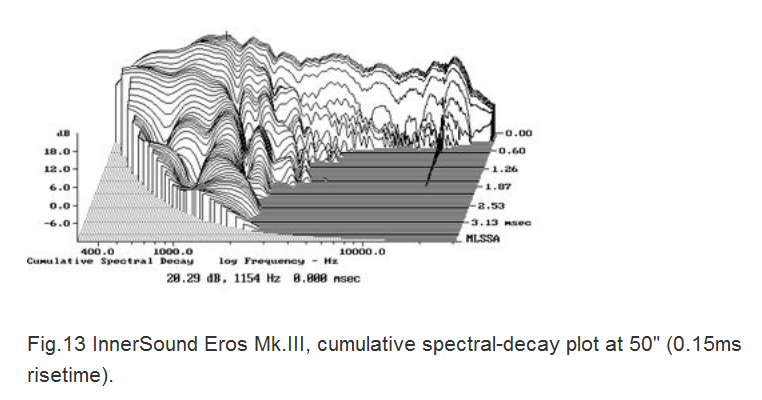

Yup, those still look pretty decent, although I didn't select them for the curved vs flat comparison to keep things on a more apples-to-apples basis.

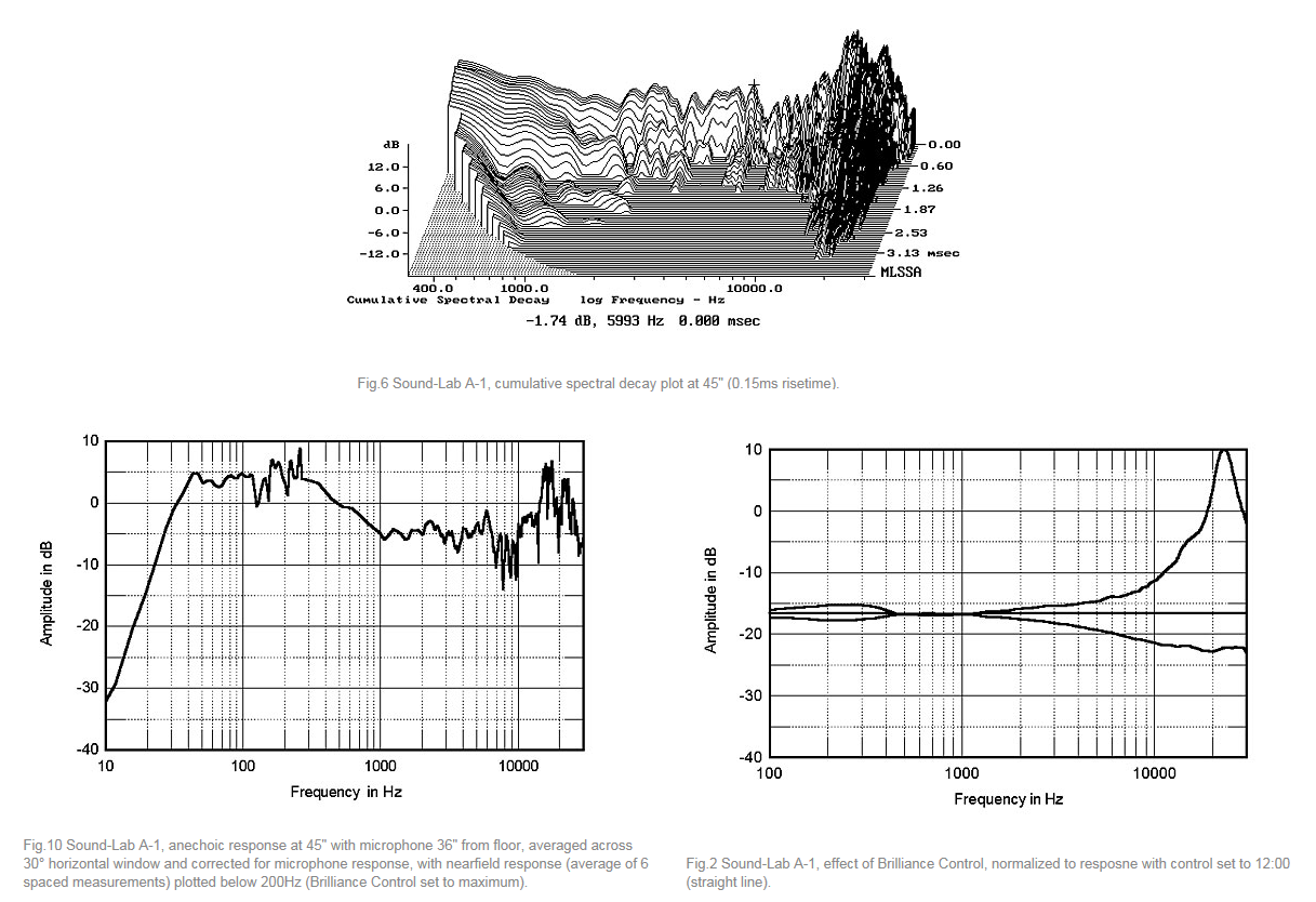

It is unfortunate that the published CSD for the Soundlab’s used the impulse response with the brilliance control set to maximum. This puts a nearly 25dB peak in the electrical response near 20kHz. The dominate HF ridge in the CSD is due purely to electrical response, not undamped diaphragm resonance.
The Quad ESL CSDs rather than being "hashy" have just a few very narrow ridges which I believe are caused by internal reflections between the ESL diaphragm and the two(front & rear) dust cover diaphragms.
