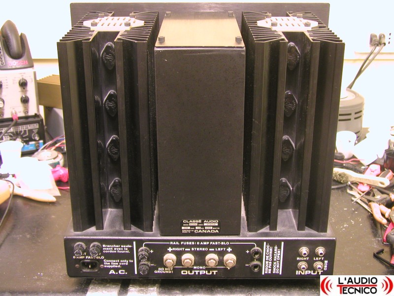

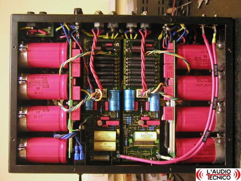

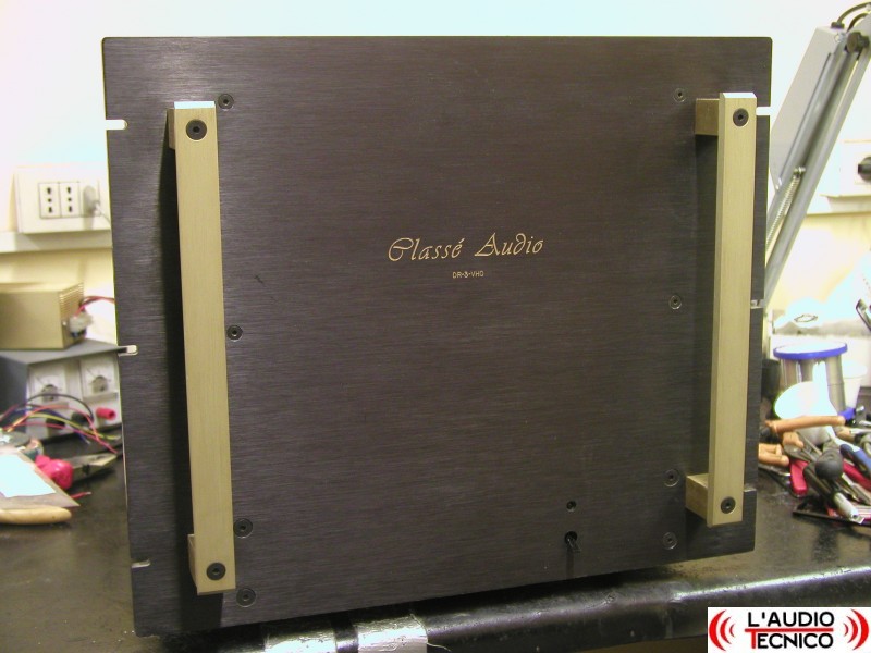

Classé Audio DR3 - VHC The letters V.H.C. stood for Very High Current
