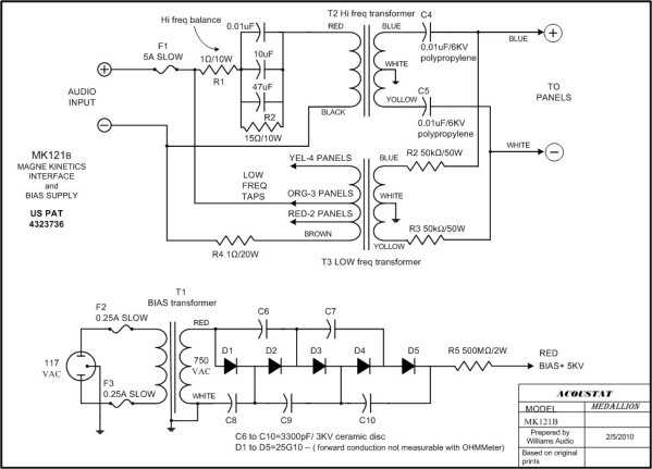

Acoustat 121 has two tranfourmers an one bias in ea. interface.
Your 131 has a diff tranfourmer ... just for 200-300hz up.... it may work for the top end.....someone can say .....i never seen it done....but the same bias tranfourmer.....so all you need to do is find a pr of 121s someone is saleing an you good to go...see in the pix the biger type box is a 121...more info here..http://www.audiocircuit.com/Home-Audio/Acoustat... good luck.........Long Live Acoustats

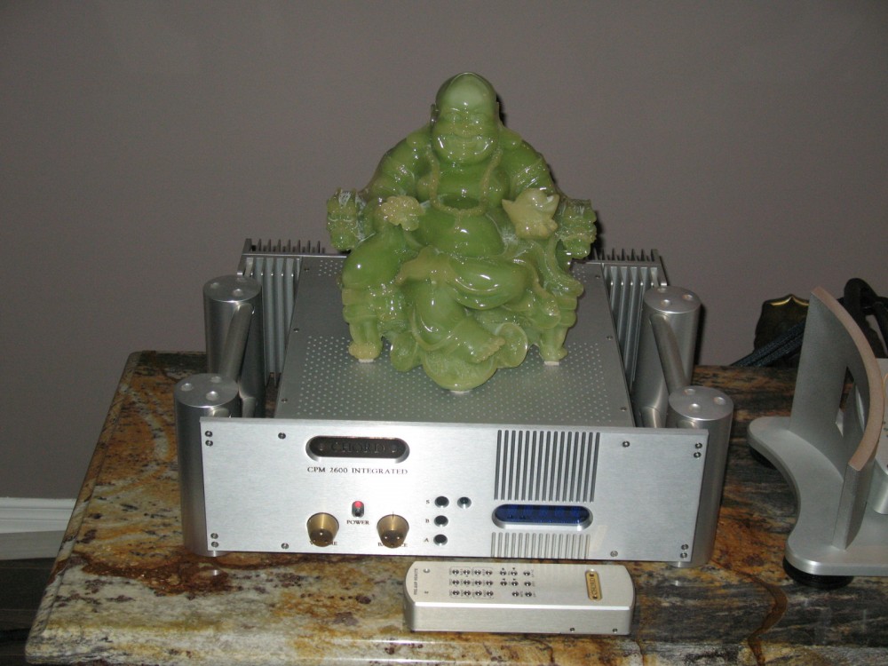

I have been using the small Chord CPM-2600 integrated amplifier with my Acoustat 1+1s for close to two years now without any issues but to be fair i don't listend very loud with Acoustat's you don't have to everything is there even at low volumes at least for me my living room is 14x20x8 feet and also is in a condo i do respect the other owners.
PS: I now know how to attach files and i promiss that i will no longer use Photobucket on this forum ever again.

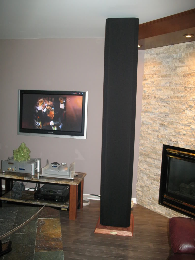

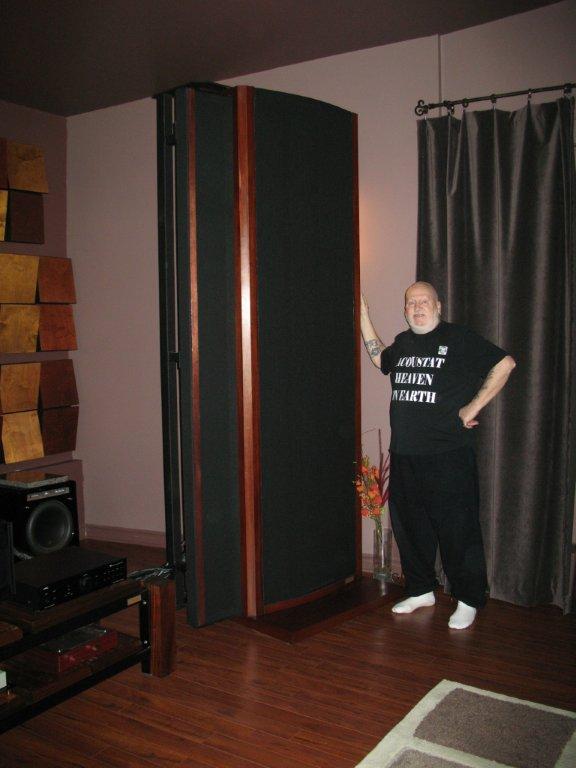

Andre, after you put your 1+1s in steel frames, how much did they change in terms of bass response? I bet they do not wobble at all like they do with mdf frames. How much do they weigh now?
Hi noelm, the steel frames was a major change in both my 1+1s and my friend Jocelyn's Spectra 8800s 200 pounds for the baby and close to 800 for the dad.🙂🙂🙂

The 121 interfaces are over 30 years old...Just littel lov..an you got some of the best ESLs at any $$$
An the Bias needs to be re-worket most likely...just new diodes an cap in the bias well give more output...
Any amp that wont give you the output you need unbredged.... I would not put on any of my ESLs interfaces transfourmers .... Acoustats...old are new
