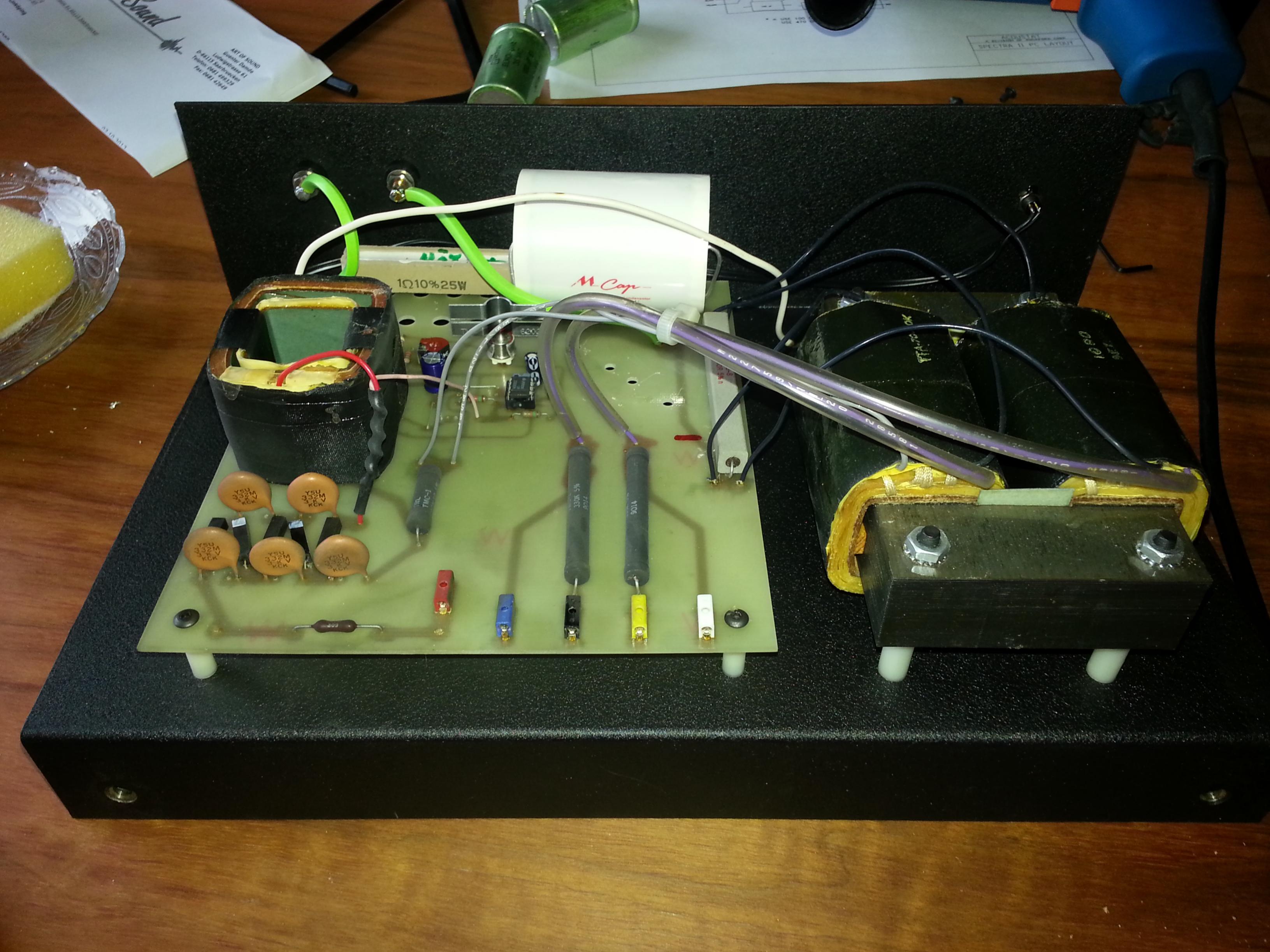

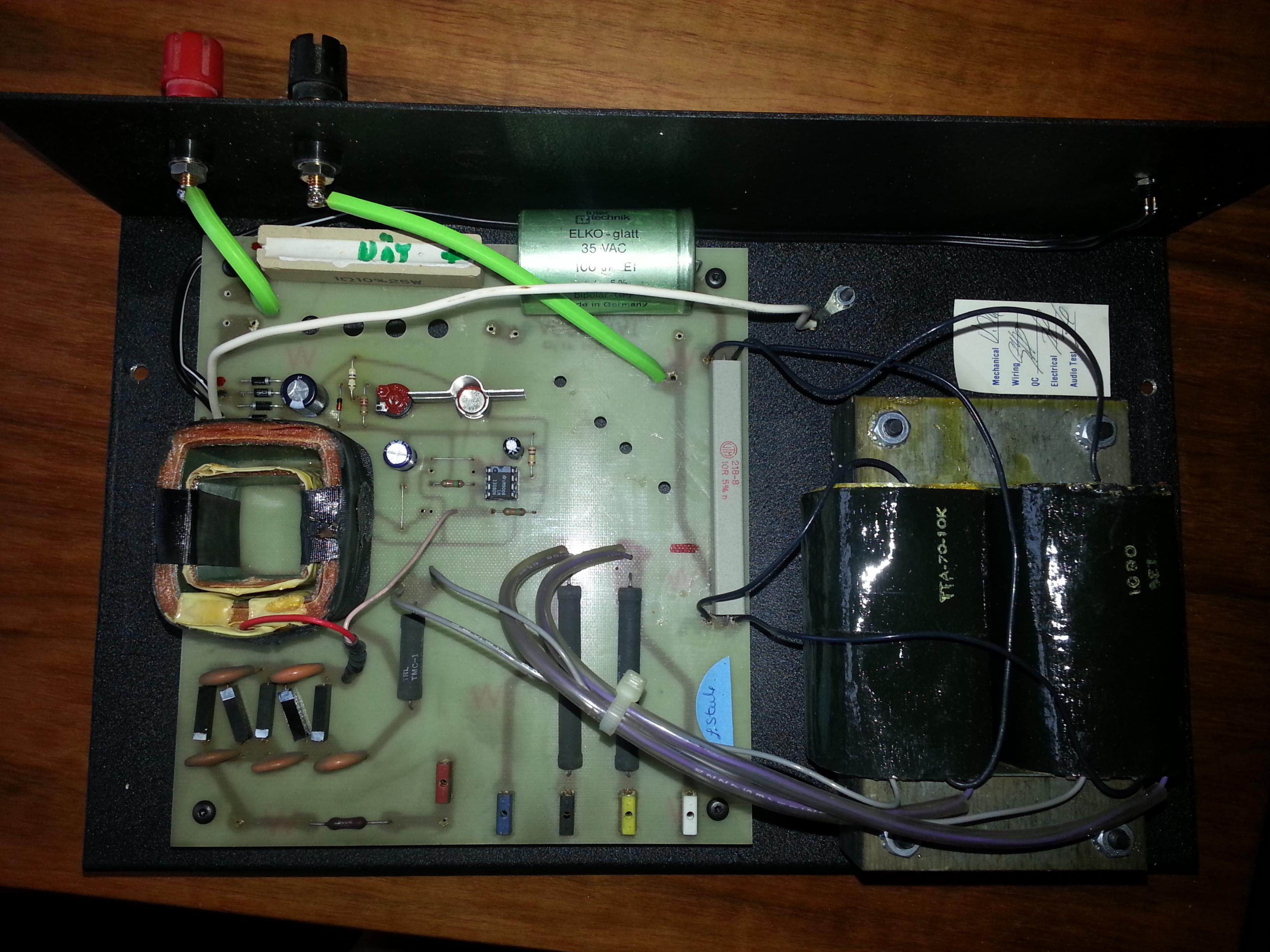

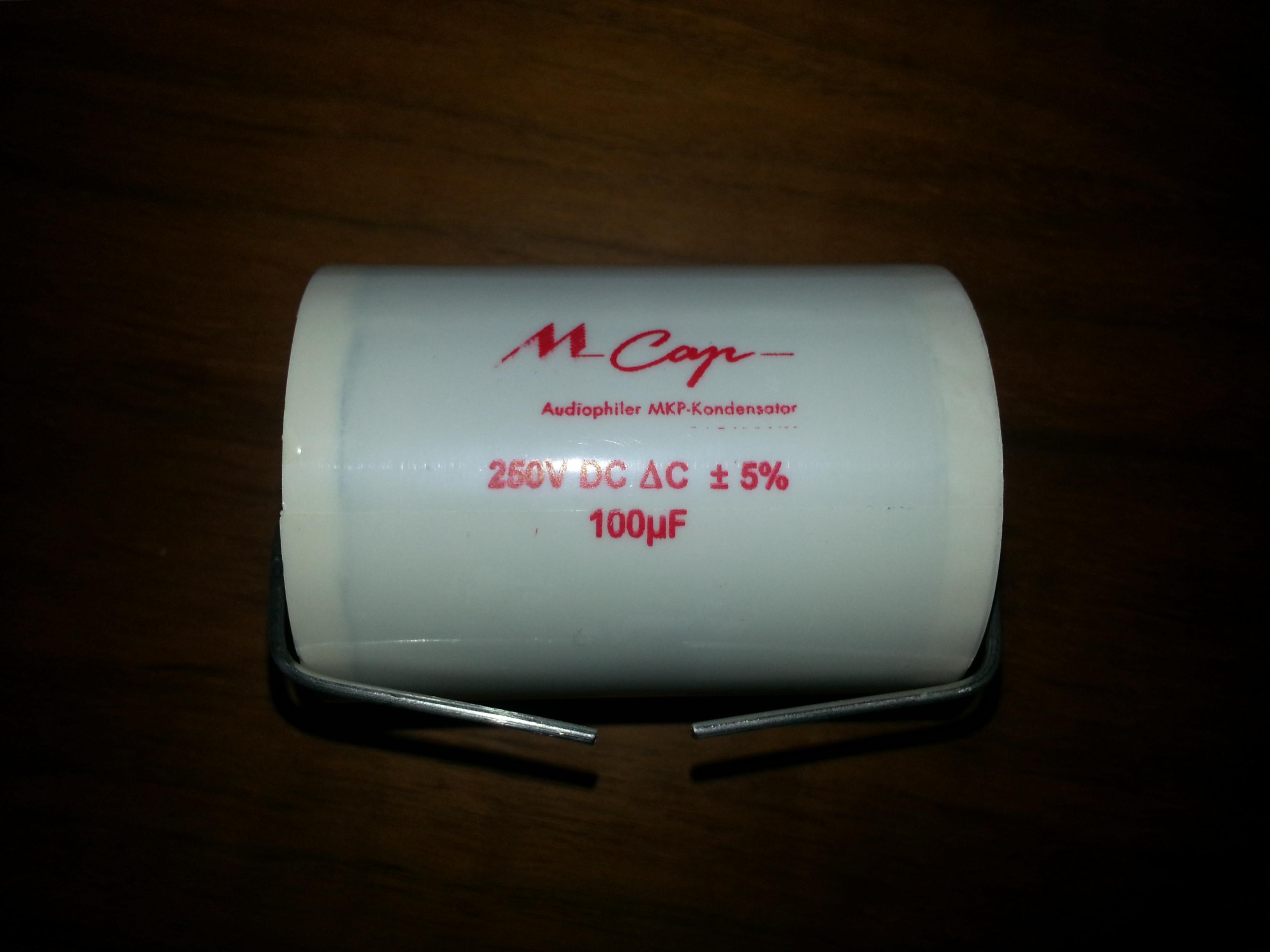

After a bit of experimentation with active crossovers and double panels, I decided to take the easy way out and upgrade my Spectra 11 interfaces with Mundorf MKP caps. Holy crap! 😱 I expected the sound to improve a bit, but this is like listening to a different speaker altogether. The highs are much more extended and have a LOT more detail. I hear new things in all my music, this will be an interesting journey to say the least. These speakers just continue to amaze me 🙂
I attach some before and after pictures of the upgrade. As you can see the interface was already modified (by some other guy), new speaker and power input connections was installed directly on the interface and the low pass filter was removed and placed in the woofer box (I can't understand why Acoustat didn't chose this solution in the first place, it's much cleaner and better sounding).
...(I can't understand why Acoustat didn't chose this solution in the first place, it's much cleaner and better sounding).
That upgrade is pretty popular and well worth the trouble and expense. As to why it was not done by the factory...the answer is the almightly dollar. The Spectra 11 was originally targeted to sell for under $1000, and getting the materials cost to that point didn't allow some of the nicer frills. Even the Spectra 1100, which was an upgraded version of the Spectra 11, did not use fim capacitors. Besides, Acoustat needed to leave something for the DIY'ers to do!

Looks nice. My cap upgrade cost about $85 and I bought the speakers for $375, so $460 for the best sounding speakers I've heard. 🙂
I think I'll upgrade the interfaces of the Spectra 11's I use for rear channels as well.

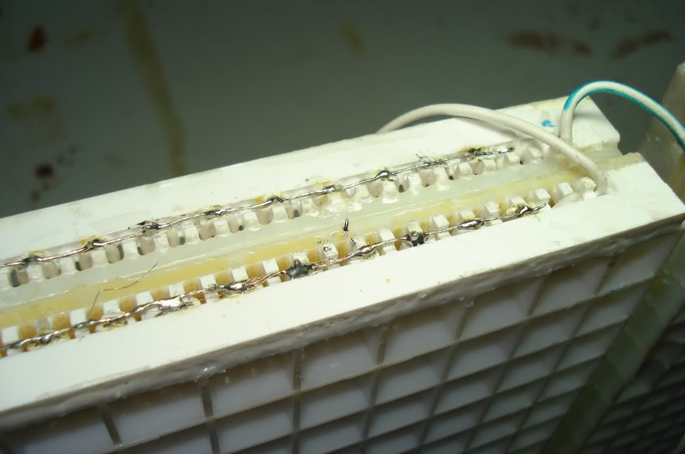

I did this mod to my panels years back.....just be eze...you can divied any of the panels if you wont..eze...Or
Short all wires... top an bottem...front an back
This panel setup give 2db more out put over the one end feed i have found...thanks for the pic i have lost my pic....goodluck

Seems that negates the noise isolation advantage of getting the AC as far from the signal as possible. Also, I don't understand the last picture. What is the advantage in soldering "bridges" over the looped wire?
But what's the reasoning behind putting the "wall wart" inside to box?
