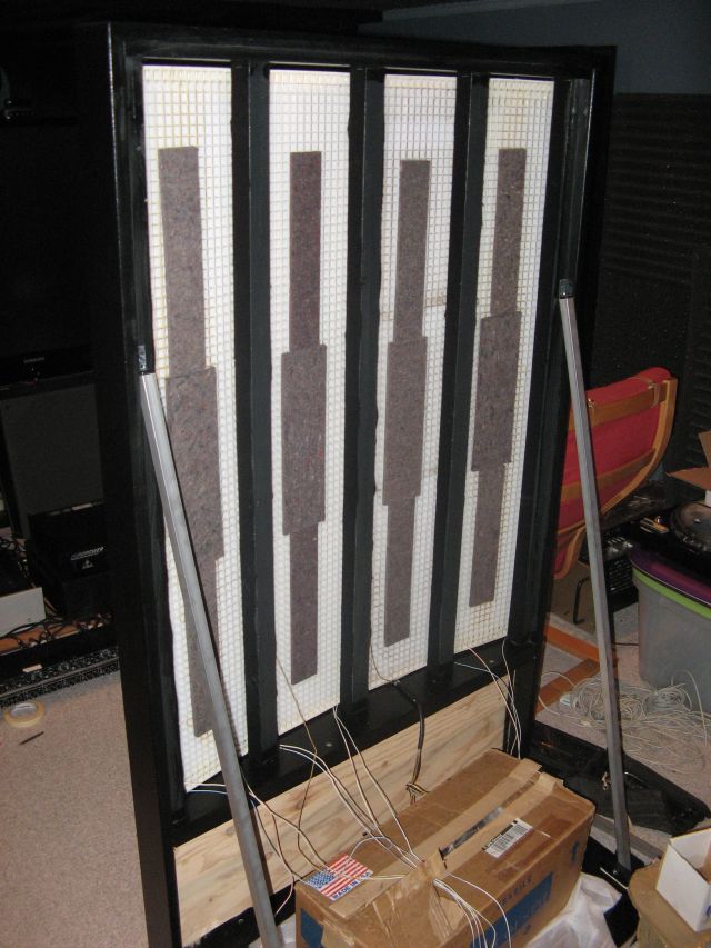

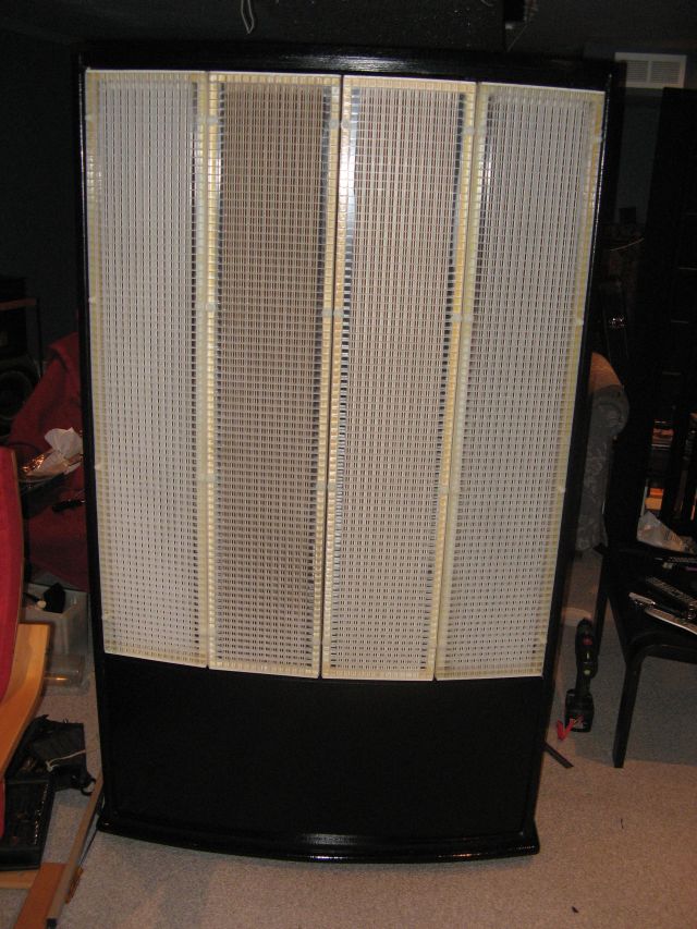

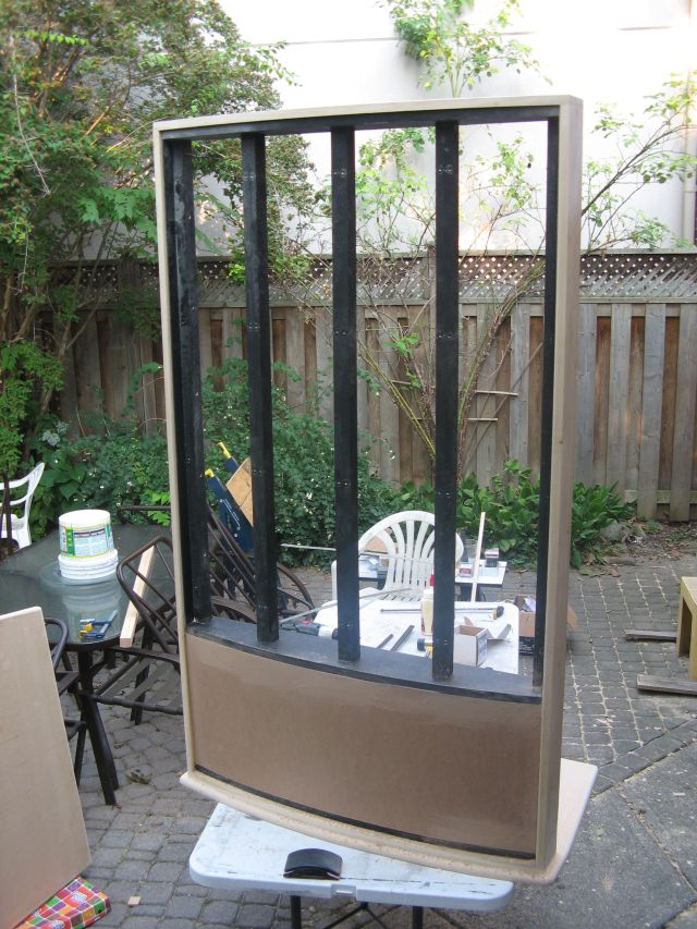

Here is my attempt at a Monitor 4/ Spectra 44. There are 4 x 9" panels at a 6 degree angle. 2 panels are 3 wire and 2 panels are 5 wire .I am going to drive them with a MK121C interface initally. I also have a Spectra MK2123 interface .My question is can I drive the 4 panels with the Spectra 33 tap ,or will there be too much bass?
Andrew
Andrew

Sorry Andrew very nice model 4s but NOT 44s or 4400s because those need to be 22 inches wide by 94 inches high like these next to a pair of model 3s models -2 - 3 - 4 - are all about 66 inches high. André

Ok Andrew did not notice that particular post but one thing i can tell you is that i had a friend like you that could not fit his Acoustat's 2+2s in his basement for the same reason ( height ) he did what you did 4 panels side by side they realy sounded good BUT did not sound like normal 2+2s BUT better than any boxed speaker at the same price 🙂
PS: They do look very nice ENJOY
I agree with you, MrAcoustat, the 1+1s are a wonderful speaker. My next project will be to "Spectra" mine -- to improve horizontal dispersion a little -- and add either a single plane bass array or a double bass array; then I am done! I promise!
QUOTE: Then I am done, I and my wife have heard that statement before 🙂🙂🙂
Nice job, Andy. You're going to end up with a totally unique Acoustat. I'm very curious to hear about how combining the standard and Spectra interfaces turns out. Hopefully after zeroing in on the interface config you WILL be done, but no one here will hold you to your promise. 🙂
