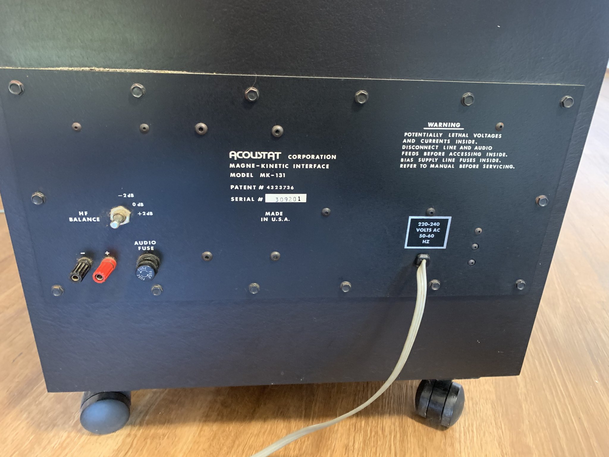

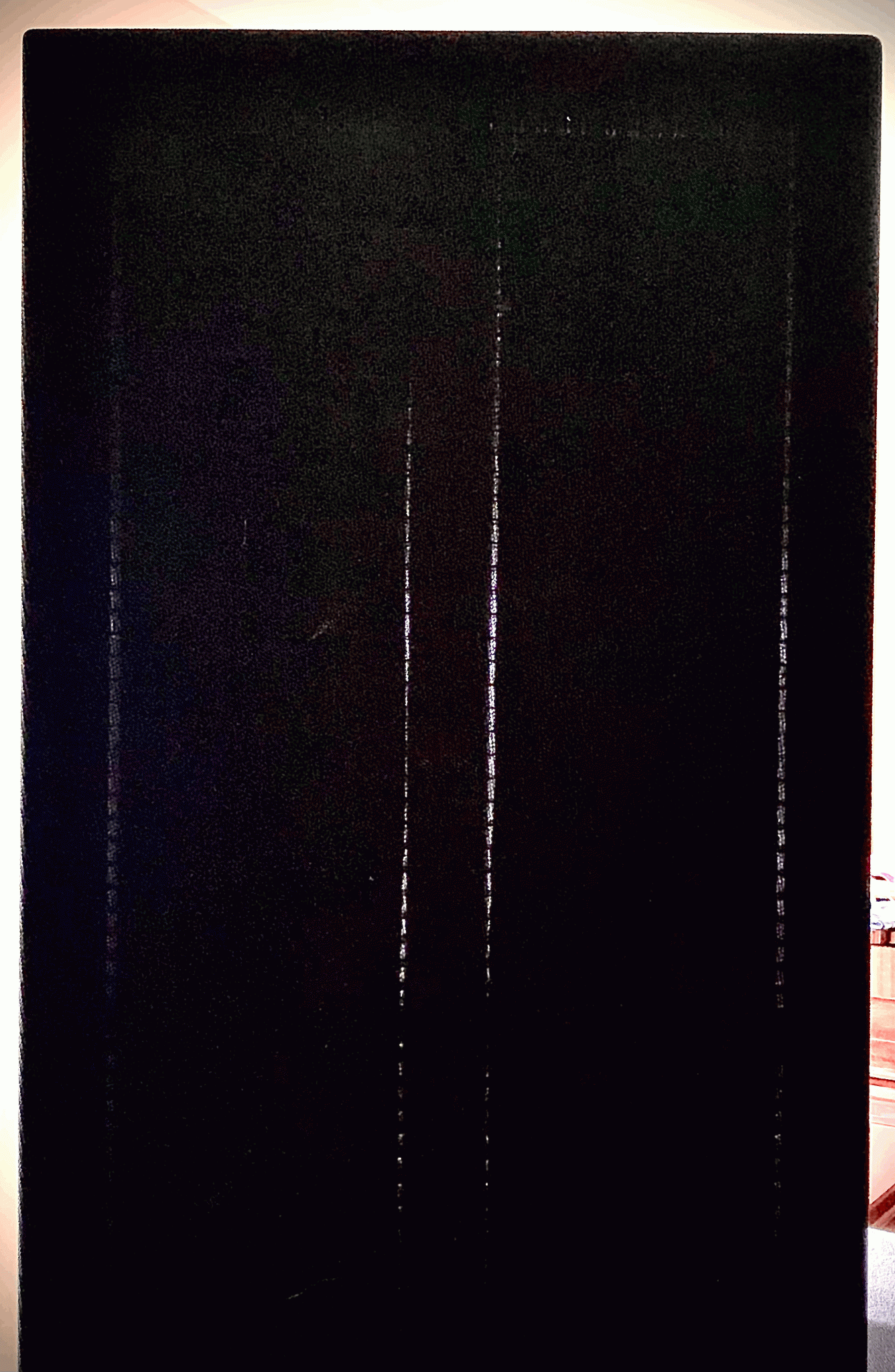

I need any info on the Acoustat MK-131 I have the two flat panel electrostatic speakers,
how old are they and is there a preferred amplifier?
Can I tell the age by the serial number
How do they rate against, say a common home speaker system like a Sony or a Phillips for your stereo...

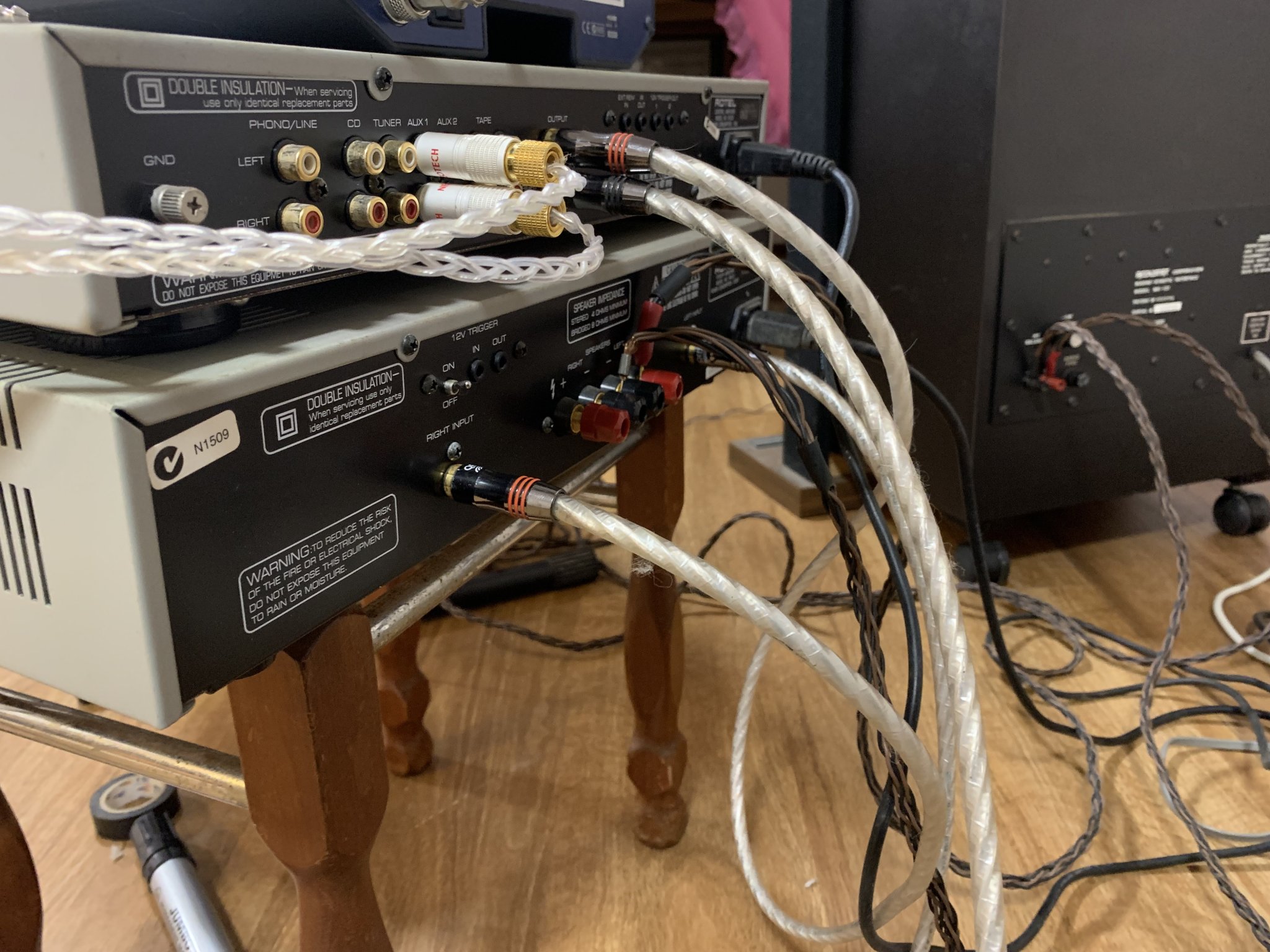

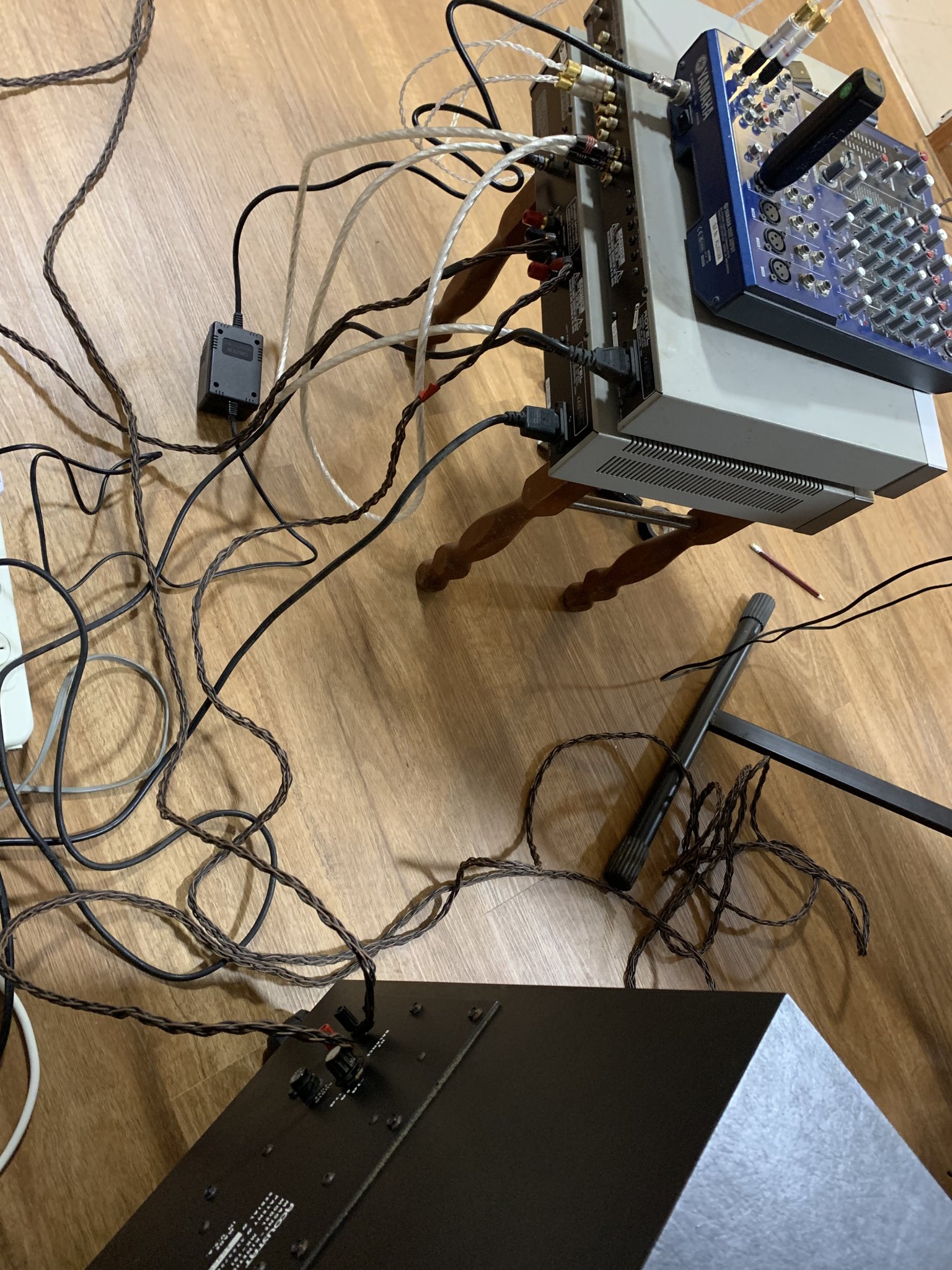

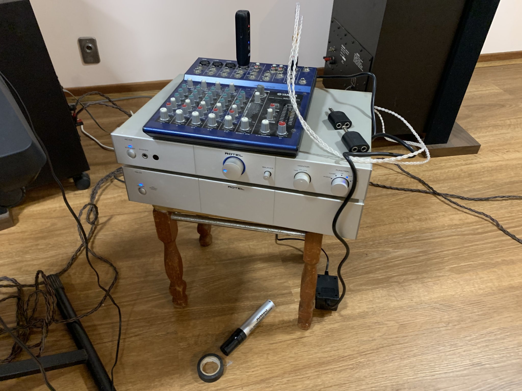

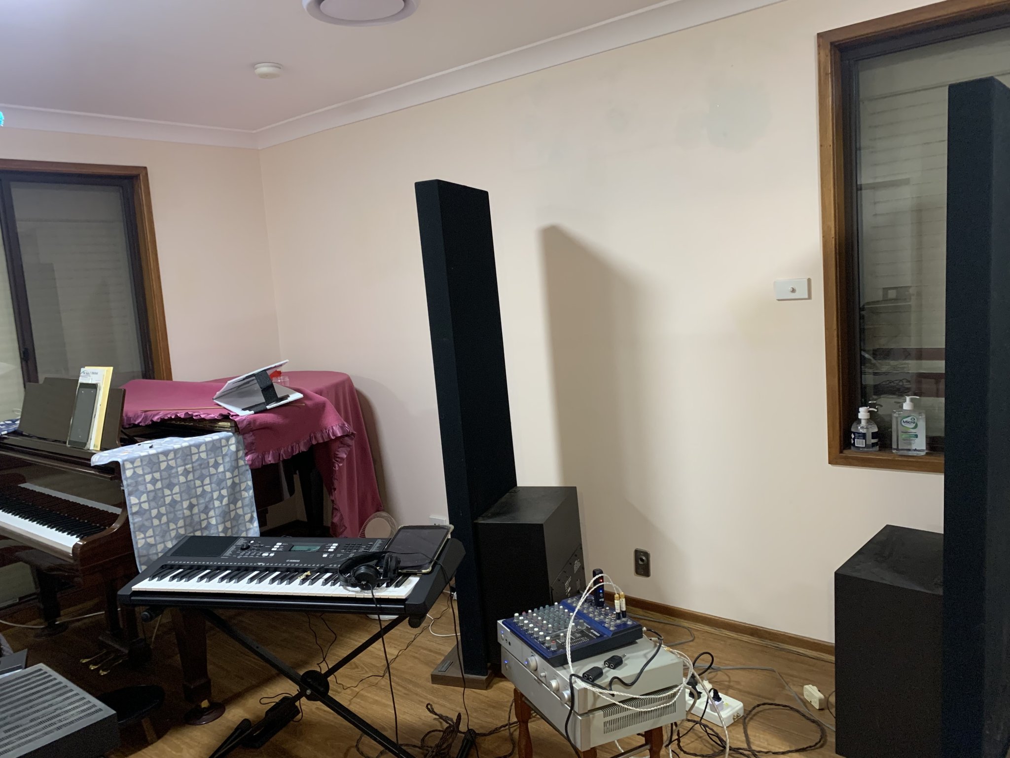

Help if able please
I am a musician in Australia and have a deceased estate that I purchased in the hope I could use it in my music room.
The Acoustat MK131 (powered to 240V Au)
I am getting sound out of the Rotel RB03 headphone Jack
then sending it to the Rotel RB 03
Not sure what I have to do from there, have tried line out from RB 03 then to the Acustat with no result, any help would be greatly appreciated.
So the mixing desk should simply send to the amps then to the Acoustat.

1. If you search this thread you will find answers to almost any Acoustat question.
2. MK131 is the interface number, not the model. Measure the speakers and someone can tell you the model.
3. The Acoustats need to be plugged in. This powers the high voltage bias on the diaphragm. If the sound is weak at a normal volume setting, do NOT crank it.
4. Try a different speaker to make sure you are getting sound to it from the amp.

Very kind, the system is working MK131 is insane! I am feeling blessed and transported into the hall very easily

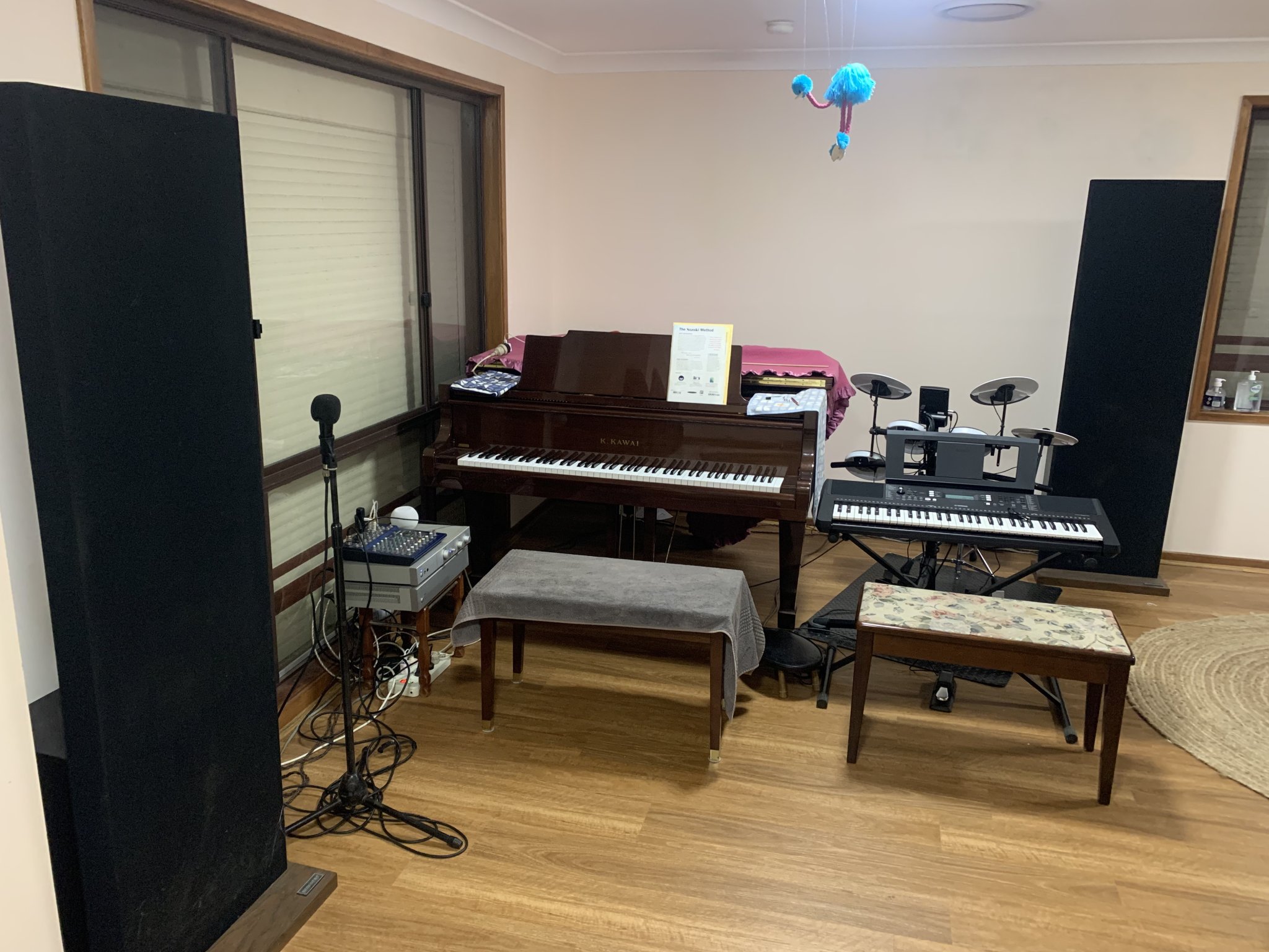

But
do they have to be spaced and facing in the right direction - it seems they have a 'sweet spot'
I am a pianist and rehearse with them.

Raymond,
It appears that you have the Model 2MH. This is a hybrid speaker with a conventional cone-type bass driver facing the floor. I purchased a pair in 1983 or 83. I don't believe they were manufactured long past the mid-1980s, so your pair is likely to be at least 40 years old. Over time the foam surround (suspension around the bass speaker) can disintegrate, so I would check this. It is usually indicated by an audible scraping sound and distorted bass. This can be repaired with a kit but it is tedious. If they still sound ok, perhaps the previous owner already repaired them.
This two-panel design was a compromise to meet a relatively low price point (for Acoustats). It can be "beamy" and has a fairly narrow sweet spot for best listening. However, they can sound very good when positioned correctly. One piece of advice that applies to all Acoustats is to keep them a good distance away from the wall behind them, at least 2 but as much as 4 feet.

Yes, I can confirm the quality is still amazing yet have the sweet spot. You kind of want to put a reclining chair exactly in the right spot and make a triangle to sit at the tip of the triangle.. and when you do... wow! its like going under water... you can almost feel the line as you move in and out of the best point. Which is a bit crazy... do you have an idea of how much they cost back in the day? How much did you purchase for back in 83? I was 19 then and am nearly 60 now 😉 thanks in advance.

Raymond - I am pretty sure your speakers are 2MHs based on their size, the MK-131 interface, and the fact that they have a cabinet with a cone speaker at the bottom.
I recall an original retail price of about $1200 in the U.S. and have no reason to dispute the quoted price of $1295. That would be for a pair. However, the retail price 40 years ago has only a small influence over what the market is willing to pay today. The big issue with reselling Acoustats is their size and weight; shipping is very expensive and cumbersome. I assume that you may have obtained them locally so that's the route I would take (local pickup). Disassembled, the panels (you have 4 total) go for $100-150 each and are far easier to ship. That said, I can't recommend that you dismantle a perfectly good set of Acoustats.
