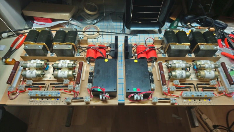

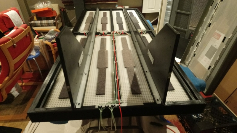

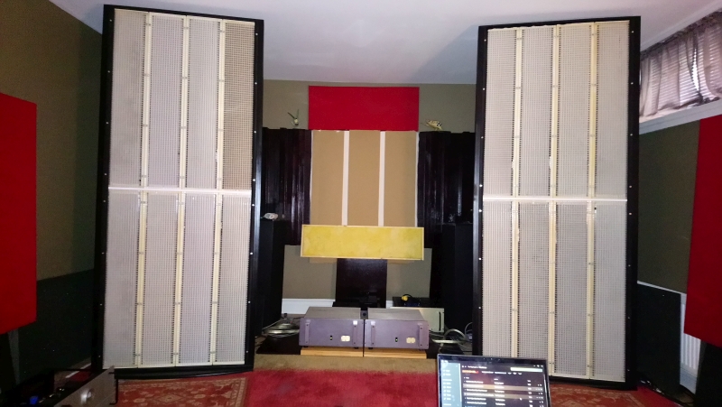

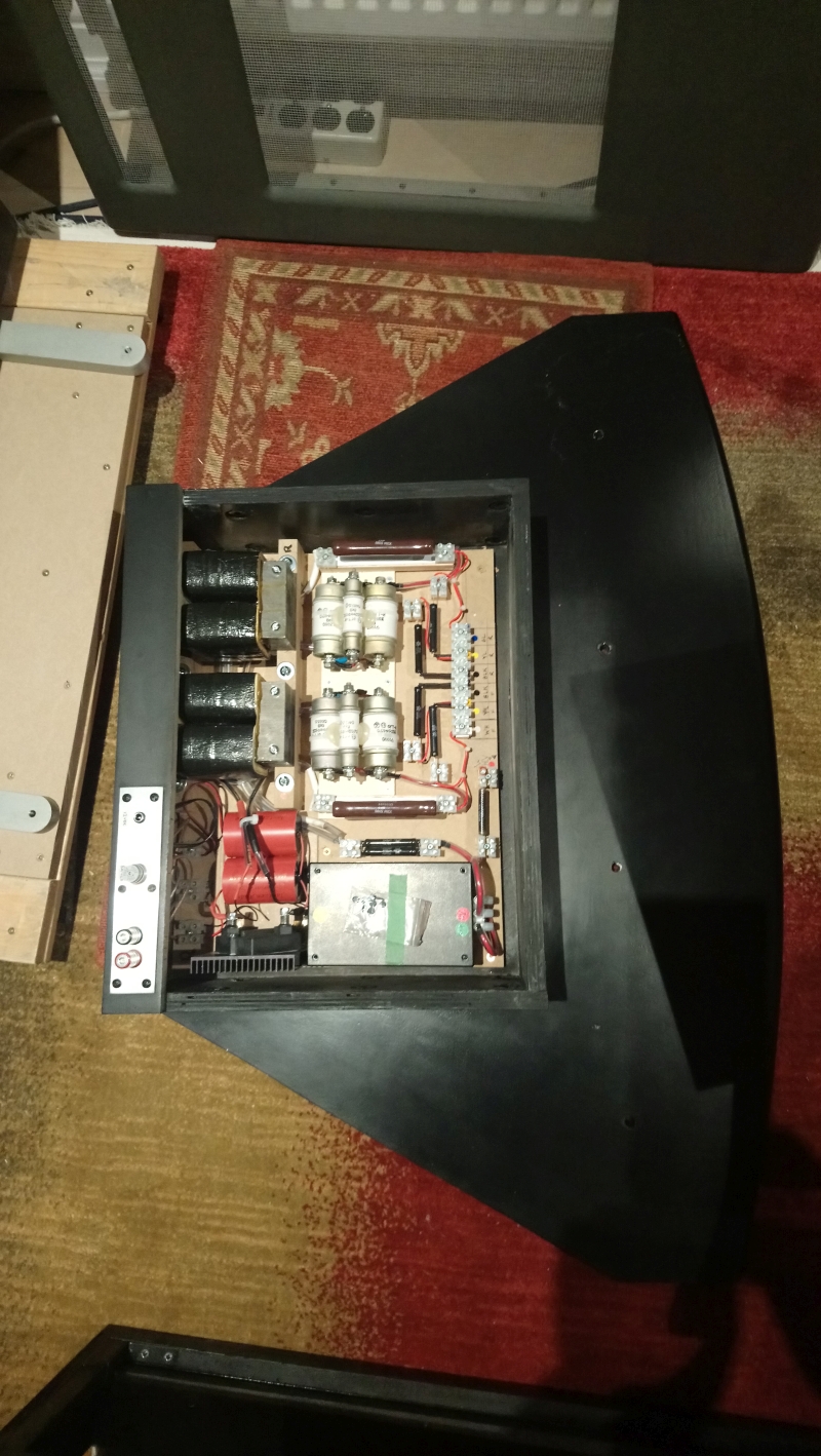

Spectra 8800
Finished these a couple of months ago. I thought they might be bass heavy but find they seem to work fine in my room, maybe because of the bass traps in all four corners. I just need to fix a rattling panel, soon to be taken care of, Thanks Dave!
Andrew
Andrew
Andrew
Wow, that's a lot of Spectra! Nice job! I'm curious if you changed any of the sector resistor values, to compensate for the increased panel area being driven on those segments. I'm presuming the extra column of panels is bass-only, so really only the bass-sector resistor values might change. But if you're happy with the result, leave well-enough alone!
Hi Andy
I didn't change any of the equalization resistors, though I was prepared to do so if required. I thought I would listen to it for a while and so far I've had number of people over and we all seem to agree that the bass is OK as is. I tried to use it with a couple of Contrabass subwoofers but it is better without. Sure can move a lot of air 😉
Andrew
Andrew

Wow Andrew!
Spectra 8s, I’m surprised they don’t overpower your room.
What materials did you use for the frames and how difficult were they to construct? I would like to build new frames for the Spectra 22 I got from you years ago. One of my best audio purchases ever!

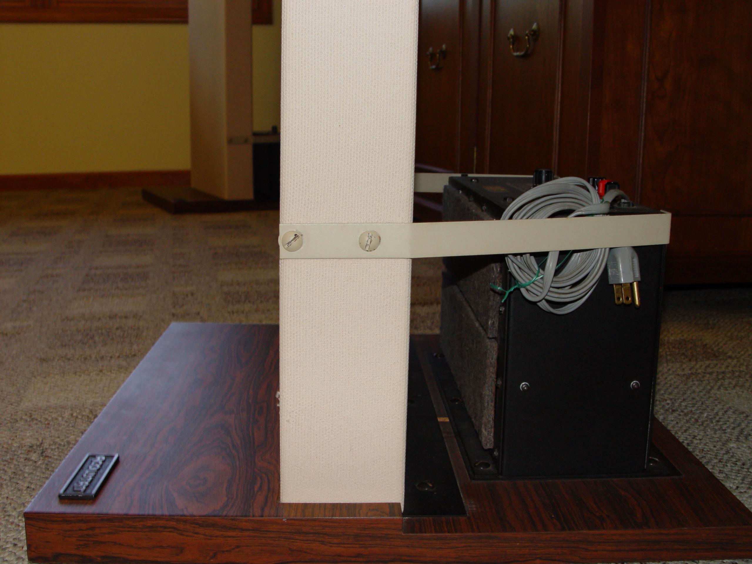

New panels on order, also got a soldering kit and working up courage to challenge the beast again. So here's a question for you pros: There's some hardware on the sides of the 2+2 (see picture) about 9" from the bottom, into which the bolts in the picture screw to brace the unit. This hardware prevents me from rolling the sock halfway up from the bottom and so doubles the work of accessing the two lower panels. Does anybody know if there's an easy way to remove the hardware so I can roll the sock up for more convenient access?

Your photo wouldn't load for me, so not sure what you're looking at. In any case, for any panel work, the two straps must be removed, the interface removed, and the array unbolted from the base. This is clearly a two-person job, so you can support the array after the straps are removed, and then carefully lay the array down flat so you can work on it. All of the hardware should be ordinary bolts or screws.
+1 Working on them is much easier when they are disassembled.
Apparently I goofed up by trying to load my photo from the "Quick Reply" window instead of using the "Post Reply" button. So let me now try again. Here is a picture of the hardware that's frustrating me. I know how to back the bolts out, but the fittings they screw into prevent me from rolling the sock up from the bottom, so I'm wondering if there's an easy way to remove those fittings.
That version of the 2+2 is before my time with Acoustat, but I believe it's just an insert that you can pry-out of the hole after you remove the screw. It's purpose is to make a nice hole through the grille cloth. Perhaps someone with more experience with this vintage 2+2 can chime in here.
Doink! You're correct. Those fittings pull out very easily... and that makes access much better!
