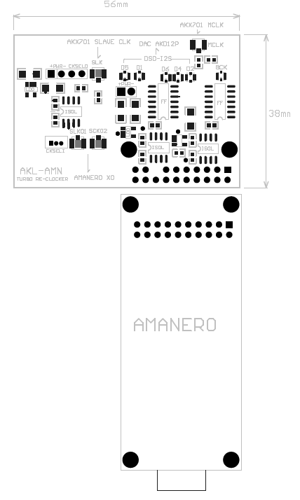

Amanero Isolator and Re-Clocker board
Can you give price and availability?
Looks like it would mate well with my Amanero.
Randy
Amanero Isolator/Turbo Reclocker
BTW, this ALK-AMN is specifically designed for use with the AKD12P DAC and AKX701 Turbo Clock. All Teflon board and high speed parts. General purpose and lower spec/cost version if sufficient interest.
I'd be interested in the "normally aspirated / average joe" version to connect a cm6631 usb-i2s card to an es9018 dac; the ones from Diyinhk.
yeah mate, consider how many people bought that board and struggle with its proper integration daily....
many have lashed together protoboards etc with very fast logic chips. I have no doubt you would sell quite a few if you can make it more inline with the cost of the amanero, they dont need rogers substrate.
I have no doubt you would sell quite a few if you can make it more inline with the cost of the amanero..
