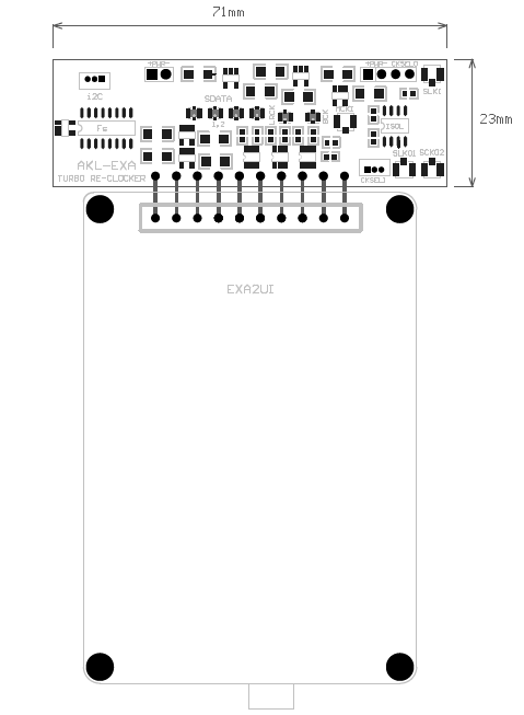

Folks,
This is another attempt to get the EX2UI board to work with the Turbo Clock (AKX701) unit. (In my previous post I highlighted some difficulties)
The EXA unit has a FIFO-buffer + dual clock on a compact board, all great for jitter elimination. However, the I2S output signals go through isolator chips (IL715) and thereby gets slightly degraded (jitter-wise). The reclocker module (AKL series) serves to clean up the I2s signals from the EXA unit. The reclocked + bufffered outputs are on w.fl coax headers to match the DAC module (AKD12P). Pin headers from the AKL connect directly to the EXA2UI output terminal block as shown.
The re-clock Flip-flops are clocked by the same MCLK as that of the DAC (100M). Used this way results in Async Re-Clocking.
I have also added Clock isolator on board so that the divided slave clocks from the AKX701 Clock module can be safely piped into the EX2UI for Sychronous Re-Clocking. As the reclock MCLK freq is much higher (100M) than the transport clocks (25M), I am hoping that this 'Turbo' reclocking technique will be able handle higher sample rates without problems.
Also added on board is a Sample Rate DAQ and transmitter (I2C comms). The MCU can read Fs direct from the transport and display accordingly.
Shown is 2CH version. 8CH with AKD18 DAC, similarly.
Other tranports can similarly benefit from this arrangment and I will be rolling these out soon.

Asynchronous re-clocking...
There was a discussion precisely on this method of reclocking over at my blog a few days ago. I concluded that because the clock speed is much higher than the sample rate, the reclocking is always bit-perfect.
However, the width of the pulses (eg bitclock) will be changing, modulated by the 100MHz clock. What are your thoughts on this?

Async Re-Clocking
Thanks GLT, very interesting convergence of ideas from different parties 🙂
You have also nailed it nicely in your blog that I only vaguely managed to imagine! Again the scope of my plan is Sync Re-Clocking really with the AKX701 that is easy to frame and analyse the timing. It then became obvious if a simple DAC MLCK is used and no transport interaction then it defaults to ASync Re-Clocking. ASync re-clocking has been used since the beginning of times e.g. Typical Application
I haven't analysed the detailed timing but would assume at 100MHz reclock on say, 500KHz Fs bitclock would not cause problems even if not synchronised. Also, if it has worked for the above implementation then we are assured?
BTW, all lines BCK, LRCK and SDA are re-clocked for my version.
Any further thoughts most welcome

...ASync re-clocking has been used since the beginning of times e.g. Typical Application
You are right! This stuff is ancient. Thanks for the link...
exa065 said on his post in exaDevices thread,
http://www.diyaudio.com/forums/exadevices/183374-exau2i-multi-channel-asynchronous-usb-i2s-interface-125.html#post3237290
... Note to the exaU2I users with ES9018 DACs - don't bother removing the GMRs - in your case removing the GMRs won't make any difference. ES9018 takes care of the GMR jitter, and replacing the GMR isolation with optical isolation will not present a rational improvement. ...
How do you feel about his notice?
Thanks for the feedback
Yes, the EXA sound great of its own with this DAC but we need to test this case or see if further improvements can be made (Async mode). This idea is to reduce or eliminate jitter altogether before reaching the DAC so that the DAC does the final clean up to make it sound even better.
It will be fairly easy to do A/B comparison with my own DAC. There is no re-clocker circuit on the DAC board itself so we can insert an external re-clocker board (like the AKL module) between the DAC and the EXA unit. No mods
