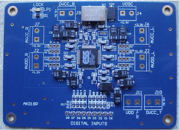

Hi Guys,
Thanks for all your valuable posts. I am travelling at the moment so just based on memory for the time being, I will try to clarify in stages:
The AKD12 (9012) is dedicated for 1-2CH only and the AKD18(9018) has all the 8CH outputs on separate output lines for multi-channel audio. There are no switches or jumpers for either version as I wanted to keep the trackwork simple and direct from input to output. You can combine the AKD18 outputs off-board from 1 to 8CH. The inputs for both version are identical, i.e they all go into 8 separate DACs within the chip.
Both 9012 and 9018 chips have built-in spdif receiver with 8CH Mux so no external receiver (like CS8416) is needed.
The respective DAC controllers (AKC12 and AKC18) are configured physically for the intended applications. The AKC12 for 2CH stereo from I2S/DSD and spdif (up to 8Ch selectable). The AKC18 for multi-channel I2S/DSD sources. Spdif can also applied to the AKD18 inputs but the controller (AKC18) has no channel selector on board, so spdif will default to CH1 (on D1 input). Both controllers have built-in functions for their respective application to make it easier to issue commands and also register level command functions for those who wish to have more control.
The Channel mapping for
PCM(I2S) is:
BCK -> CK
LRCK -> D1
DATA - CH Output
D2 - CH1, CH2
D3 - CH3, CH4
D4 - CH5, CH6
D5 - CH7, CH8
For the AKD12 (9012) D2,D2,D4 and D5 must be connected together (externally) to the I2S DATA line of transport. CH1,CH3.CH5 and CH7 are combined on-board for LEFT channel and CH2,CH4, CH6, CH8 for the RIGHT Channel.
For the AKD18 (9018) D2,D2,D4 and D5 are connected to the respective channel DATA lines of transport. For an 8CH system they all come out as above.
You can also combine the outputs (off-board) to suit:
e.g, for 4 CH 'Stereo' combine CH1,CH3 for Front LEFT, CH5,CH7 for Rear LEFT, CH2,CH4 for Front RIGHT and CH6.CH8 for Rear RIGHT. The corresponding inputs also need to be connected together (D2,D3) and (D4,D5) to DATA lines
If you wish to connect Spdif also then you are left with 3 input Channels only: D6,D7 and D8 and selection by the AKC12 channel selector. There is no physical channel selector on AKC18 so you need to issue I2C commands to the MUX register if the DAC chip and then SAVE it to set it this way always.
I haven't really tested this but I would agree with GLT that you can switch/select between i2S and spdif as configured above.
