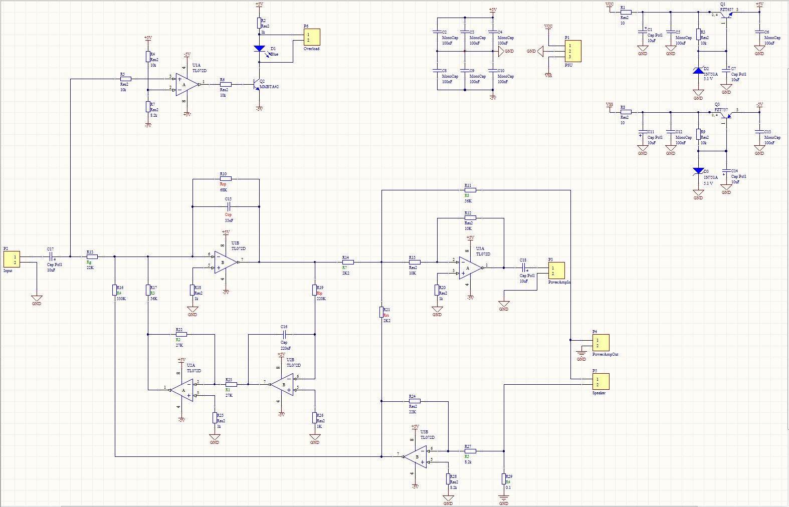

ACE-bass amplifier design
U8 could be left away IMO (741s are not considered that sexy anymore nowadays - neiter are 748s).
The bias resistor should be the same as the DC resistance to ground that the inverzting input "sees". I.e. it should be about 1.5 and 1.8 k (difficult to determine exactly because of P2).
Regards
Charles
Ok thanks Charles for your reply, I've removed U8.
Can I use a standard NE5532 (like U5 + U6) for U7? Since they are internally freq. compensated I won't need C25. (I know that there are better options for audio, but I have them in stock)
Wouldn't it be easier to power U7 from the same regulated +-15V PSU as U5 + U6 + Filters. Actually I can't find a reason why to power it from the Amp's powersupply, since I put everything on the same PCB.

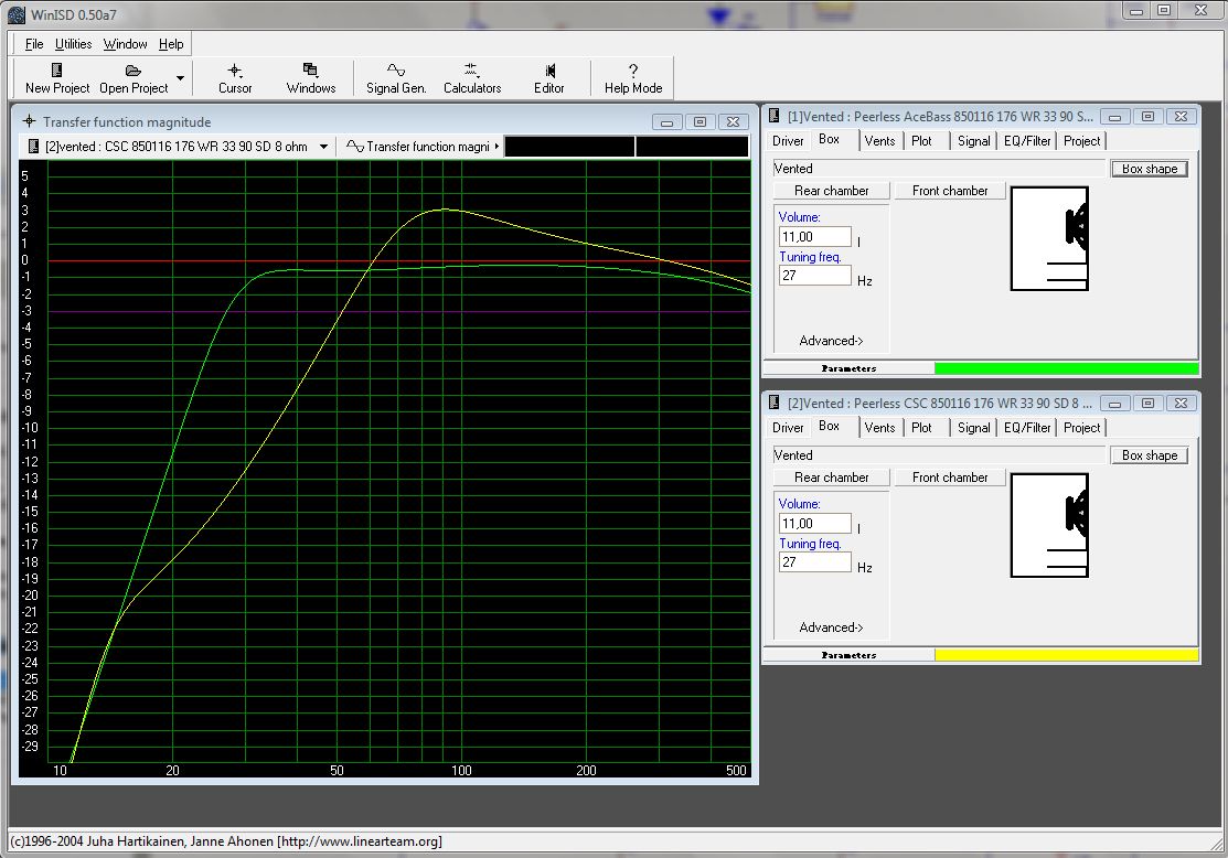

Strange things happening here. I've been doing some simulations with WinISD and a spreadsheet from www.diysubwoofers.org they both say that the design I made should be right....
In the response graph below you see:
- Blue line: Fs 16,8 Hz
Qts 0,33
Vb 47 ltr
Portlength 35 cm, dia 4,7 cm
- Red line: Fs 20Hz
Qts 0,33
Vb 38,7 ltr
Port length 30cm, dia 4,7cm
- Green line: Fs 16,8 Hz
Qts 0,33
Vb 47 ltr
Portlength 35 cm, dia 10 cm
The only reason I can think of is that you didn't choose the same portdiameter (4,7 cm) as I did. When taking 10 cm I get the same response as in your graph with -3db of around 35Hz and a large peak. What pipe dimensions and enclosure volume did you use for the simulation?
I think I will go for your suggestion (red line). It looks better than my suggestion. I thought that a lower tuning gives better group delay, am I right?
About Basta;
I see that you can only pay by creditcard, which I don't have...are there other options?
But most of the changed parameters can be simulated with for example WinISD, except for the effect of Le, right?. Very nice software though.
Ah, silly me, I just found an error I did. Rather embarrasing, actually, my port length was 35 mm, not cm... Sorry about that.
Anyway, here is how it looks when the port is tuned to 16.8 Hz (length 350 mm). It can be seen that the virtual parameters simulation matches your simulation very well, but that the full ACE simulation with Le results in a resonance at near 200 Hz. The resonance can be kept under control by a conjugate link.
Regards
Charles
Agree that U8 probably could be removed, but if so also R29 should be removed or C28 doubled. And yes, 741 and 748 should probably be replaced by a more modern OP amp, even though it will not matter much for these low frequencies.

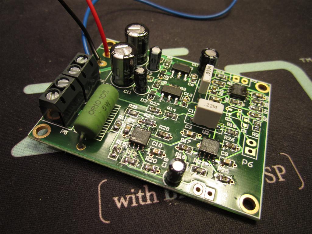

So I populated the PCB for my AceBass circuit whic has been in my drawer for some time.
.... and it actually works like a charm 😀
I used my small 6.5" Peerless woofer (which I use for my PC as sub) just for the initial trails:
Parameters before:
Cms = 1.0166
Mms = 18.5
Rms = 1.5239
Fs = 36.7
Qts = 0.59
Vas = 28.5
With AceBass:
Cms = 0,6
Mms = 80
Rms = 30
Fs = 23.0
Qts = 0.32
Vas = 16.8

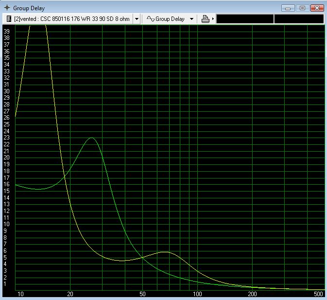

I have attached the schematic used, data in WinISD (AseBass in green) for transfer function and group dealy.
I have made a small Excel sheet for calculations which I'll upload to my blog if anyone are interested (600kb)
It's really fun to hear how deep this small speaker now goes 😉

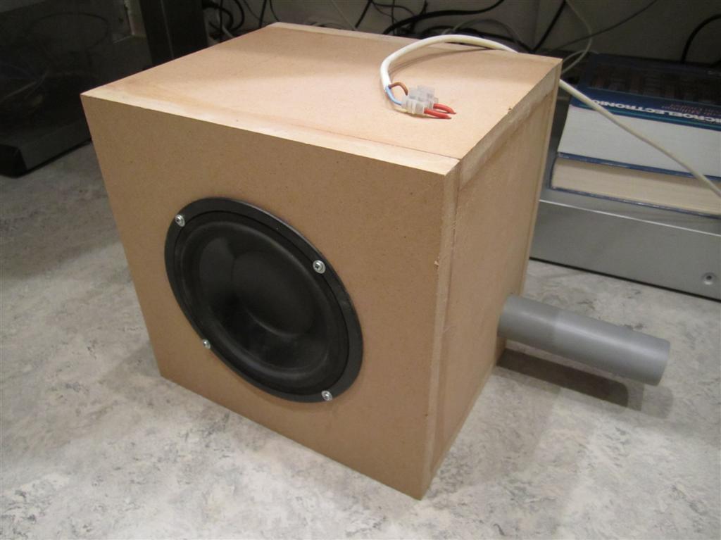

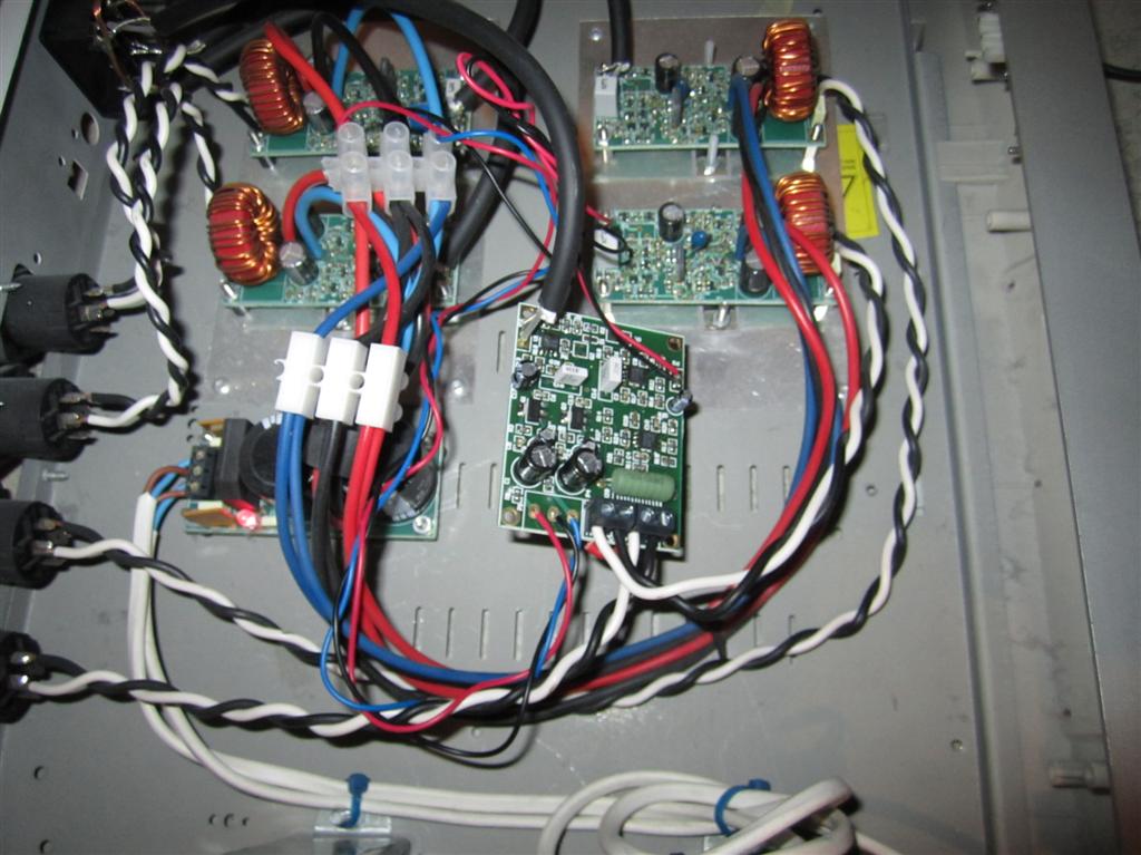

Here are a few pictures:
Read more on my blog, and download schematic and calculation sheet:
AceBass up and running | Baldin's Blog
I made a small PCB for the circuit, but it is easily made up on a bit of breadboard.
I would love to hear if someone fries it out .....
Best regards Baldin

however the difference between the unassisted driver and the ace bass response is essentially the amount of additional power required from the amp which in this example appears to be about 6 dB @ 20Hz and 12 dB @ 30Hz and 7 db @ 40Hz so it's easy to see how you could run out of amplifier power.
