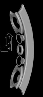

I also had an idea of this rather large 4-way configuration. Separated woofercolums with WMTMW mains (see attachment), mids in totally open environment (just circles in the air) and upper bass drivers in their small baffles. It just gets way too large and complicated. Height is also a problem, very tough to get such system physically stable while kids are around...
Jussi
Jussi
A bit shame how narrow band that midrange would be. In fully open dipole structure 7" drivers performance is limited to 300-400Hz at bottom end because lack of efficiency and they just can't play that much over 2Khz at the top. At least many metal cone drivers like W18EX would be almost a waste driving 350-2K or so.
Unfortunately there are not so many good midrange drivers around. Most manufacturers are concentrated to midwoofer production, AT and Excels just as examples.
In dipole cone should be at least that 7", perhaps even more. Smaller driver has lower sensitivity and with smaller cone dipole cancellation and EQ requirements are even greater.
Jussi
Jussi
Jussi said:A bit shame how narrow band that midrange would be. In fully open dipole structure 7" drivers performance is limited to 300-400Hz at bottom end because lack of efficiency and they just can't play that much over 2Khz at the top. At least many metal cone drivers like W18EX would be almost a waste driving 350-2K or so.
Jussi

Basically I'm not so comfortable to drop this WWMT full dipole plan away from my near future constructions. I have used pretty considerable amount of time to draw that damn thing and it has rather many small details that suit my present perversions. No need to dress them as features since I can't proove their strengths.
Overally plan is pretty ready. I have those Scan Speak woofers for upperbass duty, I like to hammer my head against the wall while trying to get subwoofer integrated and operational and I guess those Dynaudio tweeters I have could serve treble.
But midrange is a problem. Custom AT Flex unit can have 94dB efficiency with 4 ohm coil and +-3mm overhung motor. Further more they could deliver mids with very low loss suspension which combined with strong motor suits my vision of precise midrange. With some potential flipsides of cource.
Naturally I could use acoustic resistance with the midrange but 7" mid in AR cabinet can easily extend downt to 200Hz which makes 25W woofers unadequate for their task. I could use heavier woofers and that changes the whole construction.
Ideas?
Jussi
Ideas?

Pasi,
To this transient lacking is pretty difficult issue. It can be caused by the room while dipole rear radiation gets its bounce from frontwall. But I guess in that case all dipole systems have similar problems at some frequency where they behave as real dipoles. And if they don't have sharp trancient attack does it make it less accurate? How much gutt effect normal trancients in live music have? And which one is more correct, does dipole have some impulse response problems like we this issue handeled or is dipole just more cabinet resonance free and that way less punchy?
And for example with 7" midrange there are no real need to produce whole midrange with dipolar radiation. Adding some damping material behind the mid I guess it's avoidable to collide to these problems. So radiation pattern would change from dipole to dipoles front radiation only over certain frequencyrange. With 7" mid this would be approximately 1200Hz to mid-treble crossover frequency. The point where midrange cone takes over direcitivity from dipole behavior I don't see that much use for that rear radiation so it can be damped off the equation. This should also even and smooth energy response as well since transition from dipolar mid to cardioid tweeter isn't so sudden.
One issue is also bass. 25W pair can't play that much deep bass. It drops off about 6dB or 50% from Orion and Gradient Revolutions mean SPL capability. So at least those would need a subwoofer below 40-60Hz or so.
That WMTMW also crossed my mind but like mensioned, I didn't got those potential physical stability issues solved and it would also be very low WAF construction so I think I'll pass that. Shame, would have some very intresting aspects where for example our fellow DIY builder is digging into right now.
