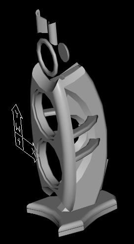

I've also been considering a WWMT dipole/cardioid system. I have four 25W/8565-01 Scan Speaks and while they don't that well deep bass in dipole they might be good in upperbass-low mid area. In this app I thought of those custom Flex drivers 300-3000Hz or so. I'll attach here one of the final scetches of this idea. Midrange could be in totally open space there like drawn or use resistance cabinet. Overall appearance would support ribbon as a tweeter but I don't know any reasonably prices HQ ribbon for the task. Naturally this can be replaced with Esotar in the top.
This solution has some very deeply considered technical details in the baffle and overall structure. I've spend pretty considerable amount of time thinking this thing through.
Naturally that kind of system needs at least a subwoofer to assist below 40-60Hz. 25W can propably handle 40-60Hz up to 250-350Hz, midrange (for example custom Flex) 250-350Hz up to 2500-3500Hz and some tweeter up there to finish.
What do you think?

Joined 2003
Jussi,
That is truly inspired styling...all I can say is WOW!
I imagine construction would make a very big mess in your workshop!
Paul
Paul
Paul,
I have a friend in local carpentershop with CNC goodies. But still I had to find out what he can do and what he can't and then hit my ideas to paper.
Personally I don't know does that look exceptionally good with all its exotics or is it just exceptionally ugly. Still balancing between... 😉
Tried to pack some crazy electro-acoustic visions with slightly different overall appearance. Unfortunately I don't have the means to prototype all this and many things have to be made guessing but hopefully I can analyze the final product detailed enough and see if I achieved at least some of the ideas I searched for.

Jussi said:I've also been considering a WWMT dipole/cardioid system. I have four 25W/8565-01 Scan Speaks and while they don't that well deep bass in dipole they might be good in upperbass-low mid area. In this app I thought of those custom Flex drivers 300-3000Hz or so. I'll attach here one of the final scetches of this idea. Midrange could be in totally open space there like drawn or use resistance cabinet. Overall appearance would support ribbon as a tweeter but I don't know any reasonably prices HQ ribbon for the task. Naturally this can be replaced with Esotar in the top.
What do you think?
I've been doubting this design while I need a high efficiency midrange for that single driver full open dipole midrange and my primary choises like Excels just don't have the sensitivity for it. PHL and some other PA brands have a few but still I don't want to make compromisses with the quality. AT 5" cone Flex is the strongest here but I still don't know that much about them.. Should I take the chance.. Expensive misfire at least if they don't perform well.
Jussi
Looks real good!
I think that limiting the output of the mid (electrically or acoustically) is a good idea, and 250 Hz is certainly better than 150 or less. (..to me its not an issue with distortion.. but rather excursion vs. that of the tweeter.. if they don't "stroke" relativly the same distance during normal use then timing/intellegibility sounds "off" when spl's are increased. In fact this is the reason I generally prefer 1st order crossover - not because of phase, but because they have more excursion which usually mimicks the behaviour/stroke of the midrange.)
Before creating the mid's "shell" I'd try it with a mock-up vs. the dipole pole configuration.. This isn't a concern with radiation/directivity, but rather with acoustic resistance near the driver which tends to "suck the life out of the driver" (..as many others have said). I think Martin King said he was looking into this.. trying to discover the reasons related to the detriment in sound (..no doubt something to do with slow release stored energy). Of couse If your not using "stuffing" near the driver then it probably isn't as much of a concern.
40 Hz sounds like a good cut-off to me for the midbass section, but considering the amount of loss due to dipole configuration you'll likely need more than 25 watts for compensation with headroom.

So you think I should ditch my MTM idea and go for this futuristic monument?

Monument (yea or nea).. thats up to you, I will say that I think it offers much more potential IF the midrange is a dipole (with an appropriate bandpass and eq. - active of course).
