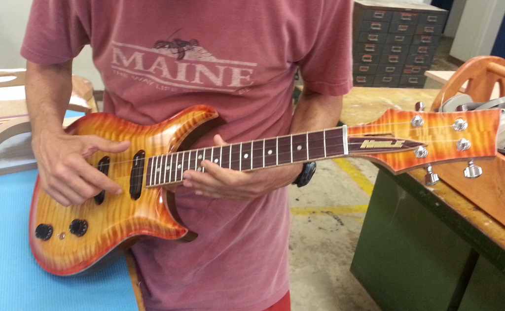

I have made a few guitars, so have some of my friends. I use pre made fretboards or pre made necks, others use a pre made fret slot cutting jig. Both solve the error problem easily.
Electric Guitar Bodies + Necks + Wood | stewmac.com
My guitar used a "Fender authorized replacement neck" from Ebay. My friend made his neck for his electric uke using a jig he made from a pre made fretboard. He made the jig, since he was making several ukes.
He used exotic hardwoods for the uke, I used Home Depot pine for the guitar.

No that may not be you. I thought they were both taken on same day!
No, it's not me. That uke didn't get painted in an instant.....it took several weeks. These pictures were taken in a very dirty high school wood shop that hasn't been used by high school students in several years. Nobody wore good clothes to that place. There was no AC or heat either. The school let us use the shop for an evening class, taught by a teacher from another school in our neighborhood that closed its evening classes because of the crime.
