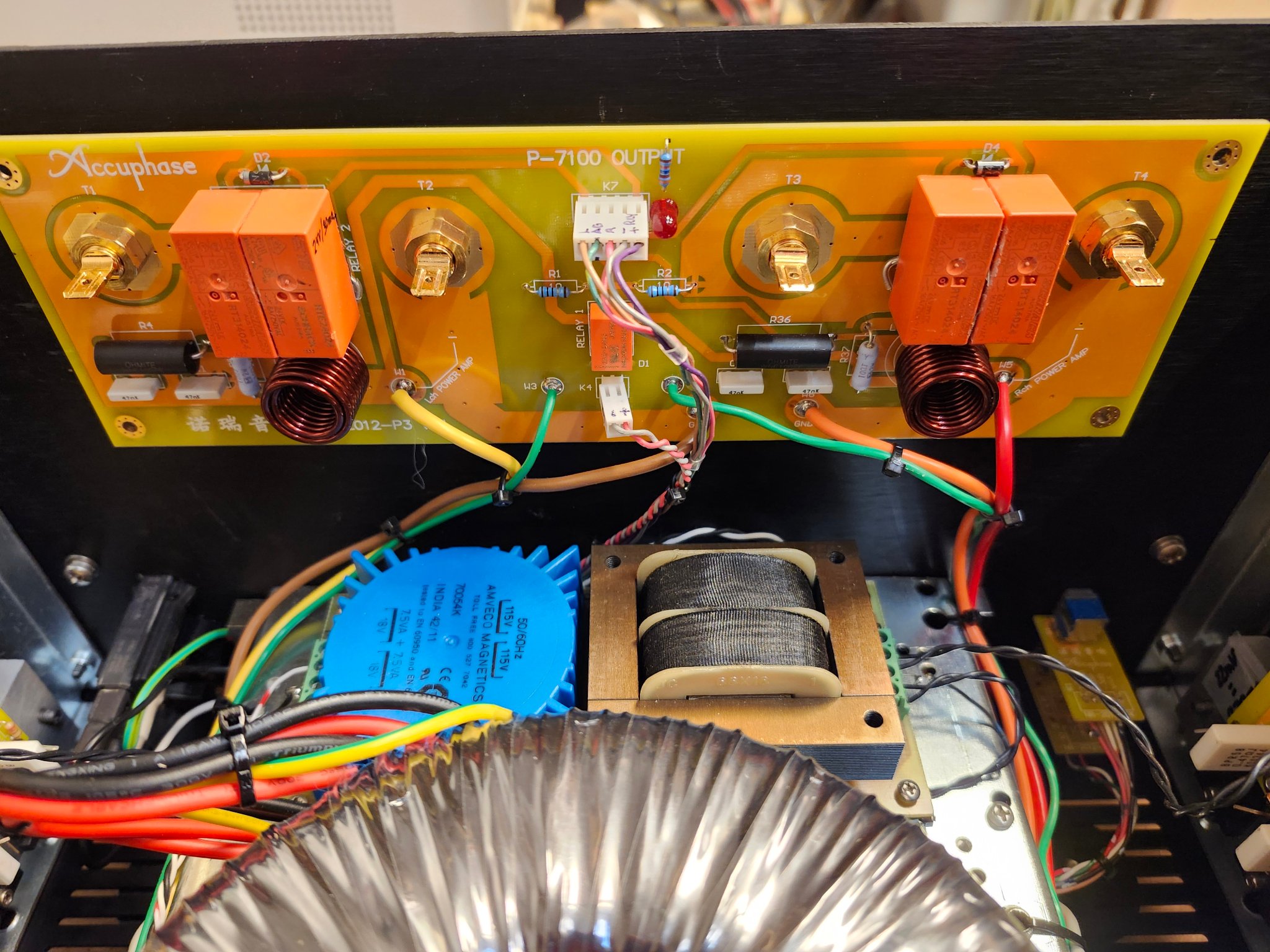

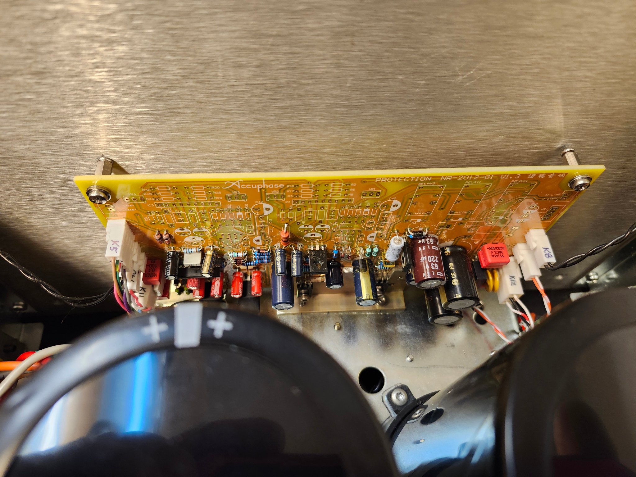

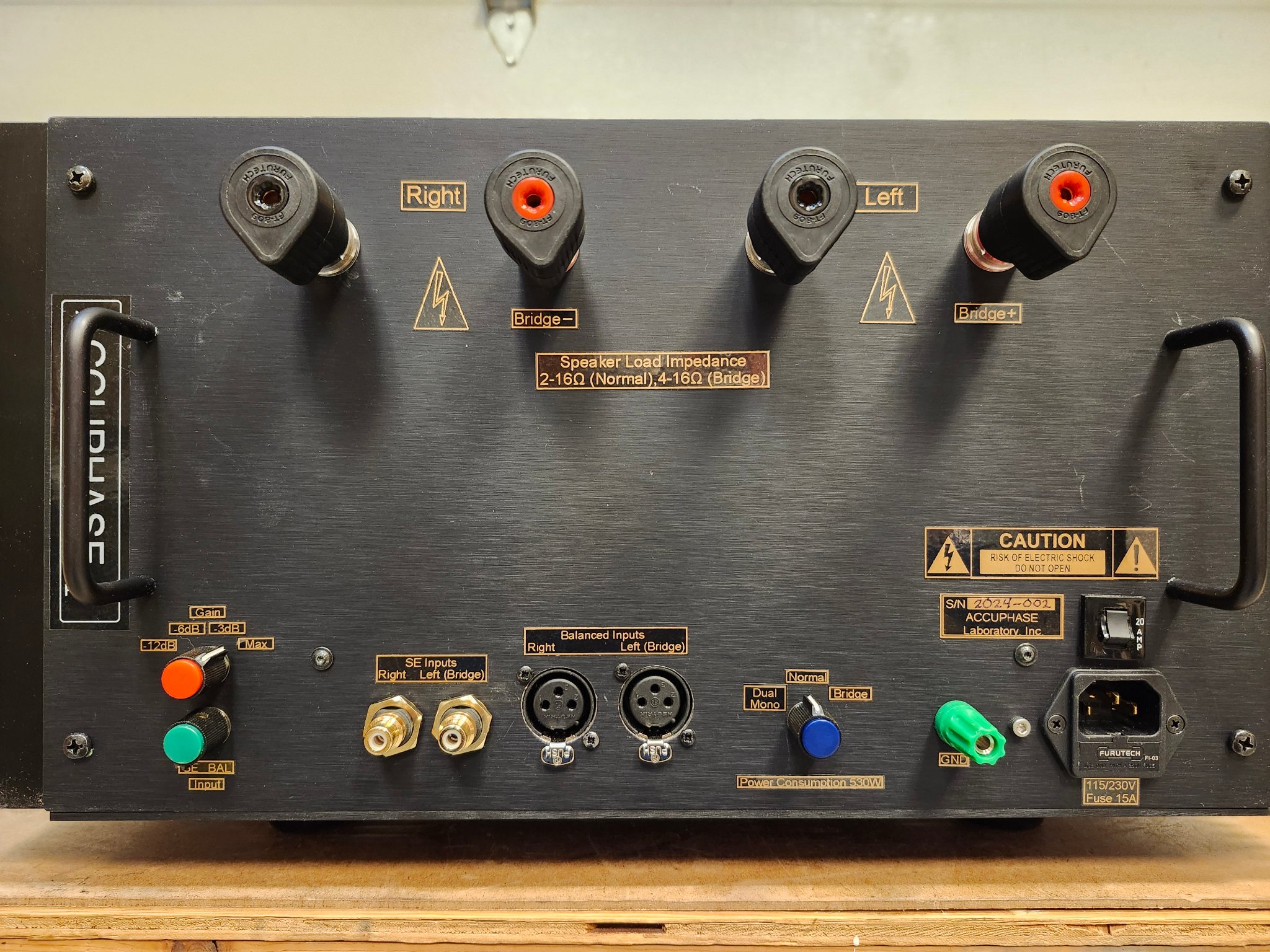

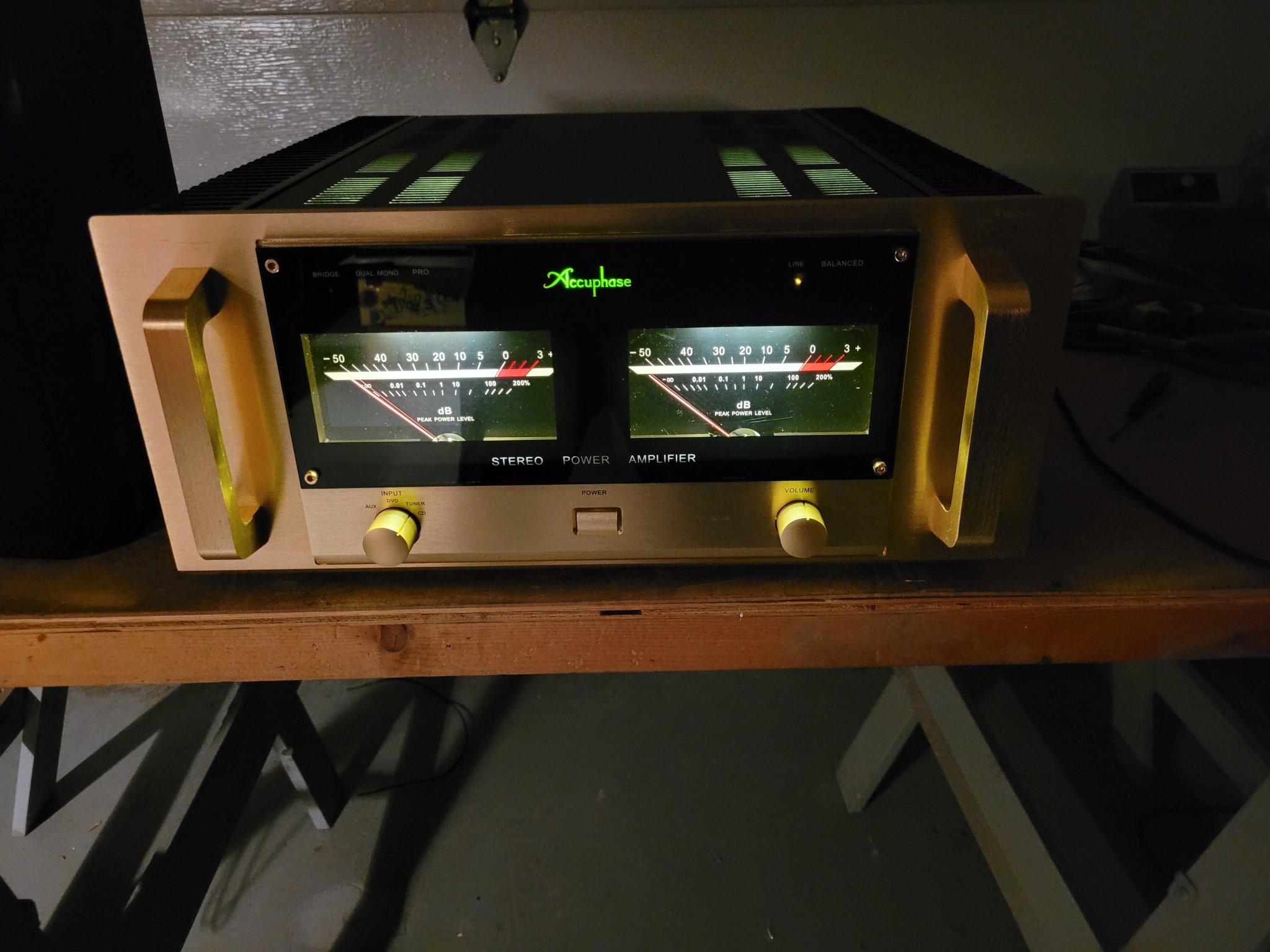

Finally completed my Accuphase, will all front panel leds and lights working. The Accuphase logo is ON when normal and flash in case of a failure. The meters also are turned off in case of failure, as the original. I had some problem to make the meters to work, first I had to figure out the included front panel pcb with its circuit for the lights, and the meters sensibility adjustments. Then I tried to connect the meter driver circuit but there was a constant dc offset at the output of the circuit, strange. Had a deep look at the meter drive circuit schematic and something was very wrong with the meter IC I had, they were counterfeit naturally... Found good ones on ebay, and this time it was making sense... Adjusted the board as per the service manual, and Voilà! a complete amplifier... See the short video showing the lights and meter moving...
None of the functions indicator leds were included, the front panel was machined to received the leds, but no circuit, neither provision to install these leds was included. I had to make my own. The Front panel PCB was supplying only the power to the meter lightning led arrays. See the the back view of the included front panel lights and meter pcb.

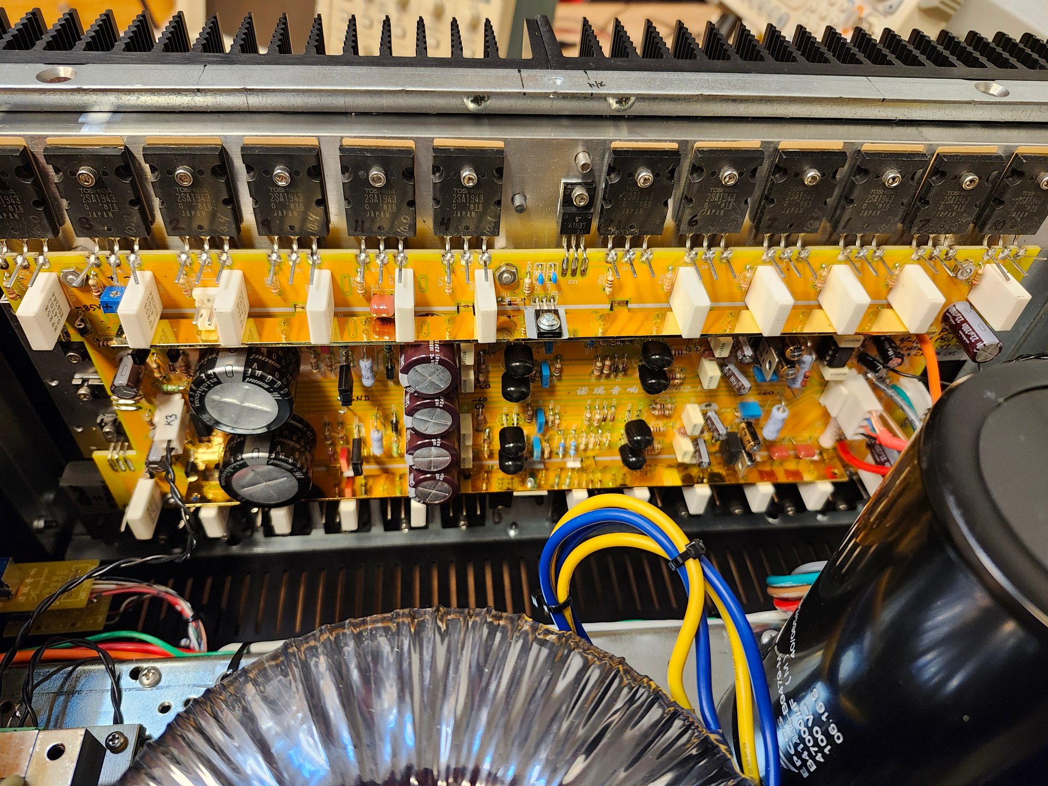

This evening, just completed my second Accuphase P-7100, I hope this one is for me, the other, original clone chassis went to a friend that refused to let it go, it was too good... Since I cannot have ten amps at home (that's what my wife said 😉) I decided to sell it to him, but the sound was so good from this amp, that I missed it a lot.

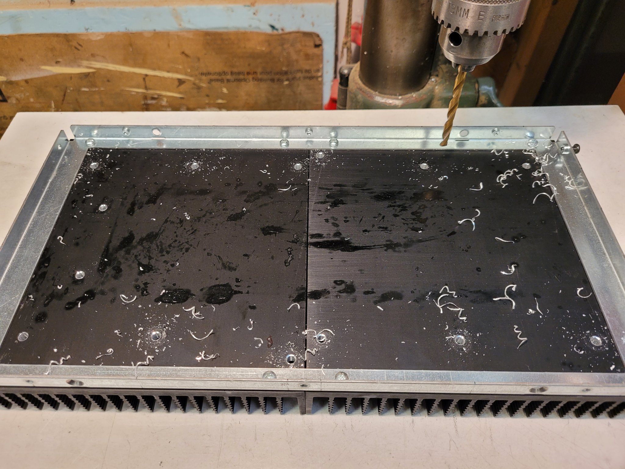

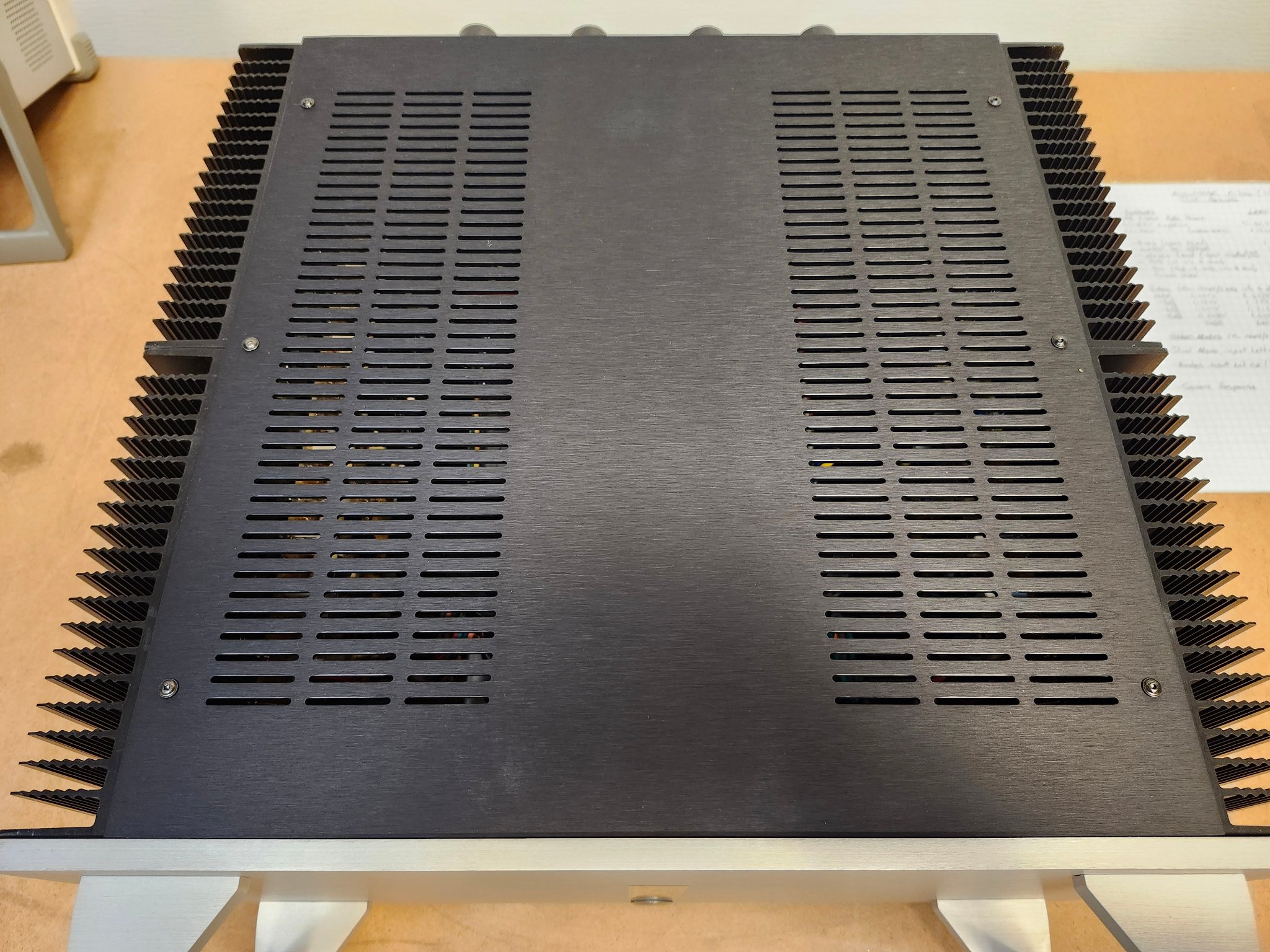

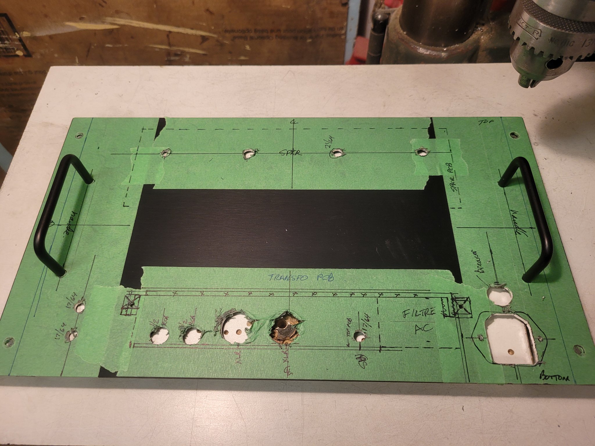

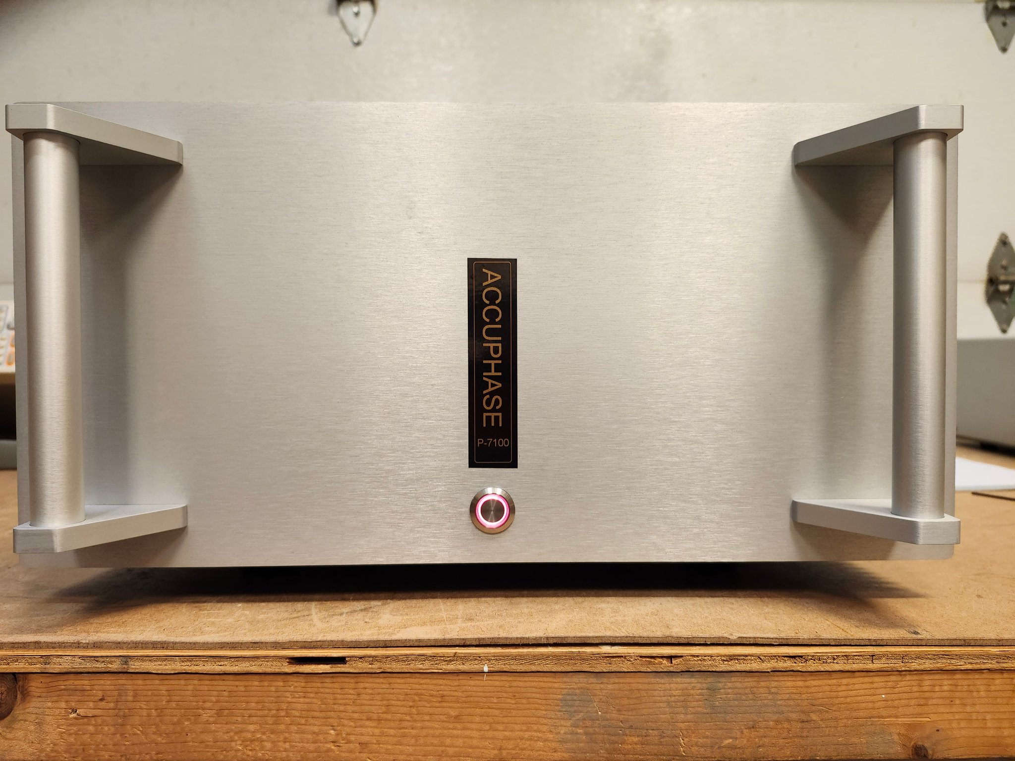

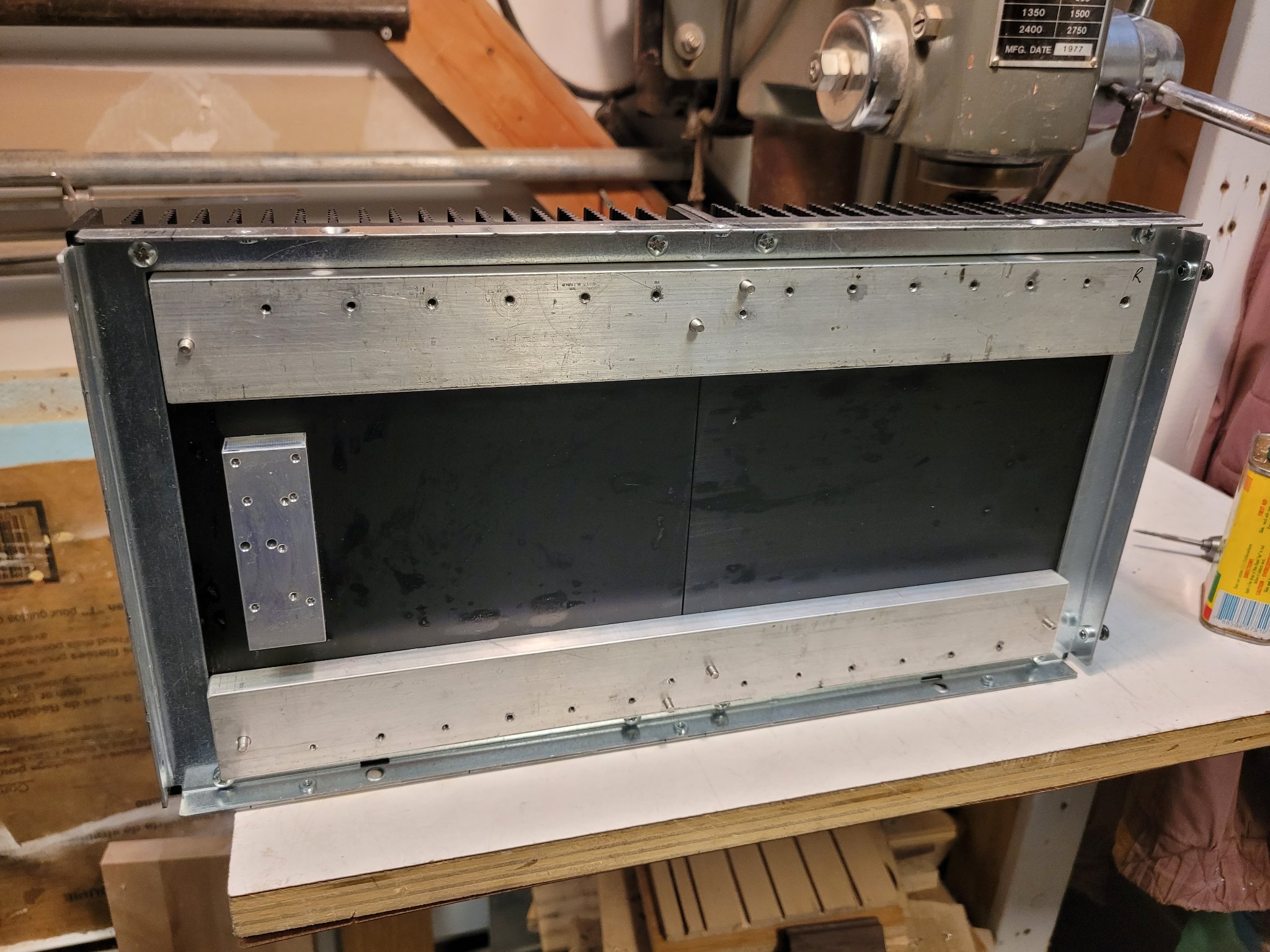

I decided to build a second one, but this time with a simpler to build (and less expensive) chassis from Hifi2000. I bought a 5U Dissipante chassis and modified it to accept the Accuphase pcb. The front has a simple Power-On temporary switch with led, press the switch and it flash at power-on, than turn-On once the speaker relays engage. If there is any fault, the speaker relays open, and the led flash (Faults are DC output and Over temp, the amp has current limiting circuit built-in). Simple and elegant. The front switch activate my own Power-On toggle circuit, with high power relay, better than the original simpler switch. The really expensive Furutech speaker binding posts were so good on my previous built that I had to use them this time again. I can't believe the number of high-end amp I saw with small, flimsy output binding posts. These are the real thing! As the other one I installed heat spreader bars on the heatsink to mount all the transistors.

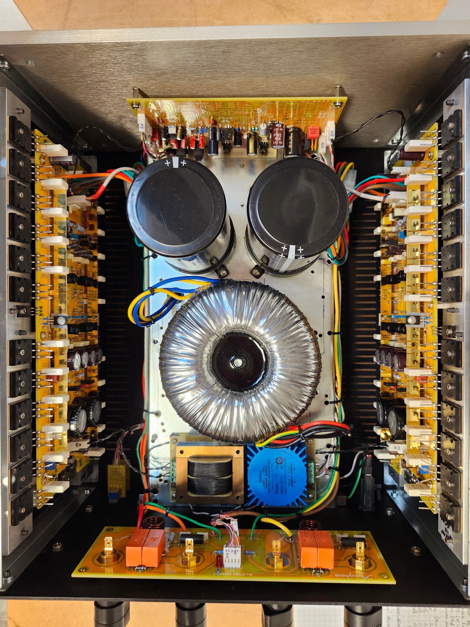

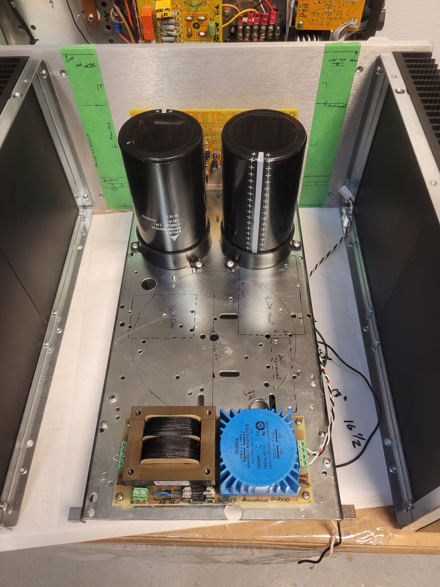

This time I'm using a custom built 1KVA Power transformer from 'James Transformers', great part, potted center, no buzz, great packaging, I'll certainly buy from James again. For the main power supply I'm using 47,000uF/100V big caps I had in stock, the other built uses 51,000uf caps, should work as well... Check the large gauge copper ground bus bar, that's a real star ground! The 5U chassis was just large enough to fit all the boards.

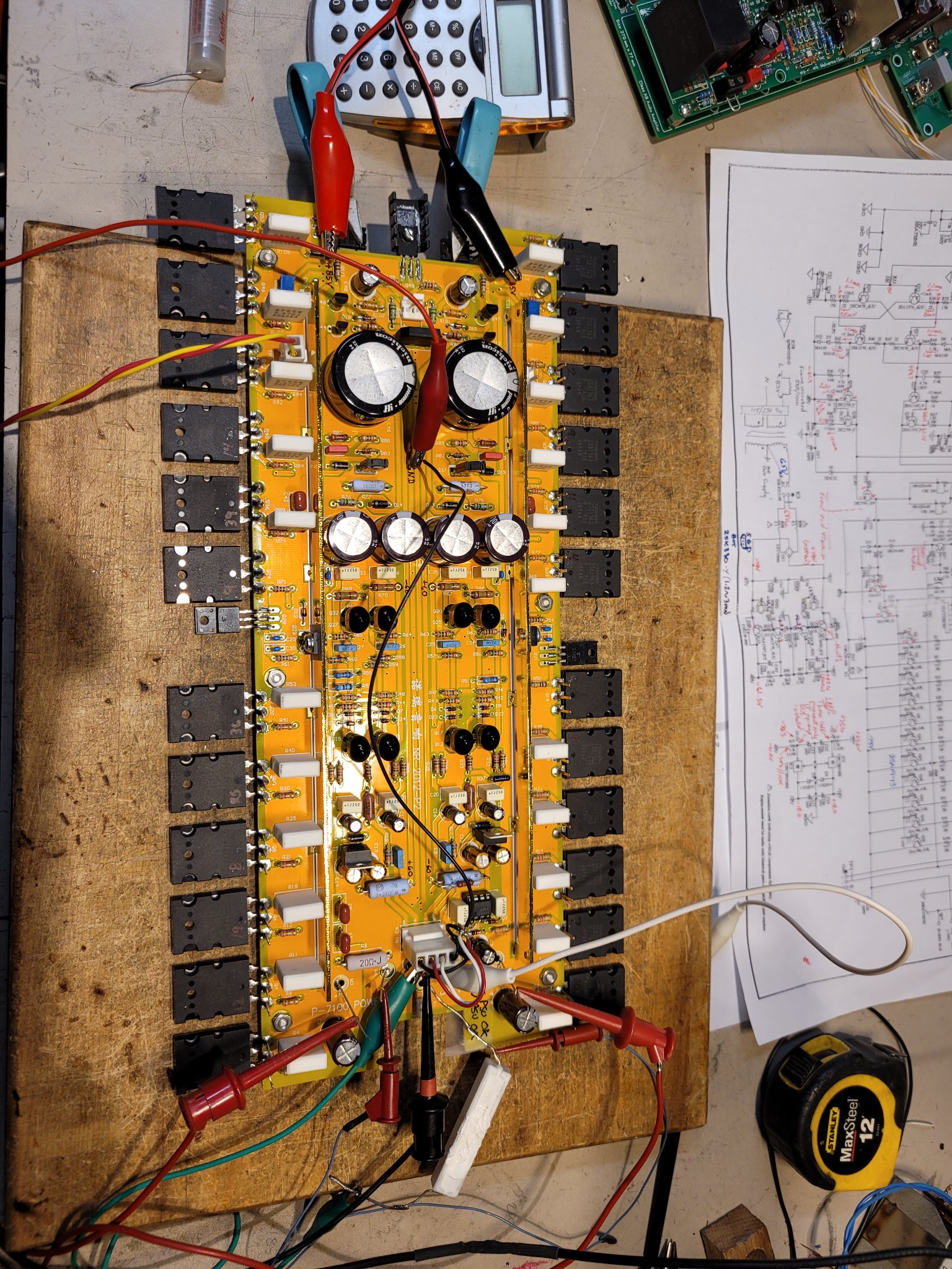

The measured specs are almost identical to the previous one as well. Listening session tomorrow...

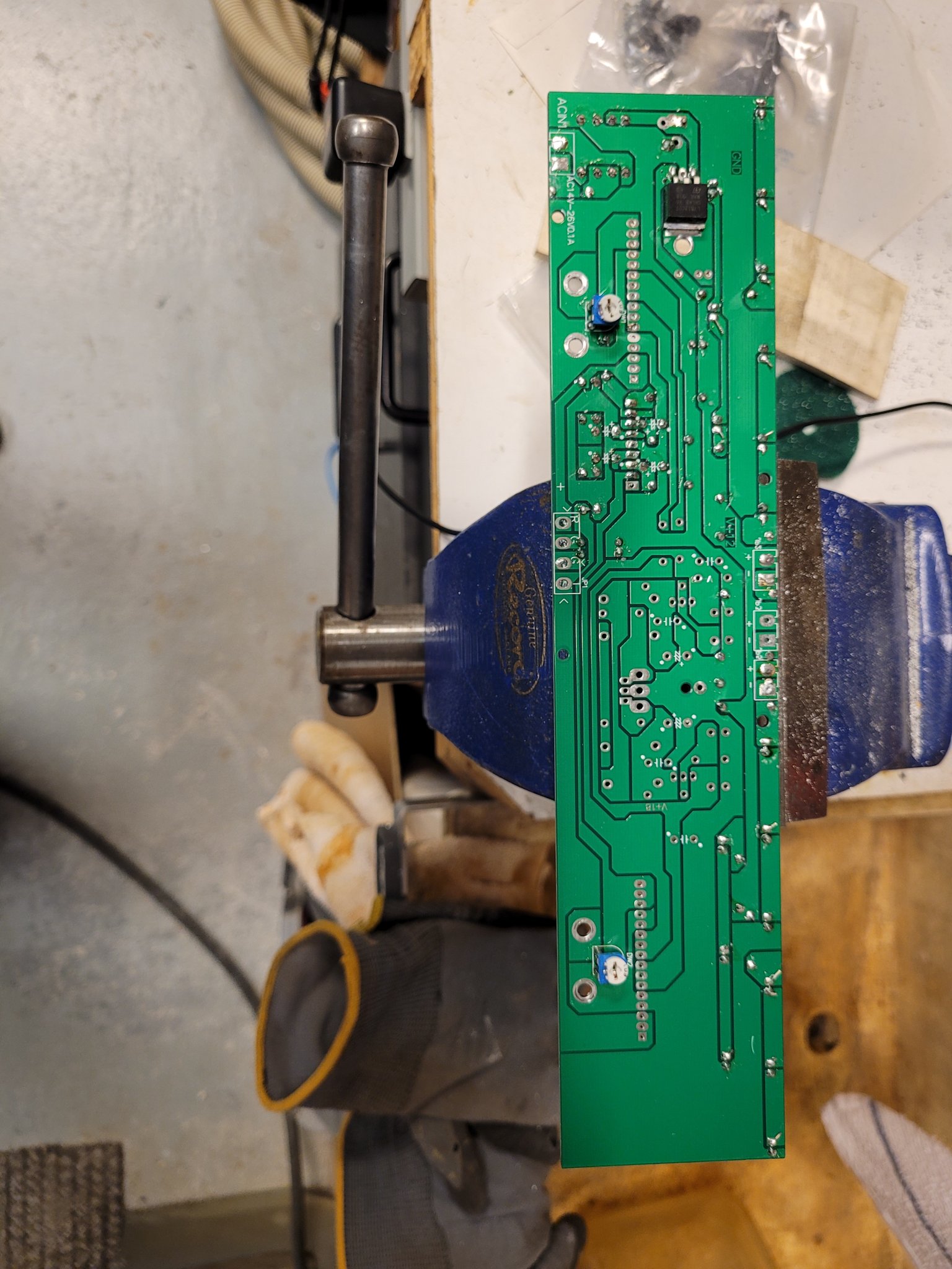

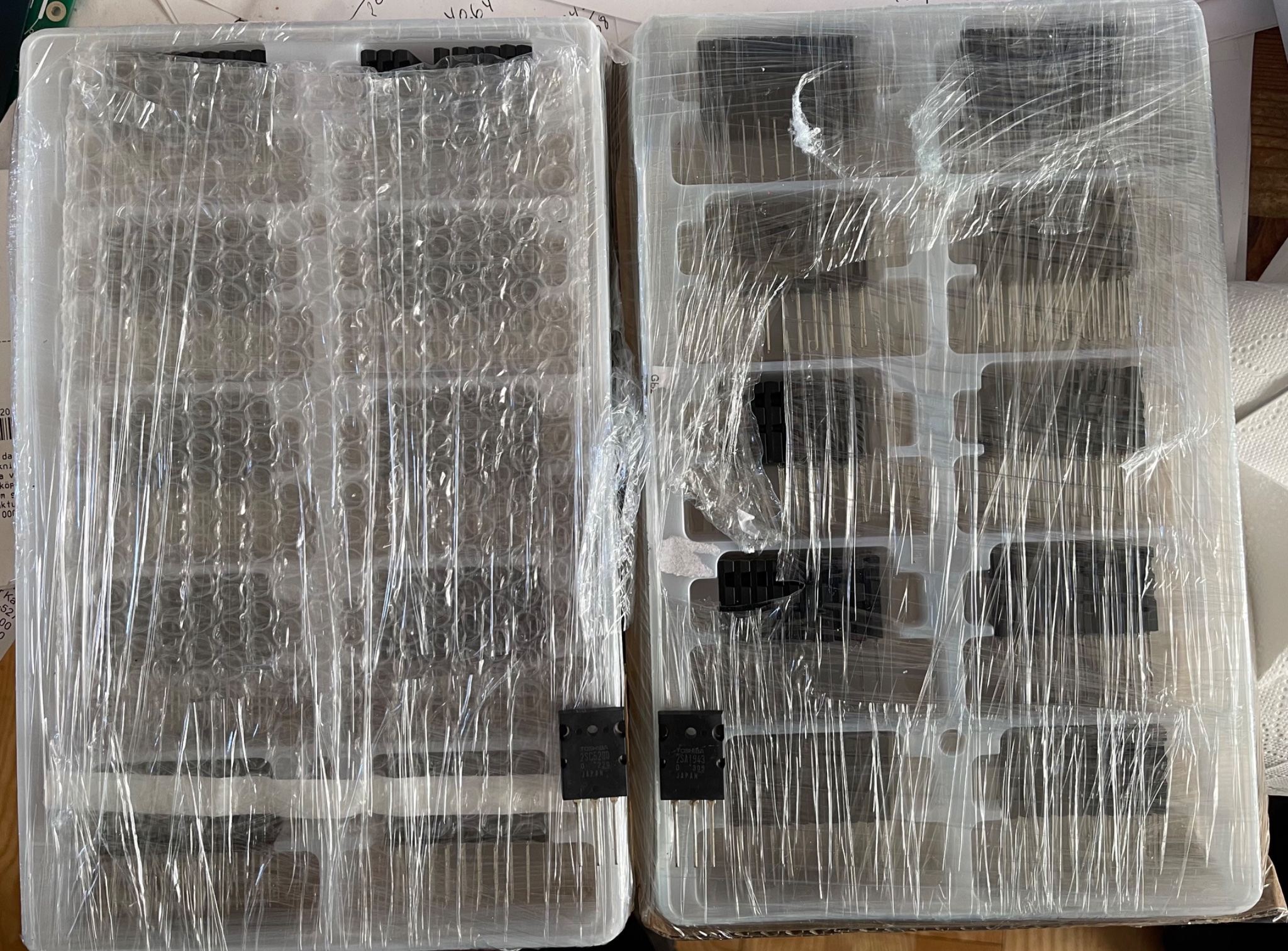

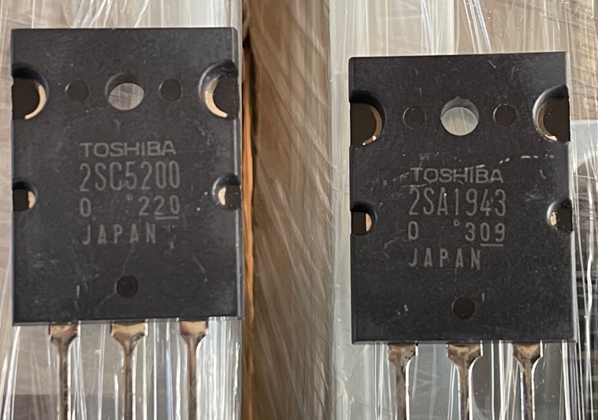

No, got the board set from www.yoycart.com. I can send you the link. It was 112U$ + shipping. PCB are a very high quality, 2mm, ENIG plated, etc... But keep in mind you need a lot of now obsolete 2SC/2SA transistors, most on the net are now fake. I got original ones years ago.
Also the final transistors are difficult to get. I think I bought the last set from Japan. I can sell the set if interested. You can get the service manual with all the schematics and BOM from internet. Got mine from www.hifiengine.com
Also as I said the Meter/protection PCB is incomplete, and you need a lot of info from me to make it work as I did.
So a great project, but now difficult to built because of the obsolete parts... and expensive.

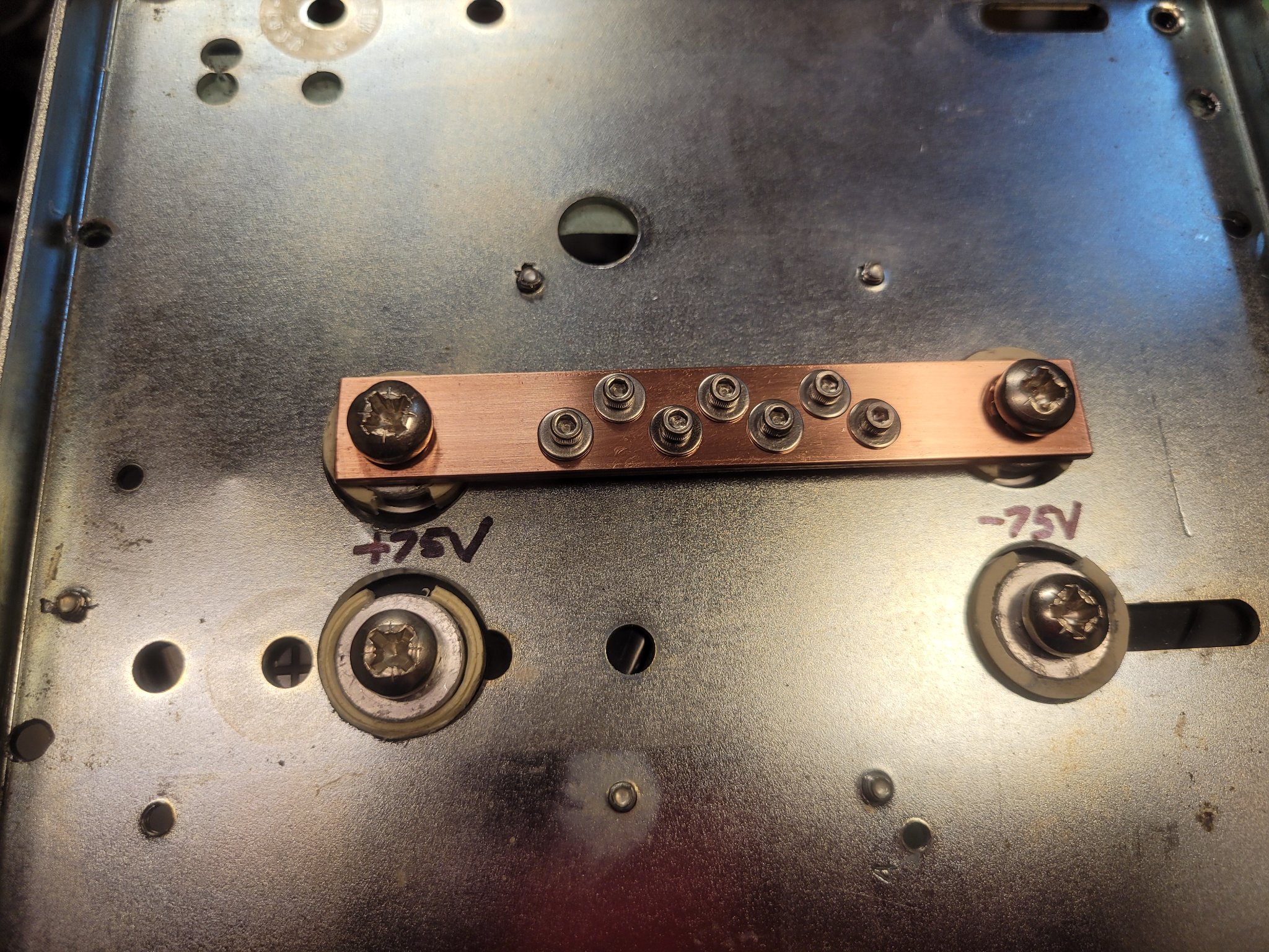

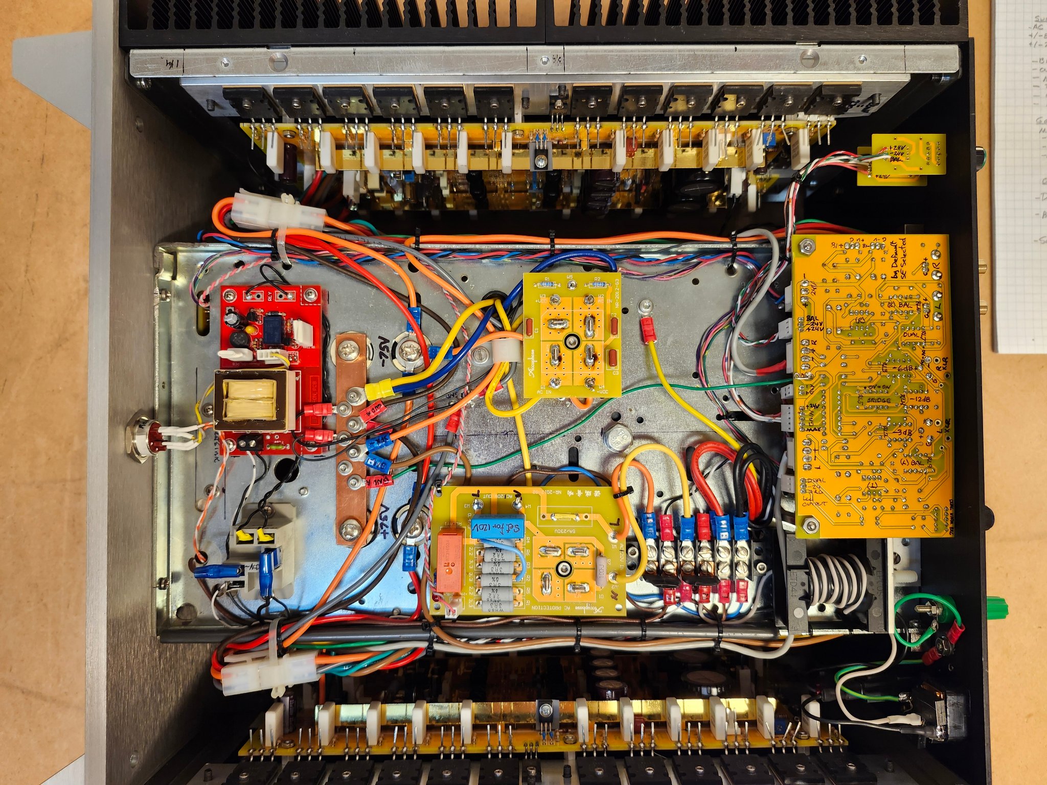

Here bottom view showing all the wirings. Power trnasformer is coming from a Rotel RX-1603 integrated, rated at 180W. Should work in this amp...
