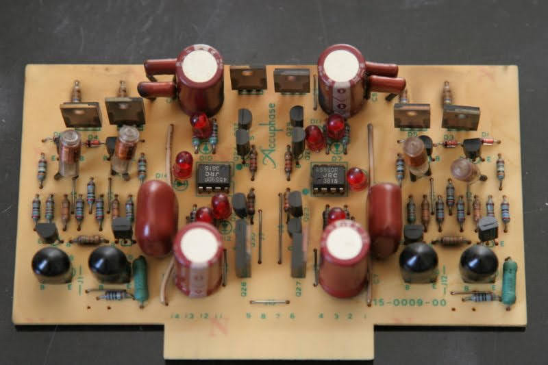

Miguelnoda-- the phono input in any amplifier is usually the most sensitive , it therefore stands to reason that it can pick up external noise not just internal noise generated in the amplifier .
That is the reason AS_Audio asked you to ---Spanish-- cortocircuitado the phono INPUT , I am not a Spanish speaker only some French & German so I don't know if that is the right word .
Until you do that its hard to make progress with your fault.
4559DR (Texas Instruments ) is currently available as a direct replacement .
Of course you could "upgrade " it to some fancy audio IC but your circuit is designed for this unity gain BW of 3MHz upping this without any change in compensation --might work but there is a good chance of HF oscillation .
