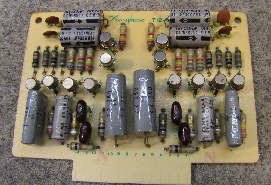

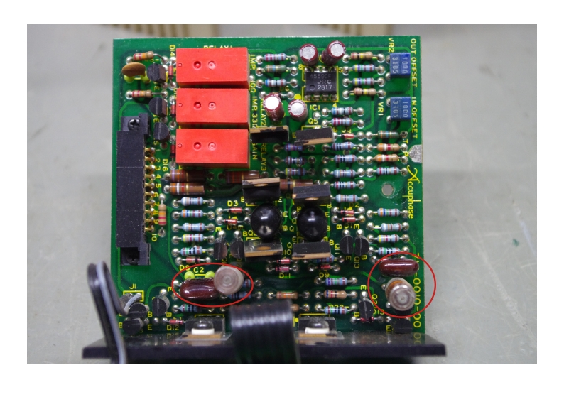

Accuphase Preamp Repair
Once again a preamp fault was caused by a short in some (foil ?) capacitor.
This is a rare failure mode, but frequently enough to be mentioned here.
I talk about the small radial lead caps which look like a brown pillow - like
the four near the t-corners in the attached picture.
So if everything else fails in your error search have a look at one of these.
Most of the time single channel only, signal may be there, but "wrong".
This particular one was in a C-230 (Phono RIAA).
Do you have a sample picture of the green caps ?
brown or green are the same. Polyester capacitor in the feedback network. If You test it out of circuit are with dancers values.
