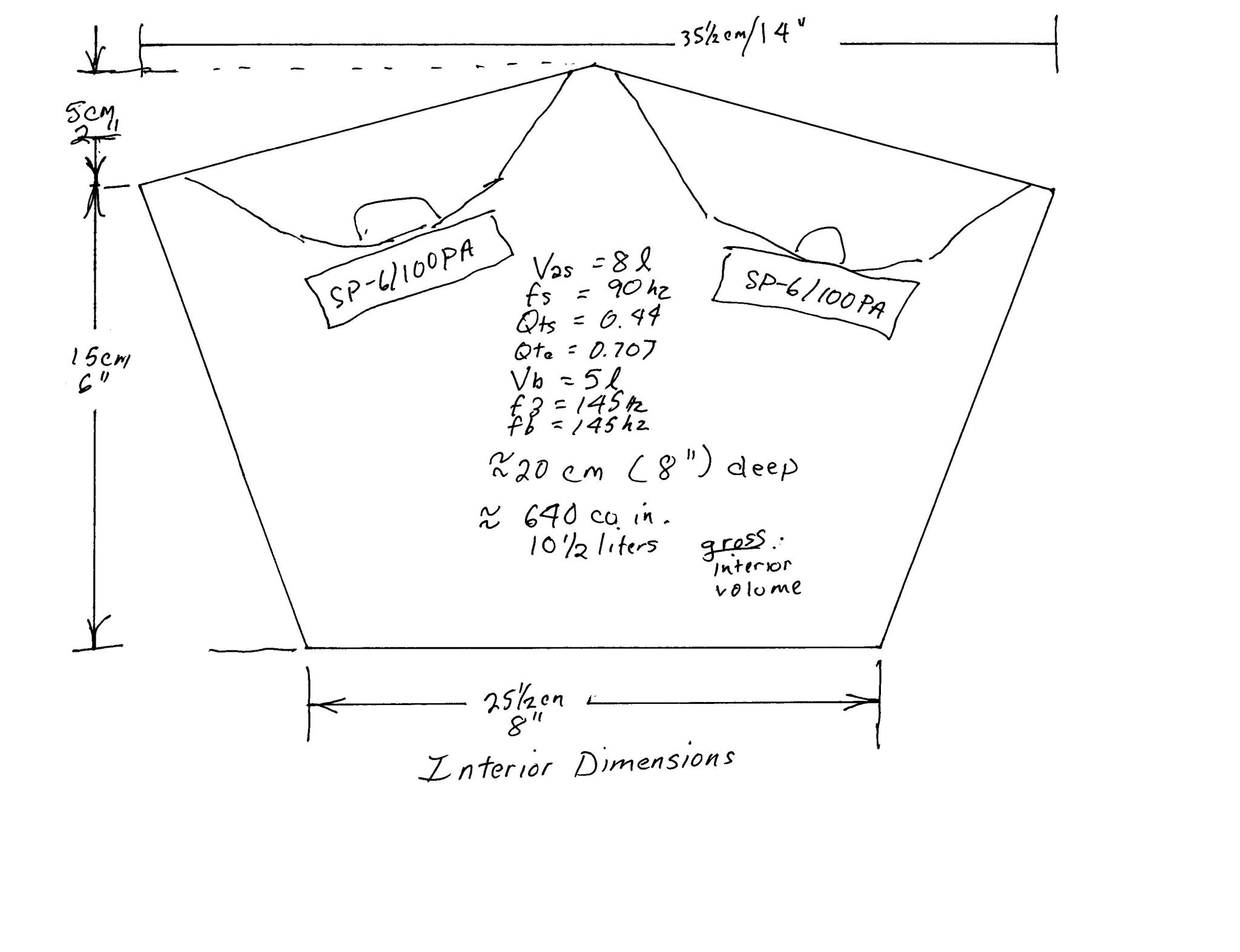

I'm looking to fill that acoustic hole with a center/vocal unit whose main driver is both accurate and has a flat response between 100hz and 2khz (vocal range).
Am experimenting with a 12" PV stage monitor. I've folded four layers of not-so-acoustically transparent knit fabric across it to dampen the harshness I find in PV loudspeakers. The overall volume of sound is about right and I can barely clip the honest 200wpc continuous amp driving the PV. FAR from ideal as the vocals and transients are very poor compared to the AR it replaced.

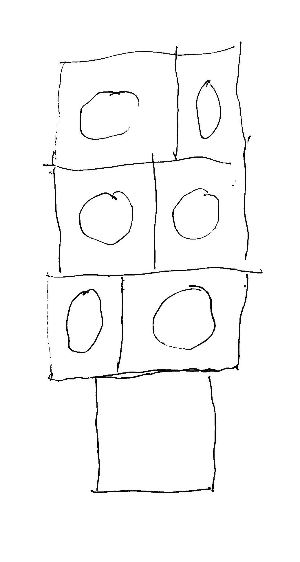

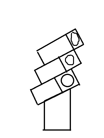

I'm about to cobble together a mismatched array as something of an experiment. Have dug up six known working "satellite" as I called them in the 90s loudspeakers all with 4" - 5" main drivers.
Will experiment with your suggestions to include firing in all directions with a few days to listen both downstairs and up. So far, the more driver area I can throw at it the better to better balance the accompaniment to the piano both downstairs (where it resides) and upstairs (where we typically listen).

I've been experimenting with every loudspeaker in the home and storage. I'm doing my best to find what will work while using the least possible corrective equalization.
I found four pairs plus one single all using an approximately 4" "main" driver and tweeter (most but not all of the dome variety). The upper-bass "hole" remained and I don't believe any reasonable amount of EQ could change the situation. The one nice thing is that I could arrange them in all sorts of way (save the two permanently mounted) to get some interesting if highly consistent imaging.

Please forgive my previous statement to not mention this again, but in this application where I most desire a single loudspeaker to convey a human voice I returned to about the only "live" audio businesses (FORGET home audio unless you want to make an appointment and have at least two digits to the left of the comma in your price) in St. Louis. He's the one who suggested that it just can't be done without a 12" driver. I thought it bizarre at the time but I did not contradict. When I returned to ask if they are dealers for Eminence loudspeakers (they are) I had to say given my experimentation, "I can't really disagree." Do recall here that range is not quality of reproduction across that range.
My working plan is to use a 10" Eminence with whizzer cone in an upright rectangular enclosure of minimal circumference with the upper-front where the driver is installed angled approximately 30 degrees upwards. Eminence suggests a vented enclosure for this particular loudspeaker to lower bass performance but that is not my goal. This design also gives me some space to isolate the internal amplifier from the loudspeaker as it becomes a mini-tower.
