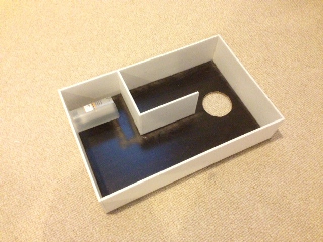

Compact Wall-Mount MLTL Design
I am working on my latest design for a compact Vifa TC9FD wall-mount speaker designed using the AMLTL method. One of the requirements was that it be relatively flat. I decided to start with the TABAQ as a design basis and then modify it from there to suit the cabinet size and materials I have on hand. The TABAQ nominal design calls for a 20 square in CSA (4 in x 5 in typ) and a 30.7 in long line length with a 4 in x 0.75 in (2.5 square inch CSA) x 3.75 in long vent, of course with usual driver mounted at 1/3 from closed end and stuffing in first 2/3rds.
I have some wood-grain masonite (chip board) panel on hand that is 11.25 in wide so I made 2 baffles 17 in tall with top-centrally mounted driver so that the speaker can be used for either left or right channel. Being 17 in tall with a single fold, the line length is 34 in instead of 30.7 in. I decided to stick with the 20 sq in CSA and with 3/16 in foam core walls, the TL width is 5.33 in which specifies a 3.75 in depth. Using these dimensions for a 11.13 liter box tuned to 61 Hz, I end up with a circular 2.0 in dia x 4.18 in long vent. I have decided to put the vent downward firing.
The baffle is 1/4 in thick masonite and is the first time I have made a speaker baffle out of something other than foam core. The walls, back, and dividers will still be foam core.
Hmm, in theory, the vent terminus needs to be > 3*r from a parallel surface, so it will be interesting to see what it winds up being tuned at, especially since the cab's construction is somewhat lossy. Then again, tuning is so far below Fs, it may be a moot point.
