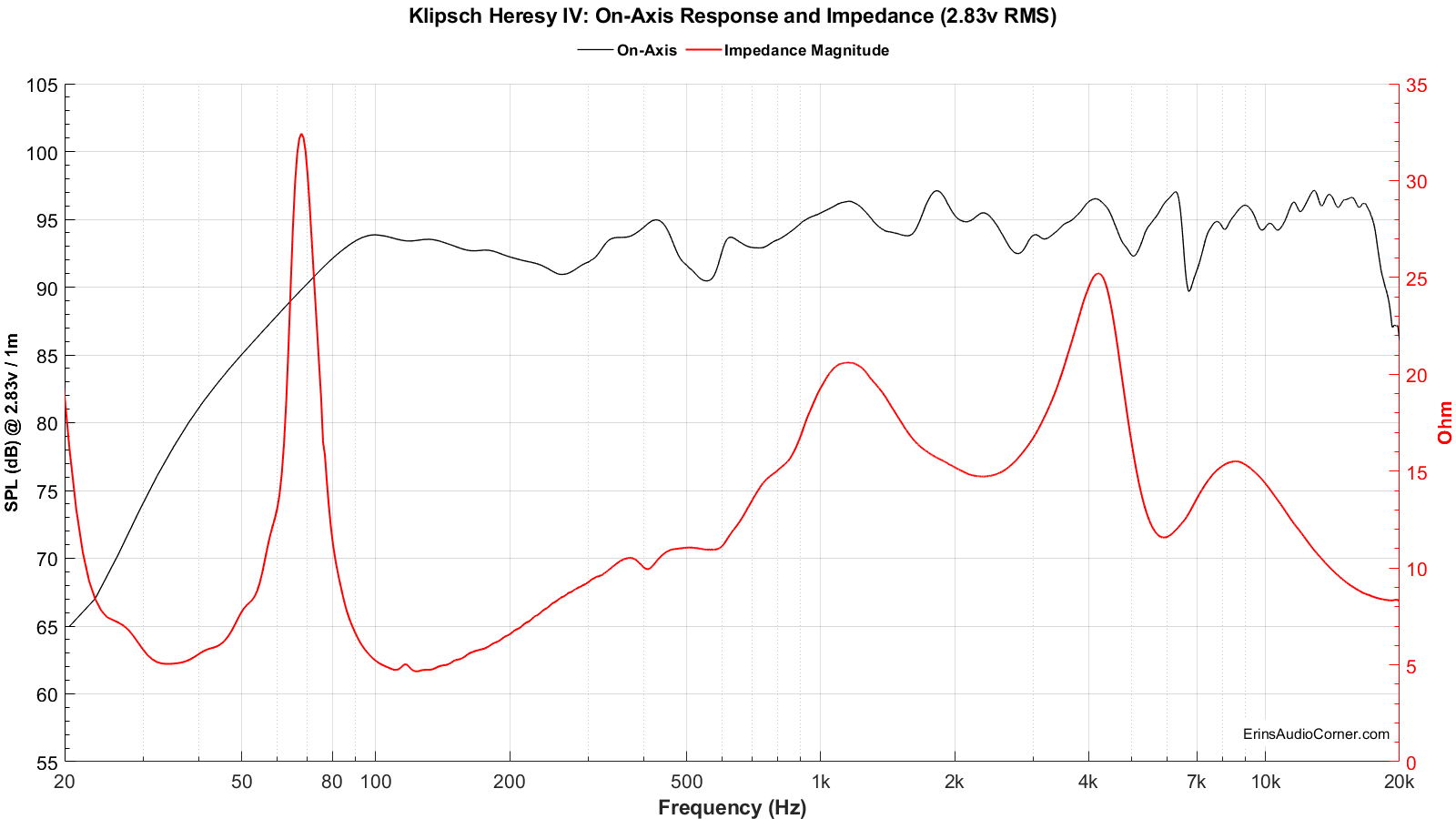

An impedance measurement will be easier and as useful (if not, more useful; imagine you measure the cabinet in the "wrong" spot).

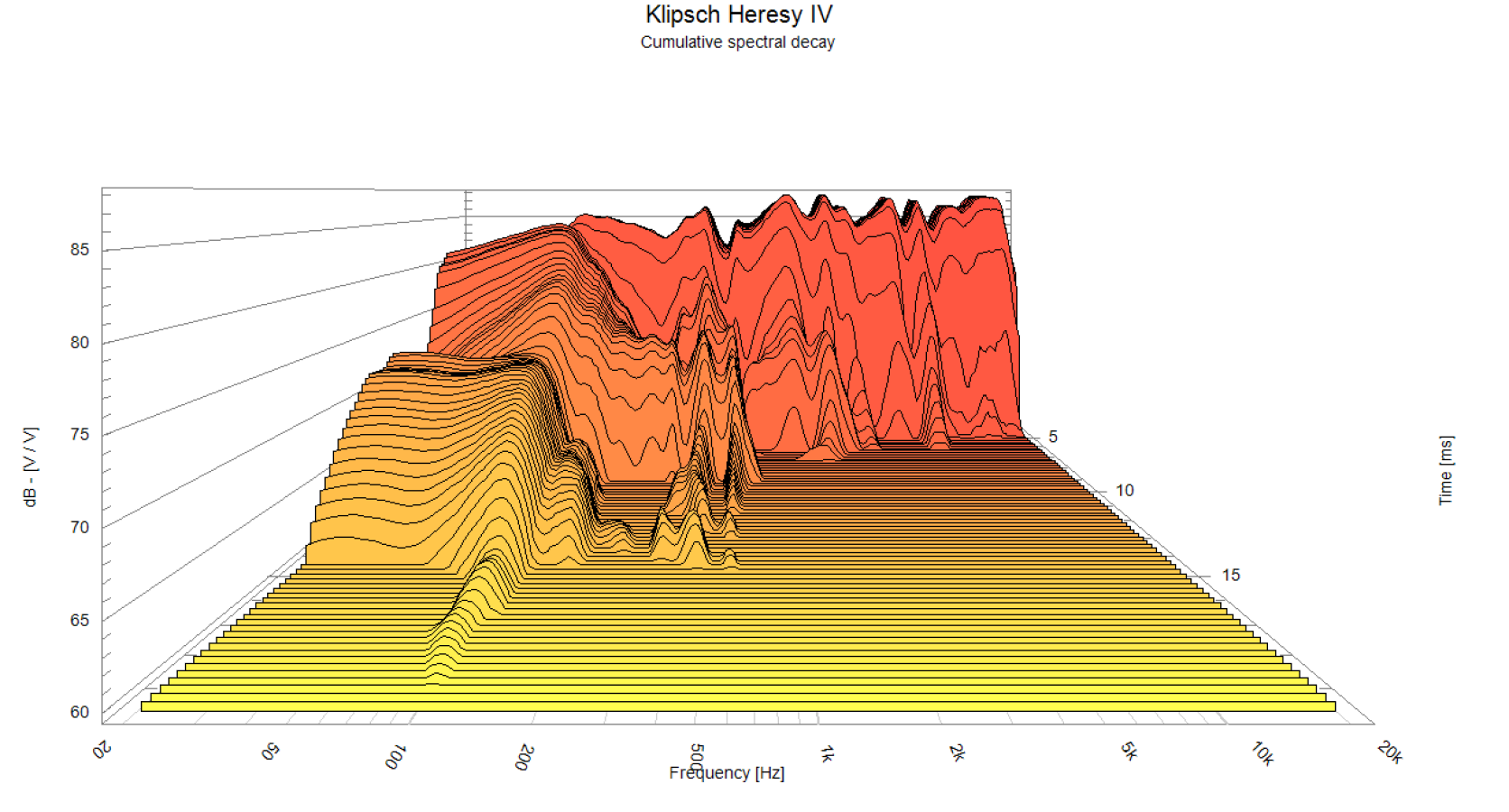

You can verify resonances with a CSD if you wish.
For example, a recent loudspeaker test I conducted shows a cabinet resonance ~120Hz:
Klipsch Heresy IV Speaker Review
You can see this in the impedance and the CSD backs this up:
classicalfan> I'm not putting forth those results as being any great idea by myself, so I don't have any horse in the race whether they perform well or not. I just wanted to find out what works. Bracing quite obviously does. Is it enough? Well we can debate that and certainly I'm looking to improve on those baseline results, but to say bracing does nothing but shift frequency just is not born out my measurements or others I've seen. I'm not sure what the contect of Linkwitz's tests were. Was he bracing an open baffle? Not at all the same thing as a box.
bikinpunk> I wouldn't call that cabinet resonance, but pipe resonance of the air in the cabinet.
augerpro> NF measurement of the port (I assume this is what you mean by pipe resonance?) shows turbulence a couple octaves up between 400-600Hz (the impedance shows this as well). But no port resonance in the region I mentioned above.
If you mean standing waves inside the enclosure, that's what I mean... the inside of the enclosure is resonating, thus driving vibration at the panels. And, while I have the data, I can tell you there was audible resonance from lower male vocals during my subjective evaluation (performed well before the speaker was measured objectively) and I estimated it to be in the 150Hz region. The data showed what I was hearing.

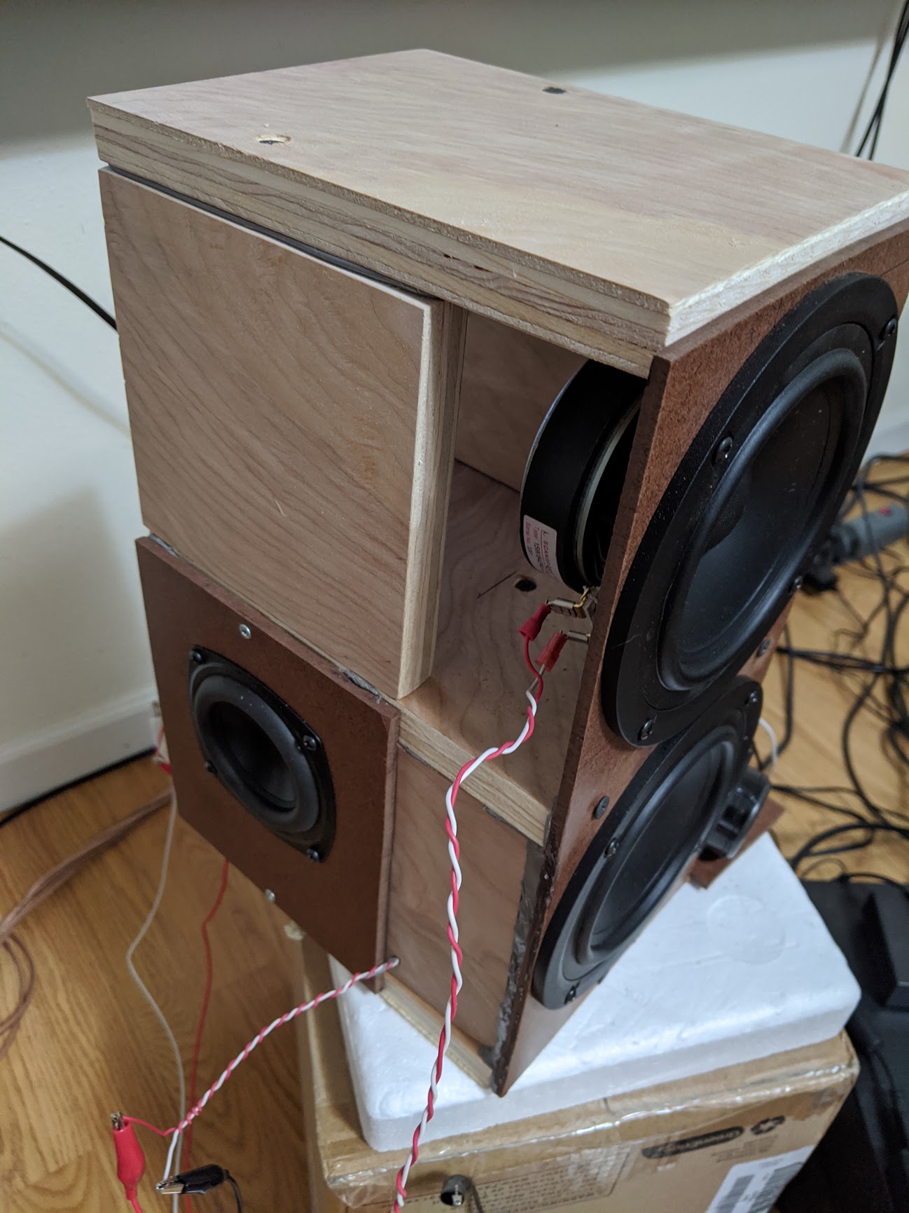

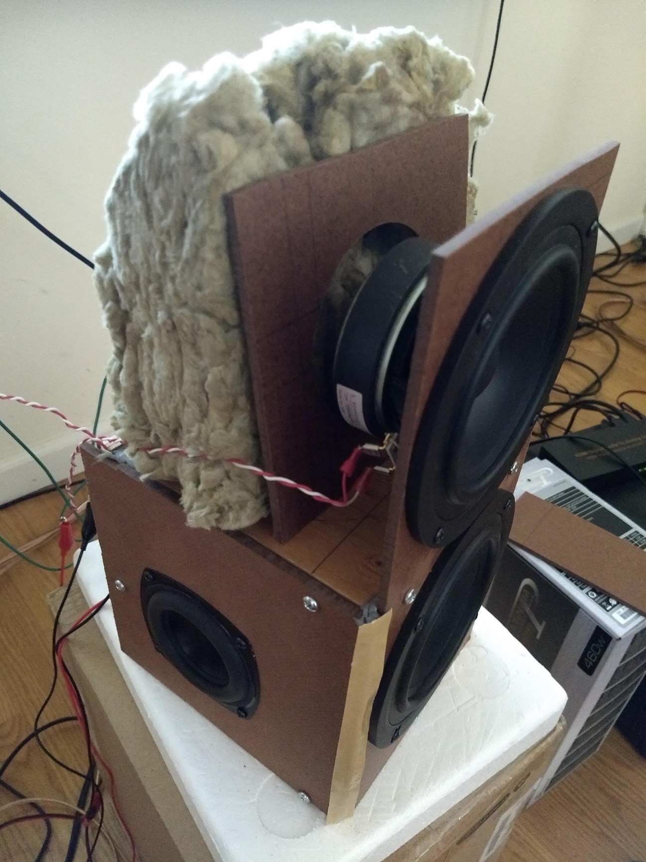

I built a low-mid box with one driver boxed and one open + a removable cardioid box.
Both drivers have the same frequency response curve controlled with DSP and measured with REW yet they sound different. As I add stuffing (mineral wool) behind the open driver they begin to sound more similar.
My hunch is that the box sound is just a type of directivity. If your ear is close to the driver they both sound the same. Get out into room reflections and they sound different.
That's just my hunch not fact.
