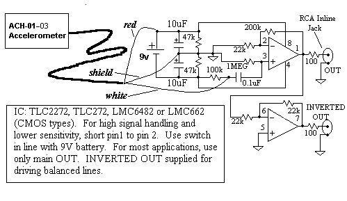

Several years ago, I played with an ACH-01, which you used to be able to buy a battery powered amplifier to go with it. You can find amp ref in bwaslo link in post #19. I used REW in an attempt to produce similar waterfall plots as shown in Stereophile. I used "Tacky Wax" to fasten it to the cabinet.
As several others have advised, it is not easy to calibrate and it does n't really tell much about what is going on.
Dependent upon how your rigid your cabinets are to start with it may be worth using the frequency generator in REW or similar, then using your hand or stethoscope to feel the vibrations.
For those wishing to DIY the amp, here is the detail.

It can actually be much simpler than that, just a 2.2k between the battery +9V and the "drain" connection. Connect the "source connection" to the "ground" connection. A 3.3uF cap from the "drain" to the soundcard hot input, and battery [-] connection to ground, and soundcard cold/hot connection to ground. Two other parts only....
The opamp circuit is if you want all the dynamic range you can get, but that isn't likely needed unless you are trying to drive a pro audio mixer input.

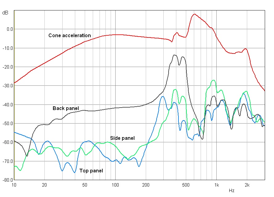

Here is a measurement with the ACH accelerometer placed on the panels of a subwoofer cabinet.
The side panels were very well braced and the back panel was not braced at all.
There is a difference of almost 20 dBs between them.
My opininon is that if you have the capability to make measurements, then there is a lot of things you could do to lower the vibration of a cabinet panel.
It will be a slow, step-by-step procedure but the final result will be much better.
And an accelerometer like ACH is a good start.
