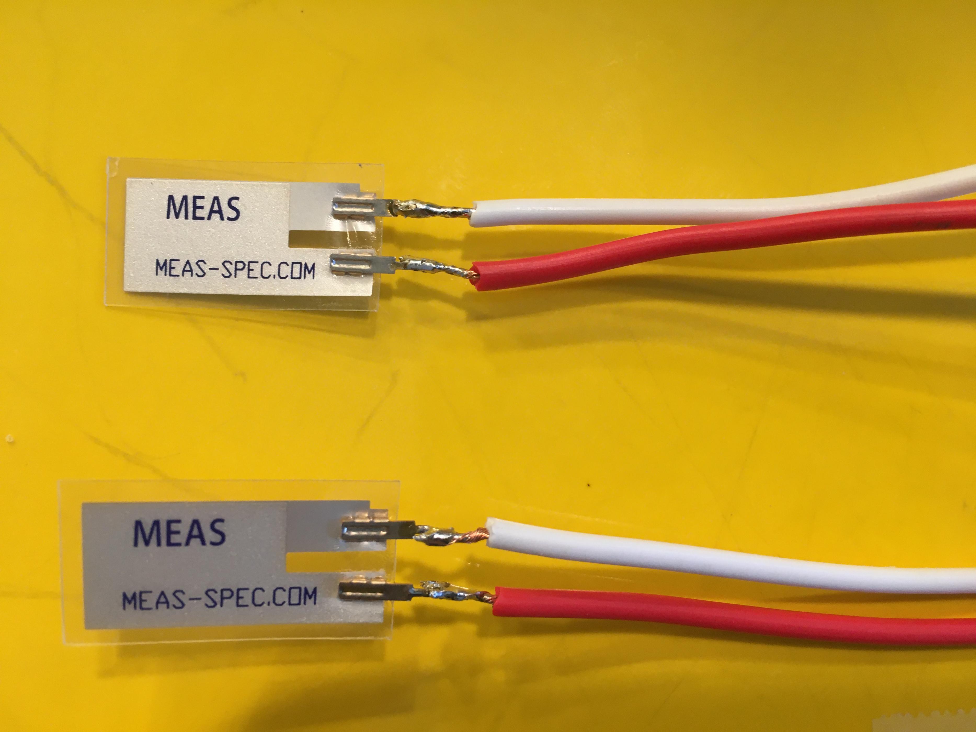

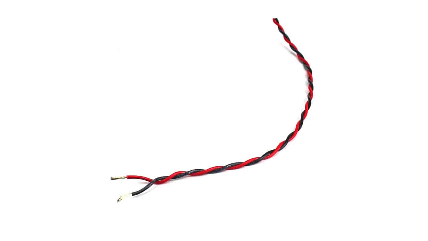

Delicate operation. Solder at the lowest possible temperature. The plastic will melt at the slightest provocation. I bought two, just in case I flubbed up on one, which I may have. You can see some warping of the plastic on one. Each wire is terminated with an alligator clip on the opposite end. These things are tiny!

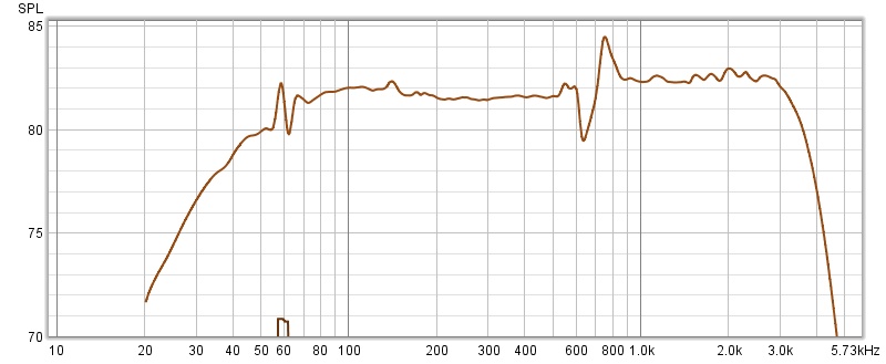

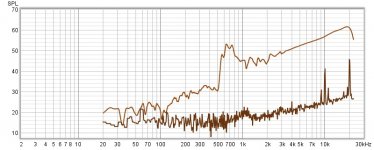

First measurement of signal vs noise floor with piezo accelerometer attached to concrete floor. Excellent results! This means that the piezo is picking up zero sound through the most important frequency band(110db measured at the piezo with calibrated mic). The drop in signal below 600hz is due to the huge impedance mismatch that will be fixed later on today when I get the buffer amp. When that is fixed, the signal should be perfectly flat with the noise floor(while attached to the concrete floor), down to around 50hz.

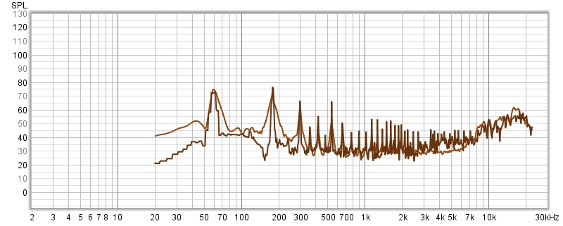

Dunlavy panel vs noise floor. Taking the impedance mismatch into consideration, the accelerometer response looks extremely linear, and the panel resonance on the Dunlavy is sticking out like a sore thumb, exactly where John Atkinson measured it at. When the buffer gets applied, the signal won't have the downward trend that it does now. Things are looking good! These piezo accelerometers must have extraordinarily high source impedance, even compared to piezo contact mics.
Okay, this is the first accelerometer measurement with the buffer. In this measurement, accelerometer is taped to the concrete floor. Exactly as I hoped, the signal is buried in the buffer's electronic noise floor. That means it's not picking up any audio signals through the air. Noise is pretty bad though.
Dunlavy accelerometer measurement. It's interesting how that one point on the exact center of the side panel is effecting the accelerometer, which does not represent the overall acoustic output of the panel as a whole. Ignore the blip at 60hz. It's a result of noise.

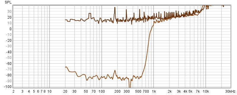

It's pretty obvious why they didn't publish the thd and noise spec. And yes, it is in bypass mode.

Thanks for the graphs! Looks like good progress on these. You can certainly see the vibration spike.
Have you tried a baseline measurement with the film mic taped to your speaker, but with no sounds? What's the S/N ratio? At 5M unbalanced, electrical noise is going to be a problem, but maybe the vibration signal is strong enough to drown the noise. You might be able to shield them with aluminum foil connected to a ground point. Or it could make things worse, that has happened to me.

I did a bit of reading a couple weeks back and there was talk of needing shielding for these. But if silent vs vibration is a high enough ratio, then maybe electrical shielding doesn't matter.
