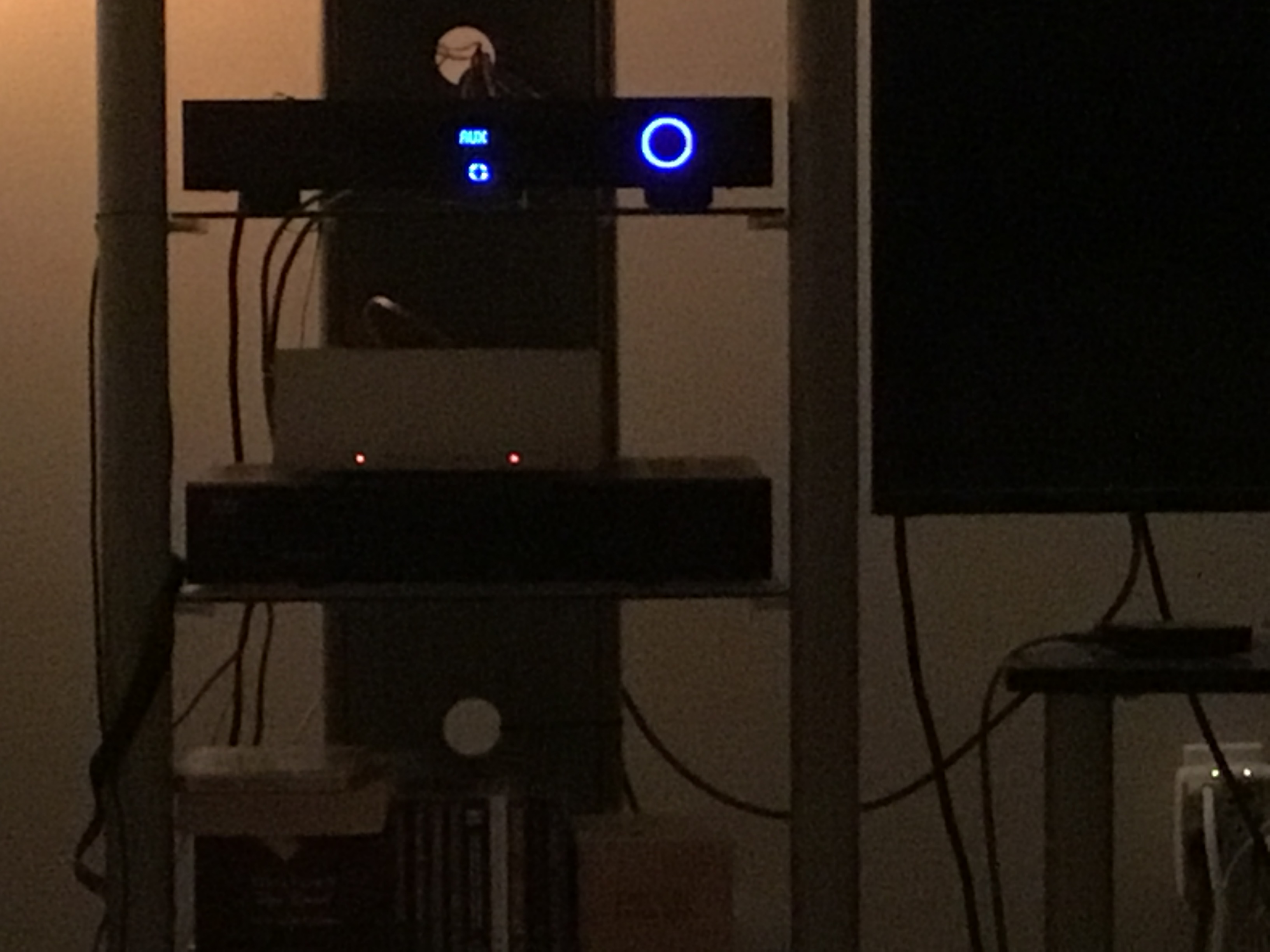

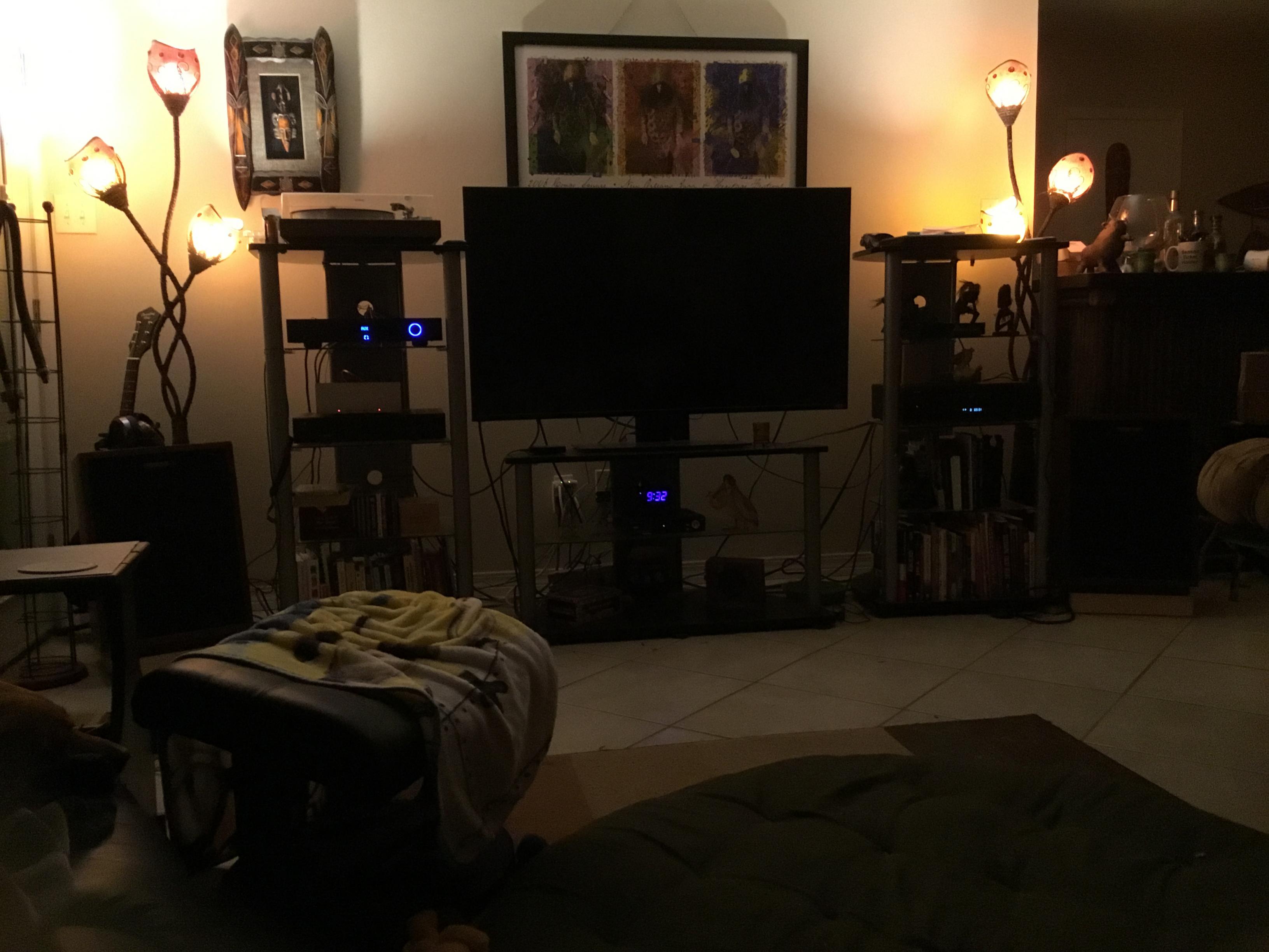

Reply from the couch! Mose Allison playing. It is situated underneath the preamp with the blue lights.
