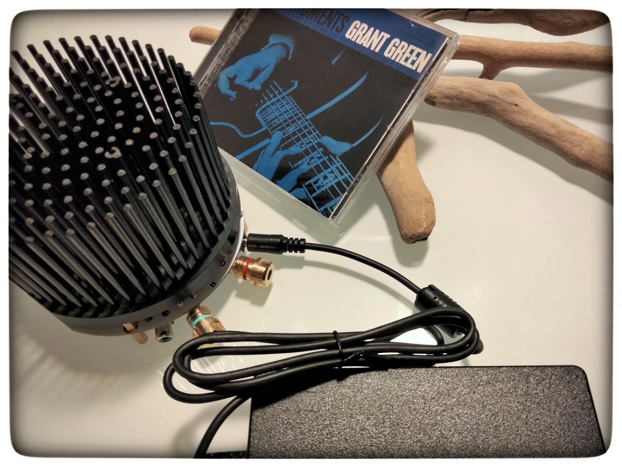

Absolutely totally cool! Great idea! Design is very creative and clever. If they were available, I would have bought two instead of the more expensive ACA pair I recently purchased. I would bet a paycheck you will sell out of every kit you can make available.
You would need 4 for the same amount of channels and power 😉I would have bought two instead of the more expensive ACA pair

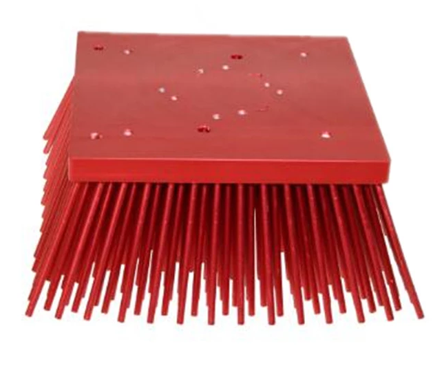

Member @peppennino alerted the thread to (this heatsink) . Maybe you could use it as the widest portion of an inverted Egyptian pyramid, with amplifier PCB and daughter-card PCB stacking to form the pyramid shape. You could dedicate the daughter card PCB to SMPS DC filtering and nothing else; then install a more elaborate filter circuit with much greater HF noise attenuation. Spend an extra six dollars on the filter and save thirty five dollars by using a cheaper alternative to the Mean Well PSU brick. Oh and by the way, musical signals wouldn't travel vertically, back and forth between amp PCB and daughter PCB; only +24VDC. You could even put ferrite beads on the vertical mounting legs that hold the daughter PCB.
The splayed pins of the radiator design, would allow much more visible light from the "glow" LEDs. The perfectly vertical pin fins of RACAM's cylindrical radiator, unfortunately block all optical paths except perfectly vertical. Delightfully, splayed pins allow a nice wide cone of glow light to escape. Maybe amber or orange LEDs would complement the red aluminum nicely.

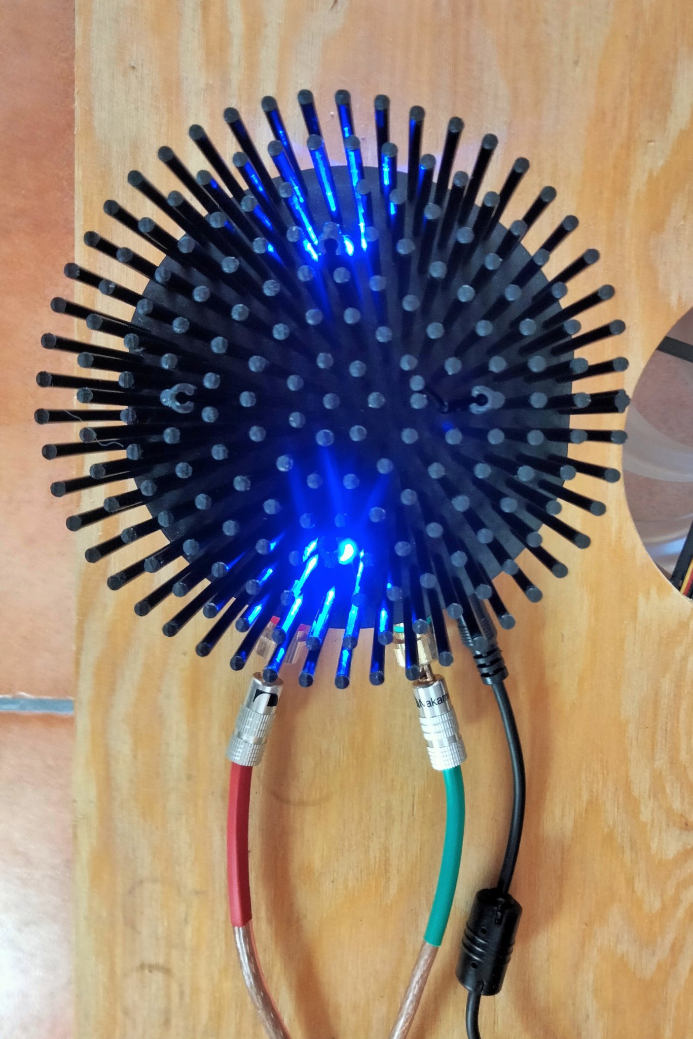

Thanks for this design! I have two of these PCBs and intend on starting the build next week. I'd love to see some pictures of people's DIY enclosures for these if anyone's built some?
Given that it's round, a soup can will probably do lol.
I'd love to see what you come up with, but one benefit of this design is that an enclosure is not needed. 24V is touch safe, just don't lick it or drop bits of metal on the PCB.

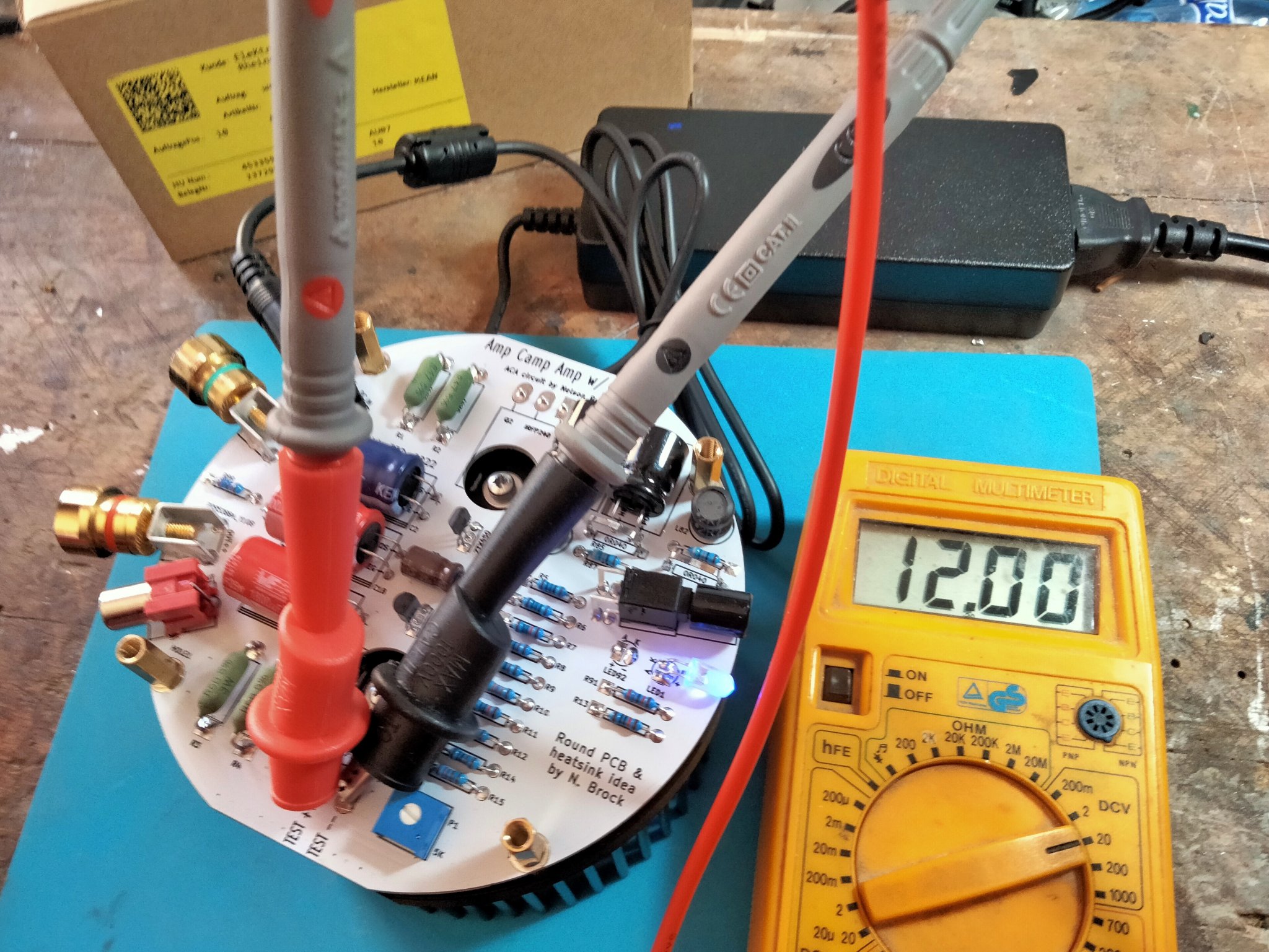

Yes, that's right, it can be within a few tenths of a volt and it's fine.As I'm using a 24V brick, I have to adjust P1 to 12V, right?
