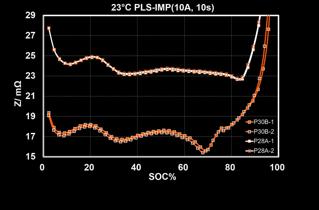

The impedance of lithium cells starts to increase when used at low temperatures or when used at the extremes of the soc(below 10-20% and above 80-90%) or when very old.
Usually you use the batteries in this range of the soc(20-80%)because of the increased cycle life.

If lifepo you might get away without a voltage regulator. Lifepo cells have the 20-80% soc range between 3.25v and 3.35v.
If your sistem has 8 cells in series the voltage will go up and down by 0.8v from 26v to 26.8v
