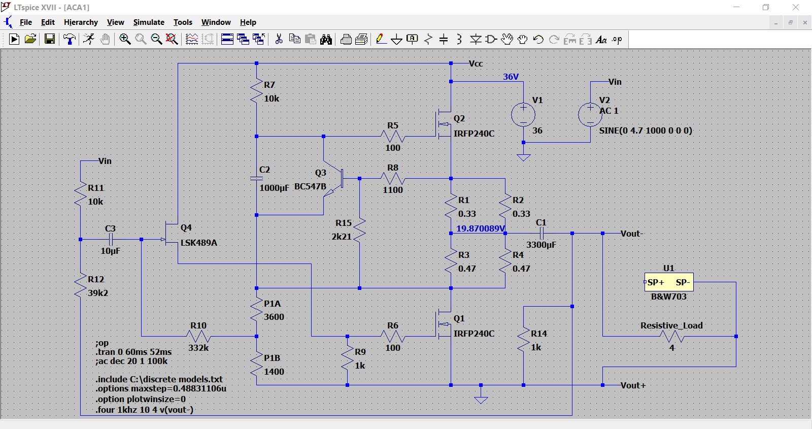

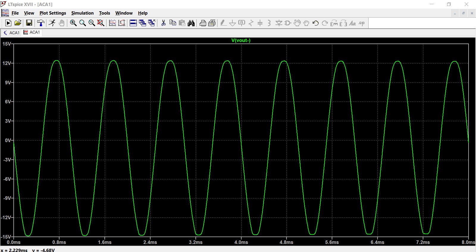

It's perhaps not as good as might be thought. Admittedly just a simulation based on the original (which to be fair comes out pretty close to the published specs).
This is running 2.4A with the midpoint optimised for symmetrical clipping. The clipping never looks symetrical.
