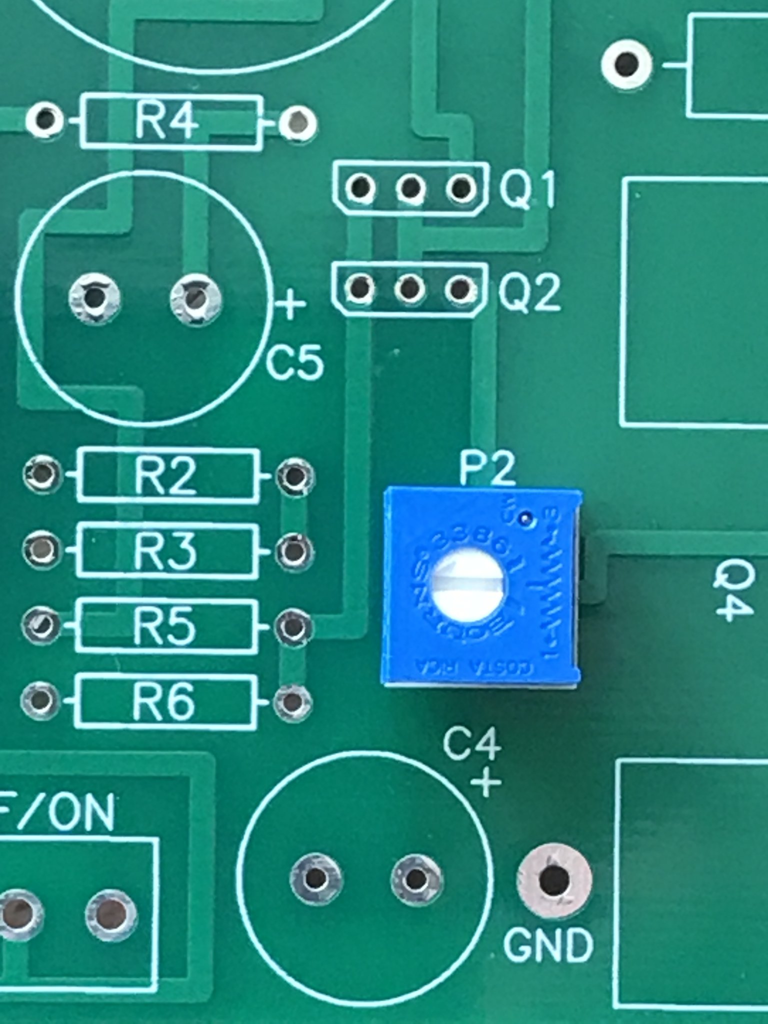

Hi, also in my kit there are "wrong trim pots", which do not fit corretly the board holes.
I wrote to diyaudiostore, but in the meanwhile I'm looking for correct trim pots in online stores. Could some one give me the correct product series/ID?
thanks!!
PS: mine are BOURNS 3386 series, CW type

I assume you're looking for the 2k pot. If so, then that looks fine.

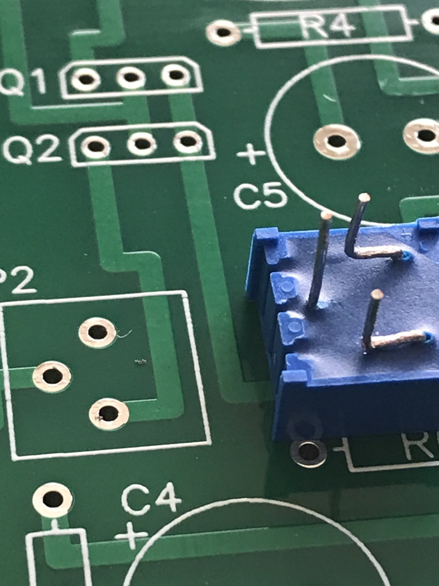

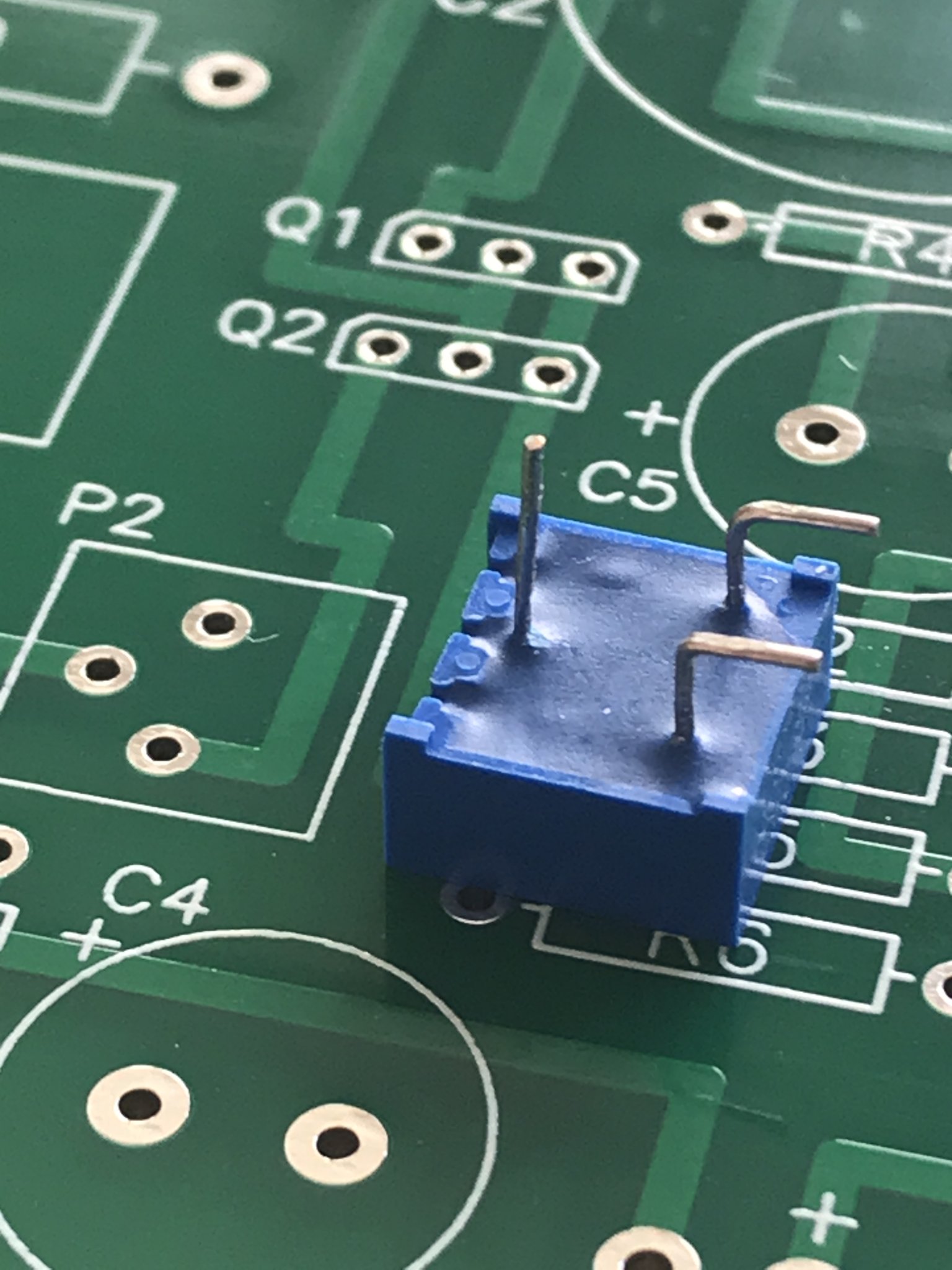

The DIY fix to installing the pots included in the most recent batch of kits is to first make a 90 degree bend on the ends of pins 1 & 3, about 3-4mm, then bend the pins flat against the body of the pot. They will then line up with the hole and fit darn near perfectly onto the board.
Just for the record, it was my clerical error that created this inconvenience. The F looked like a P

The reason I ask is that I bought a second kit and built it two days ago. I folded the pins as you showed, and the fit was fine. But while adjusting VB and VO I find these pots are really touchy. The slightest pressure can have a big effect. The trim pots Nelson sent to me seem less touchy.
In any case, the trim pots that come with the current kits work just fine.

@lastnamenelson the most recent BOM v1.1 from Nelson includes the 2K pots. The earlier iteration shipped 1K pots. I've found both values to be touchy when dialing in VB and VO. They are both made by Bourns.
