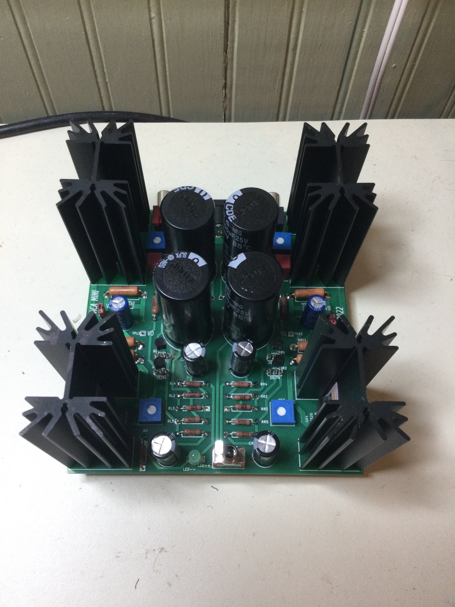

Finished tweaking the bias today after getting a sense of how much it drifted after some warmupand hooked it up in my second system.
Unfortunately, while it makes music, one channel is significantly louder than the other. I’ll be digging into that in the main thread, but wanted to present one more completed amp.

R2 and R3 should be 221K. I can't make out the values the way they are oriented on the board. Let that be a lesson to all builders. Can you verify the values?

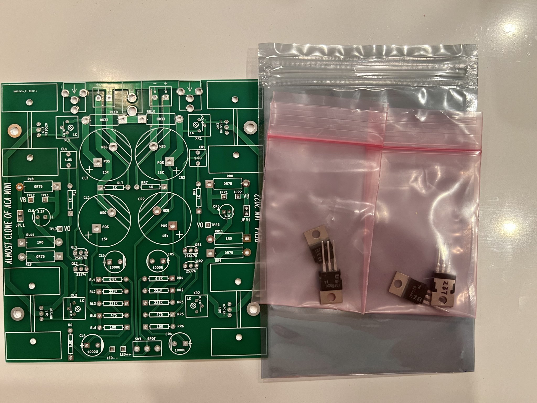

Another board and Fets have safely arrived! If all goes well I will have started my journey to become a Fearless Amplifier Builder by next weekend. I checked all the parts against the BOM and tested values of all the resisters last night. It’s my daughter’s birthday so probably won’t be able to hit the solder station for another week.
Thanks again to Kevin for organizing this effort and our Papa for donating the Harris Fets!

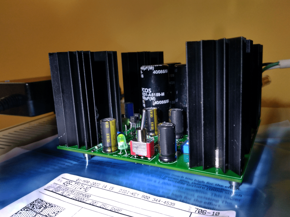

I was able to source everything from Mouser this morning and place an order. Some slight variations on a few items compared to the article BOM, but I think I was able to match substitutions within spec. Excited to build this one.
There were five separate orders needed for the aca mini build. Got it all right except for the 3/4 ohm resistors (missed it by that much). They have been ordered and should be here this week.
Anyway, it surprised me that this clone board isn't exactly like the board in Nelson's pdf or in 6L6's build guide. The LED resistor has moved to under the smaller caps and now resides with the bank of 4 other resistors. Not much of a change really but it made me take notice.
The direction of the FET's has also changed ... in the original artwork the two pairs face different directions but the clone board has both sides to be installed in the same direction. Is this also a matter of being tidy?
Is this just part of the evolution of the board as the project matures?

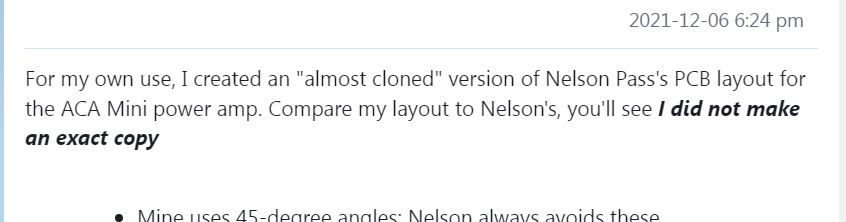

Sounds like you are genuinely surprised that the "Almost Clone" PCB is not an exact duplicate of the one in Nelson Pass's pdf document. Almost Clone. Almost. Hmmm.
Have a look at a thread from December 2021, in the Swap Meet forum. Title was "Free PCB: Clone of ACA Mini -- to a good home"
Never really contemplated the word Almost, just the word clone. For the 50 boards offered in the group buy it seemed likely they would be made using the original artwork. That would have been the quickest and easiest path.
Obviously there's nothing wrong with the clone board and I'm tickled to have gotten one. Just surprised someone went to all the trouble.

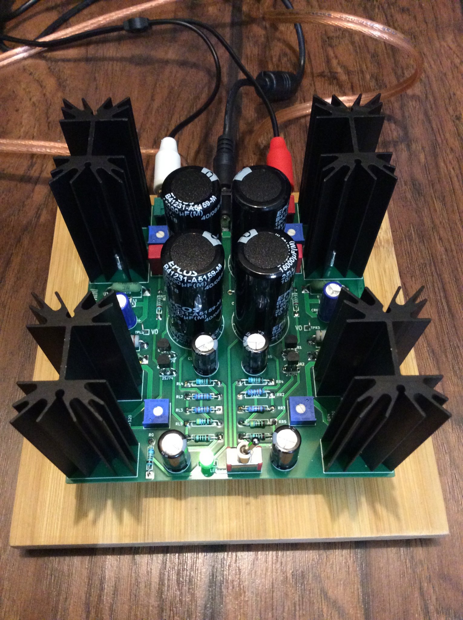

A Huge Thank you too Kevin and Nelson Pass for this incredible amp the Video was a big help with the Bias .
It bought back memories of my F5 bias !
Thanks again everyone! very nice sounding enjoying the Music! working well with a H2 generator as a pre-amp yet even more PaPa awesomeness!
