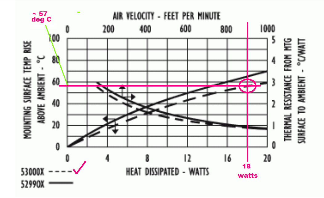

If you are really brave, you can build the original ACA (not this Mini) using these PCB mounted heatsinks instead of chassis mounted heatsinks. The original ACA ran at a class A bias current of 1.45 amperes while this ACA Mini runs at a class A bias current of 0.46 amps. That is a factor of 3 times less current (and 3 times less power).
However if you are really brave, you can juuuuust barely prove that the original ACA on these heatsinks, operates its MOSFETs juuuuuust barely below the absolute max allowed junction temperature (150 degrees C). The heatsinks will burn your finger (or your toddler's tongue) instantly, but the MOSFETs will survive.
The great thing about this is: original ACA can be built with no Toshiba JFETs. You save big money AND you save the aggravation of paying for separate, costly, transistor shipping.
All you need to do is (a) create a PCB layout of the original ACA using this form factor and these heatsinks; (b) perform circuit design calculations which show you how to replace the single Toshiba JFET source follower, with a $0.65 Fairchild JFET source follower, and get the same behavior. Original ACA doesn't have both N-JFETs and P-JFETs, so there's no requirement for matched characteristics between N and P. Just an NJFET and a tiny number of resistors. Plop in the new Fairchild NJFET, plop in your newly calculated resistor values, and Bob's your uncle.
Here's a figure from the engineering datasheet of the ACA Mini's heatsinks. The Original ACA's transistors dissipate about 18 watts, which means these heatsinks will be about 57 degrees C hotter than the ambient air. If the air is 27C then the heatsinks will be at 84C. Ouch. But the MOSFETs will survive, juuuuust barely. And if you're not all that brave you can rig up a couple of DC fans to cool the heatsinks and create additional safety margin. Fans sell for under $10 so you still save big bux.

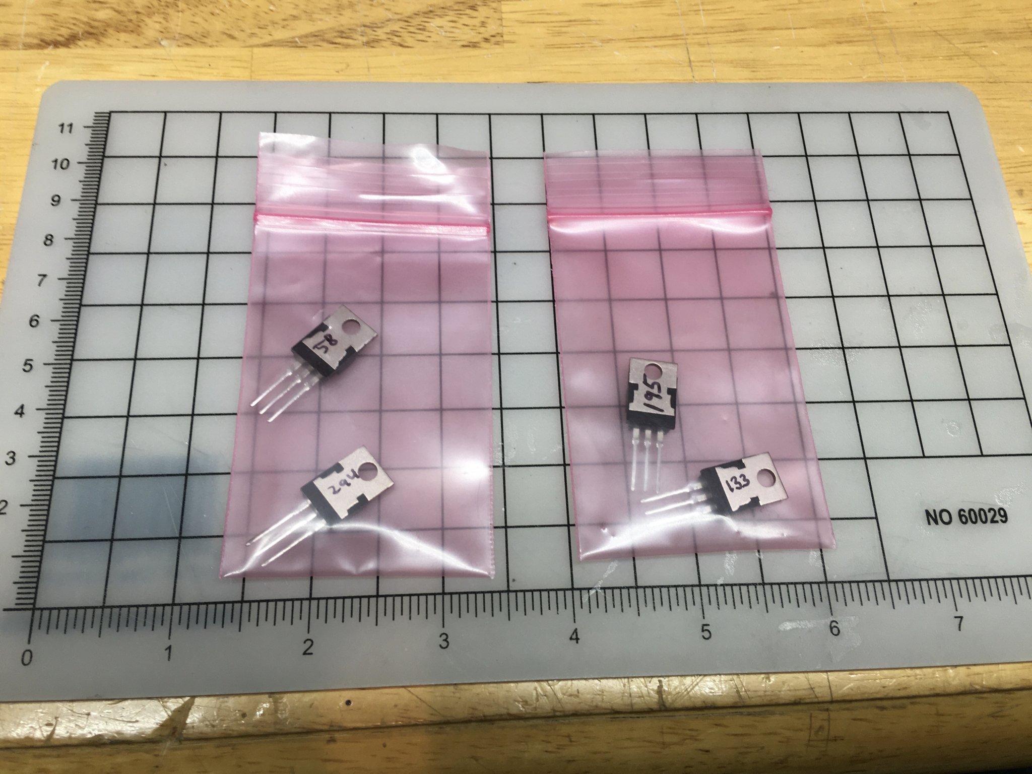

Tomorrow I'll be sending out messages to all members of this group buy. You'll be asked this question: Would you like to receive your boards asap (meaning mailed in the next couple days) OR would you like to receive your boards at a later date with a matched set of genuine Harris 9520/520. Please don't answer in this thread, it will just get messy and I won't be able to keep track.
That's a great idea. Getting the Harris devices would really ease getting parts!
