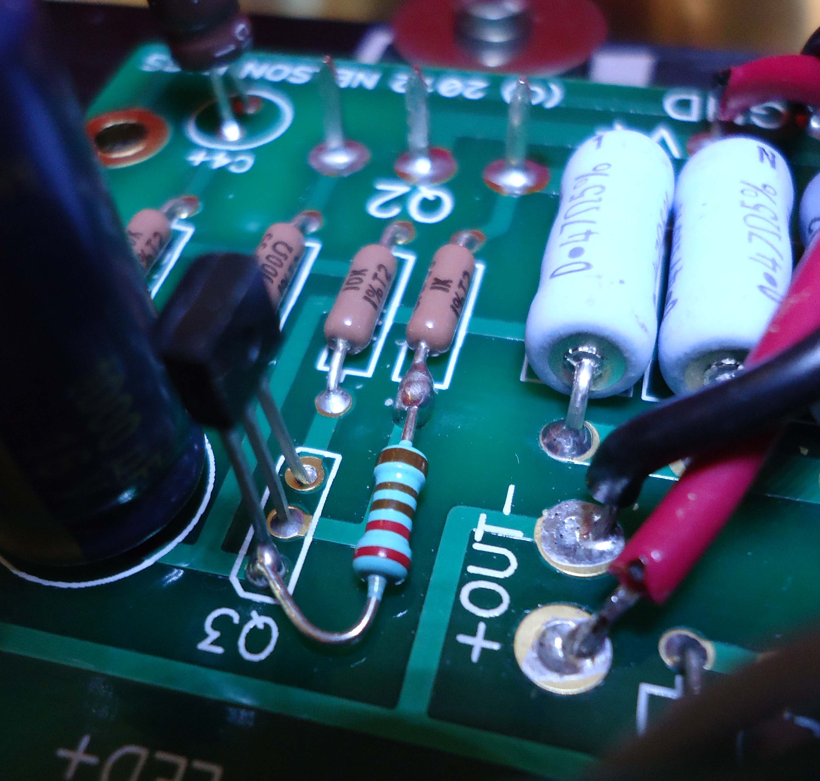

If your PCB has holes for a small resistor labeled R15 then just solder the 2.21k resistor R15 into these holes as you would any other resistor. If your PCB doesn't have holes marked R15, you will need to add this resistor above or below the PCB as detailed right here:
Modification instructions -
The original PCB was found to be need an extra resistor added to get the bias set to a range where the amp will make it’s full designed power and lowest distortion. This is a minor compensation for the particular small-signal transistor (ZTX450) and has been integrated into new revisions of the PCB.
It is going to be very helpful to have a 2nd person to help you hold things in place as you solder.
The end result should look like this -
First take the 2.2K resistor and bend the lead around a small screwdriver.
The resistor will go here - don’t cut anything yet, but try to bend the leads so they go in the approximate correct location.
Trim and solder
Be sure that the resistor lead touches only the first leg of the transistor.
With one end attached to the transistor, bend and trim the opposite lead.
Solder. Repeat on other amp channel PCB.
Trim and solder

Great post. I added my "extra" bias resistor to the underside of the board. It's cleaner looking, and there's plenty of clearance between the heat sink.
