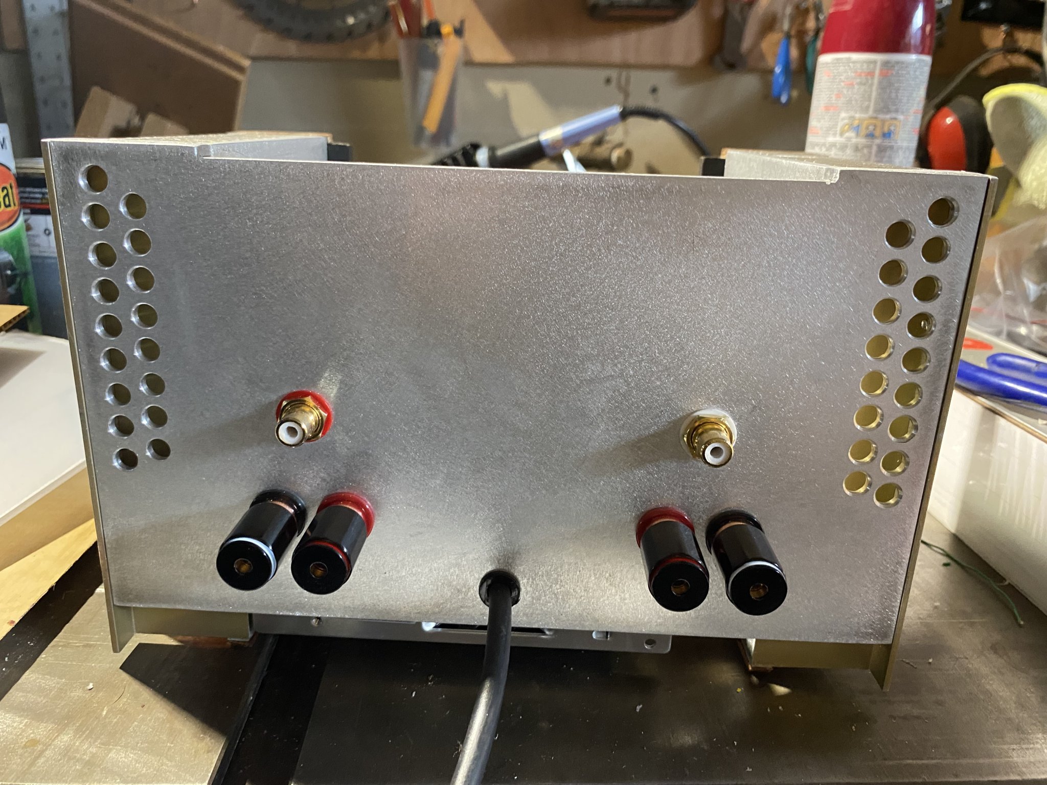

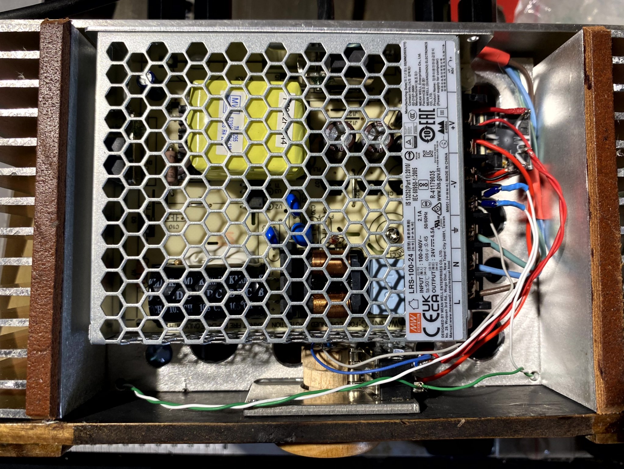

Most of the parts I had, leftover from past projects. I didn't have the active components, so I ordered them from Mouser. I also ordered the Mean Well 108W 24V power supply from Mouser. I mounted it to the bottom of the baseplate (view from the underside of the amp):

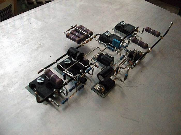

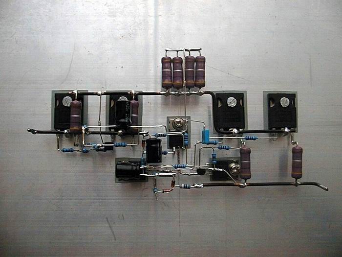

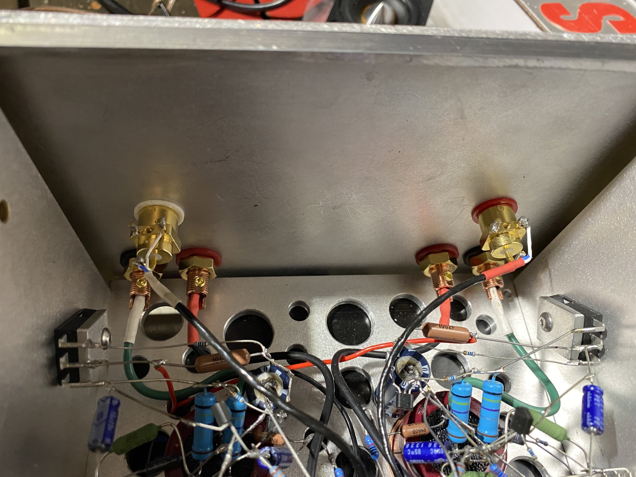

The resistors I had on hand were a potpourri of 1/4W and 1/2W metal film Rs of various physical sizes. It would have been nice to use all 1/2W Dales, but I wired them point-to-point dead bug style (my first attempt), so it was going to look ugly anyway. Most of them were 1% tolerance so they should be fine. Below is a close-up of the PtP wiring. Looks like something you'd find in a dark corner of a garden shed. To my surprise and delight, both channels worked upon first power-up.

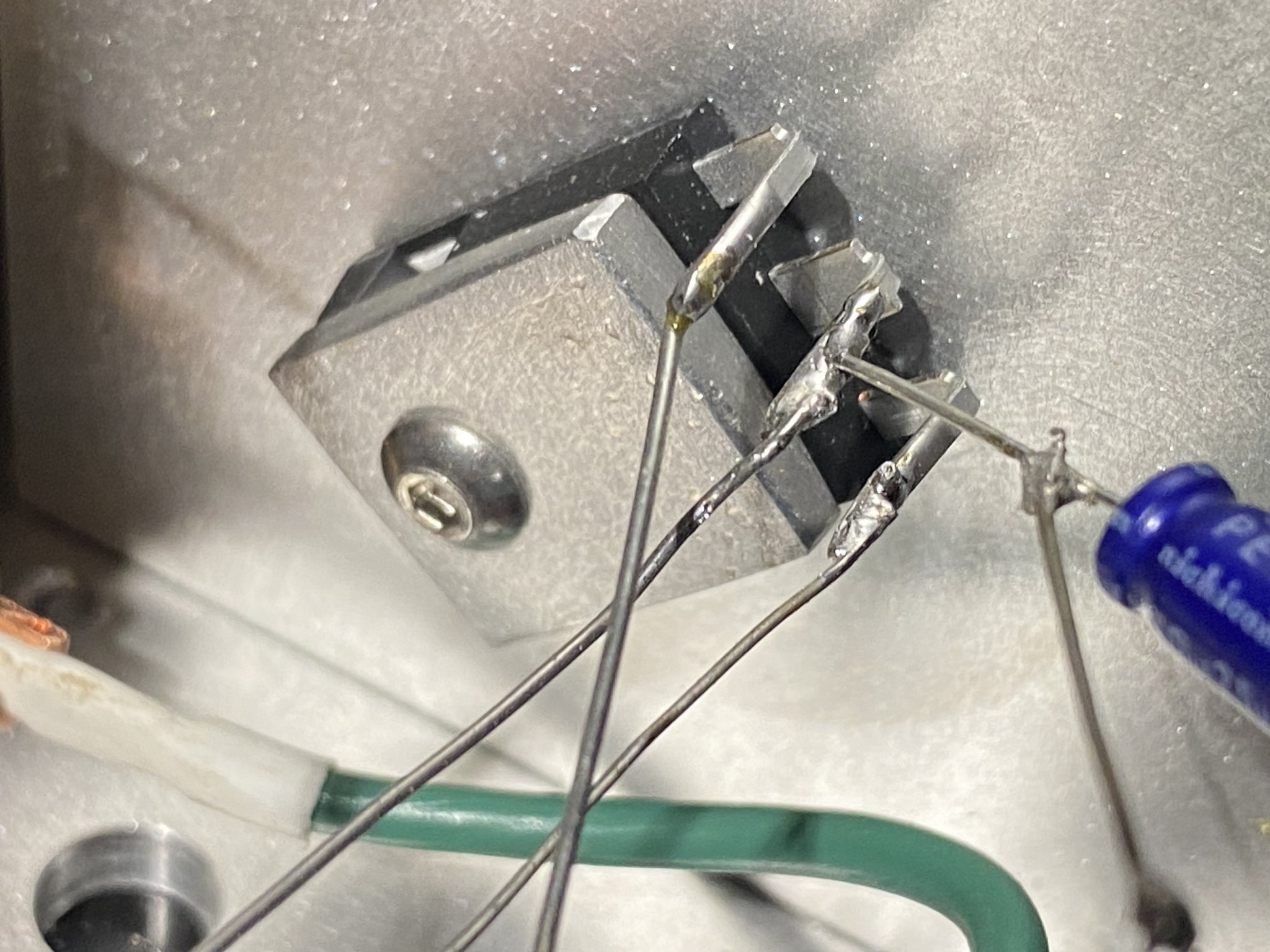

[Pictures are of details/close-ups only because there's an Easter egg of sorts that I want to keep hidden until the final reveal. That Easter egg depends on a part I ordered from Home Depot, which should arrive in a couple of weeks]
Here's an example of the kind of warped thinking that infects a DIYer's brain...
In my boxes of parts I could only find three fender washers to mount the FETs. So, rather than walk or drive a 1/2 mile to the hardware store down the street to buy a fourth fender washer for 15 cents, I used some scrap 1/8" aluminum and fashioned some FET pressure plate things (or whatever they're called):
I think they're called FET pressure plate things.Here's an example of the kind of warped thinking that infects a DIYer's brain...

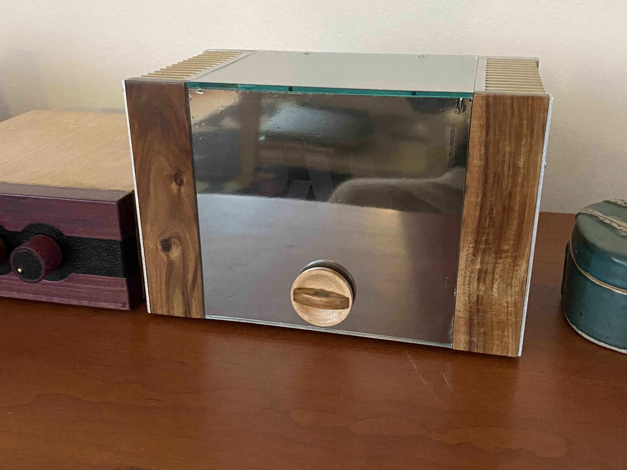

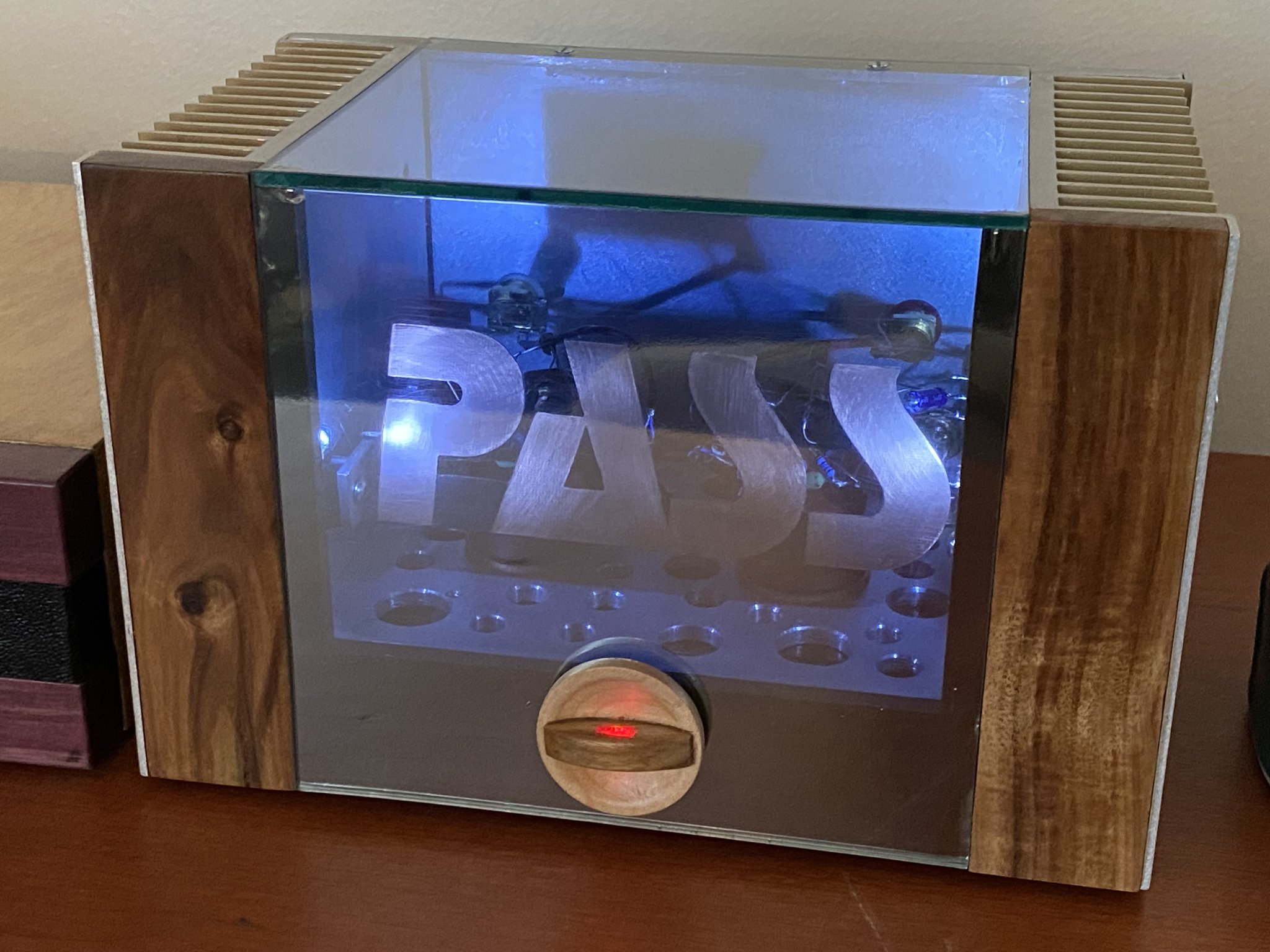

Well, a couple of weeks turned into a month, but the ACA is finally finished, save for a few cosmetic tweaks. Here's a pic of the completed amp:

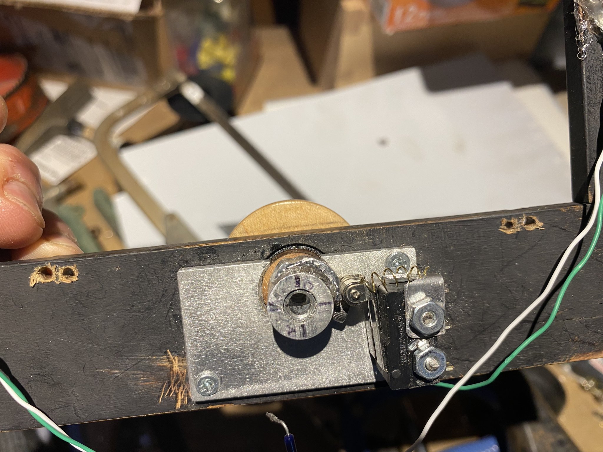

Maybe hard to tell from the pic but the front and top are mirrored acrylic. The most challenging part of the build was the power switch. I swear I've got a compulsion to make things more difficult than they have to be. Here's the switch assembly:

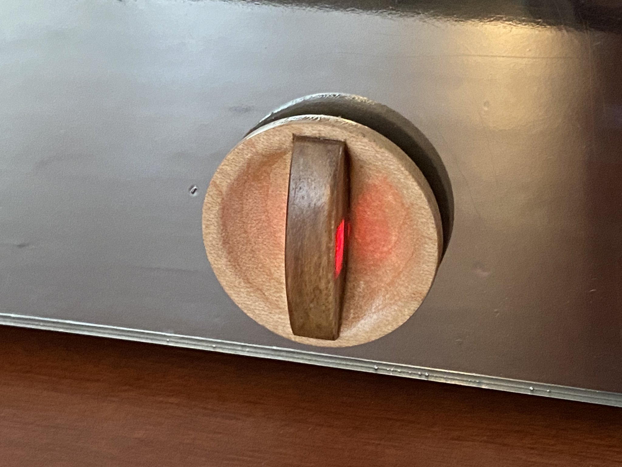

Turning the knob 90 deg. Turns on the amp and the knob glows red (looks better in low light):

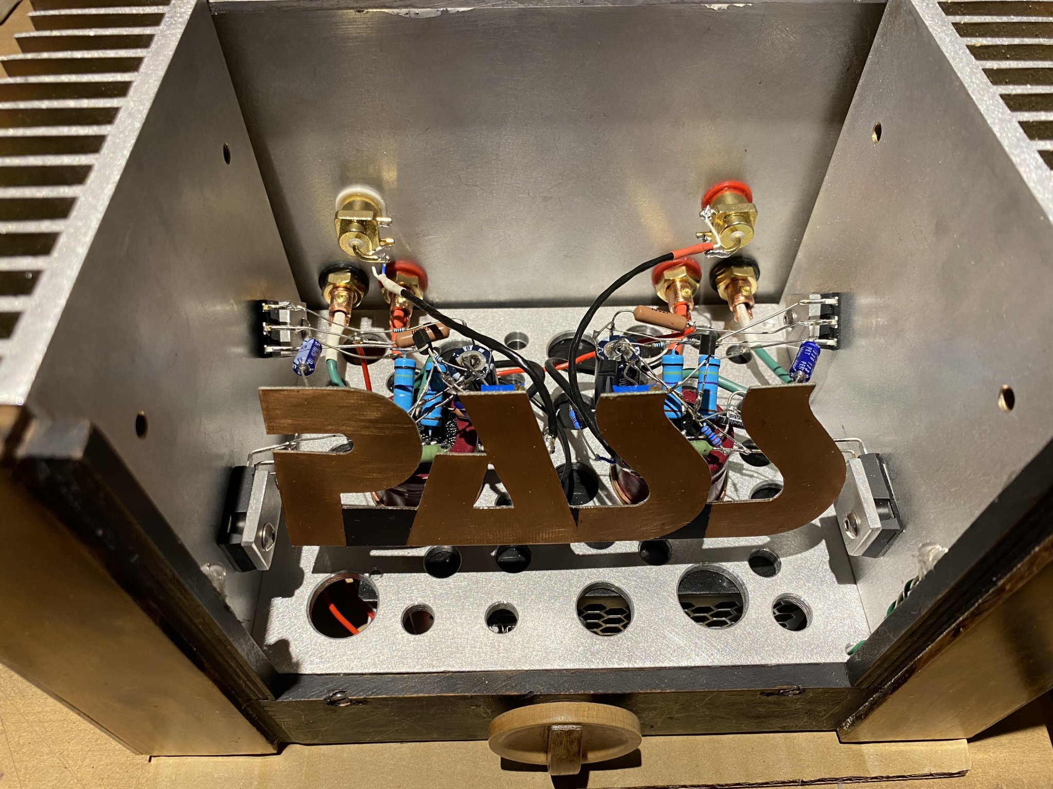

Turn the knob another 90 deg. illuminates the Interior, revealing the PASS logo, made from double sided pcb material and serving as a ground plane for the circuit:
Here's a picture of the guts:

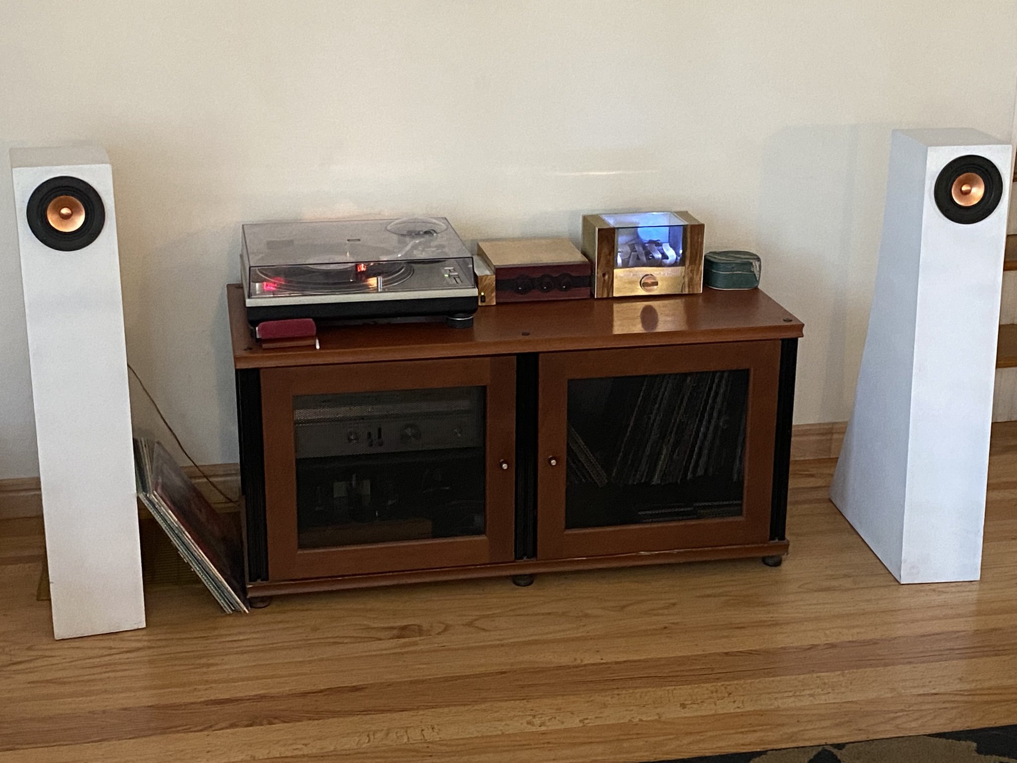

And here's a picture of the amp in its milieu, playing "Lawyers, Guns, and Money" by Warren Zevon:
