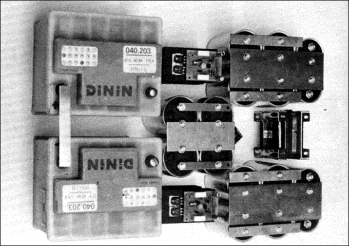

Hi! There is a lot of ideas on ACA PS, but has anyone built Le Monstre by Jean Hiraga? 8 W, 45 Ah car batteries and plenty of capacitors. I did and the sound was quite like ACA, detailed, soft and not so much power.
http://kaschei.com/classa/monster29.htm
http://www.diyaudioprojects.com/Solid/Jean-Hiraga-Le-Monstre/
