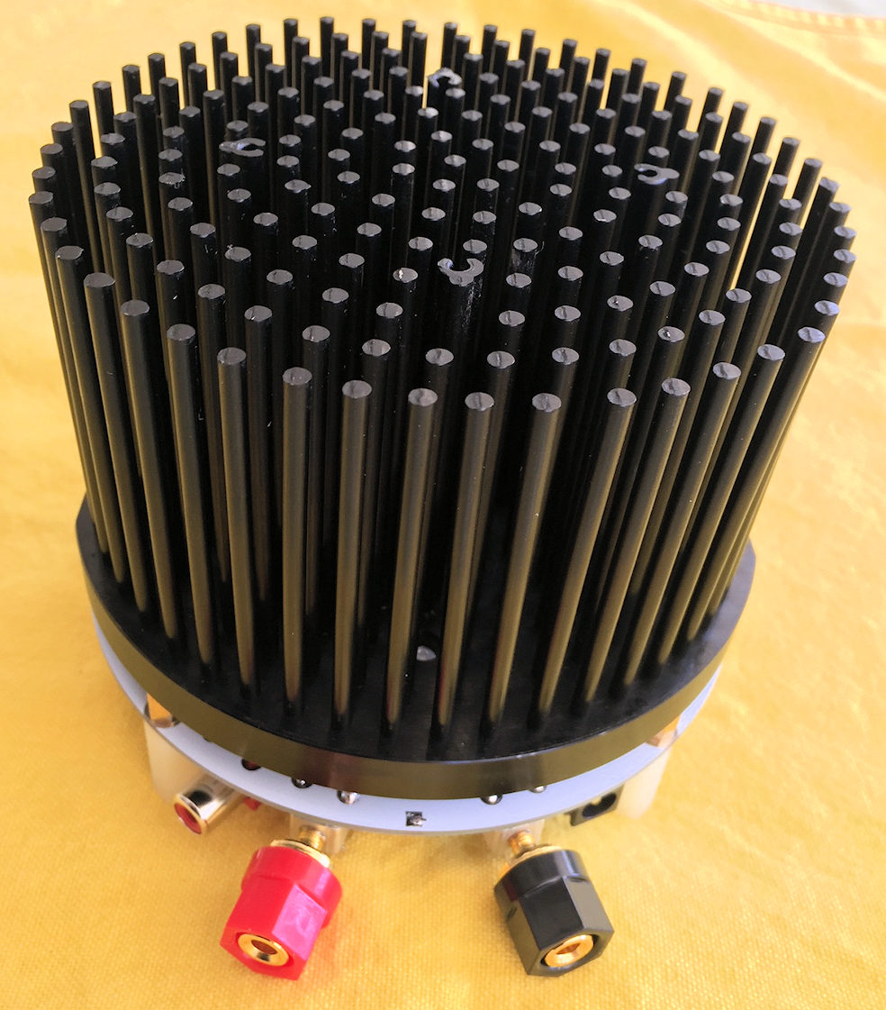

I recently built a pair of the Mark Johnson Racam circular ACA, seemed a cheap and simple build to get me into the low power class A gang. My Aleph 30 unfortunately sits silent due to energy bills and the summer at the moment but it will breath again.!
I use a pair of traco power 100watt 24v PSU that I saw on eBay for £15 each. They seemed a better bet than no name Chinese SMPS. They appear to be well suited and the AC ripple I measure seems impossibly low. Built with 140NPBF for both devices but the rest is as per Nelson's design.
Anyway it sounds very very nice indeed. The gain a bit low for my 86db speakers. Haven't tried with my 83db speakers yet!

RACAM ( Round ACA Monobloc ) is an ACA with non premium parts, plus a fourth order LCLC power supply filter to remove SMPS noise above ~ 10 kHz from the incoming DC. To make a RACAM quieter still, you want something with lots of attenuation at low frequencies, and very low output impedance at low frequencies. Unfortunately, capacitance multipliers have poor output impedance at low frequencies (< 50 Hz) because, in 99% of cases, they lack a high gain error amplifier.
Usually a CapMul is just a series pass transistor (or series pass Sziklai or series pass Darlington) plus passive RC smoothing on the control terminal. So the gain is quite small. For excellently low output impedance at low frequencies you want a voltage regulator and not a capacitance multiplier. Pick one rated for 2 amperes of continuous output current if driving ACA monobloc , 4 amperes of continuous output current if driving ACA stereo pair. The LD1084 chip from ST Microelectronics, mounted on a suitable heatsink with a Keratherm pad, is a great starting point.

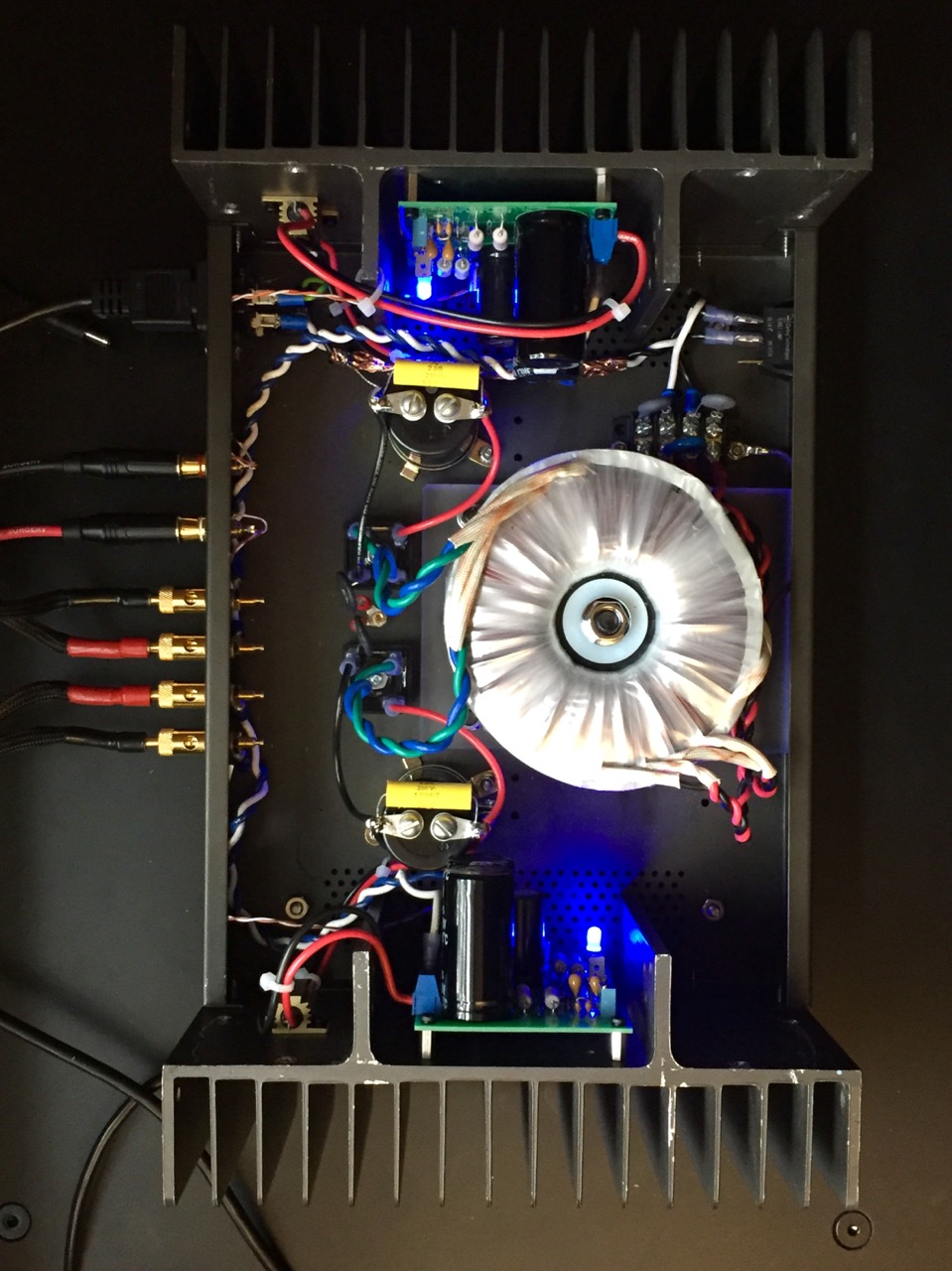

Unfortunately there is evidence that Rudi's boards with the CapMx have some issues in addition to what was mentioned by Mark Johnson. The PCB layout of these is not conducive to low noise performance.
I used an earlier set of PCBs from Rudi that included an LT1084 after a CRC filter. I found that they sounded better without the regulator. (Simple to bypass with a thick wire)

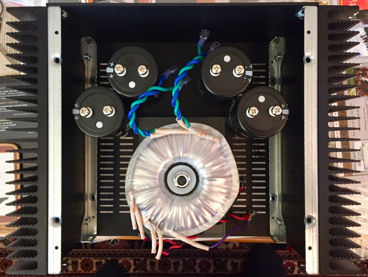

My preferred configuration for the ACA is a linear PSU with a 300VA transformer with 24V or 25V secondaries. Low Vf bridge rectifier and CRCRC filtration. First C is 24,000 uF immediately after the rectifier, followed by 1% 0.5 Ohm or 1.0 Ohm for ease of current measurement. After that a CRC of 15,000 uF - 0.11 Ohm - 15,000 uF.

First, this build will need a larger chassis. The old Hafler DH-220 chassis is excellent.
It could also be done with a Modushop Mini 3U, 350mm chassis.
Point-to-point wiring is make up as you go along.
Thanks! That looks fairly straightforward, but being new to this I’m not 100% sure I know what I’m looking at. Is there a schematic that you used? For the second image, I assume the PSU is standalone, so what are you using to connect it to the wall and to connect the ACA to it?
If you are very new, then you need to know that building a linear PSU with point-to-point wiring can expose you to 120V AC. Not something you want to touch. I have done lots of this type of construction, so I know how to do it safely. You need to evaluate your skill level, and possibly re-consider your risk vs reward. The ACA with the extarnal 24V SMPS brick is a much safer option.

Rotated the trannie 90 degrees getting the ac to run down the middle. Twisted the secondaries to the boards, added 18,000uf 35v cap on output of multiplier. Hum is reduced can hear 6 ft away but not from listening chair. Will call this good for now,replacing the crc resistors will be a pain. Now the big question for Tungsten, out of all the pass amps I own why do I rotate back to this premium aca with the fqh44n10 and irfp140? The soundstage is massive and all the instruments have been sprinkled with fairy dust! Everything else is good but meh in comparison. Extra H2? Bubba
