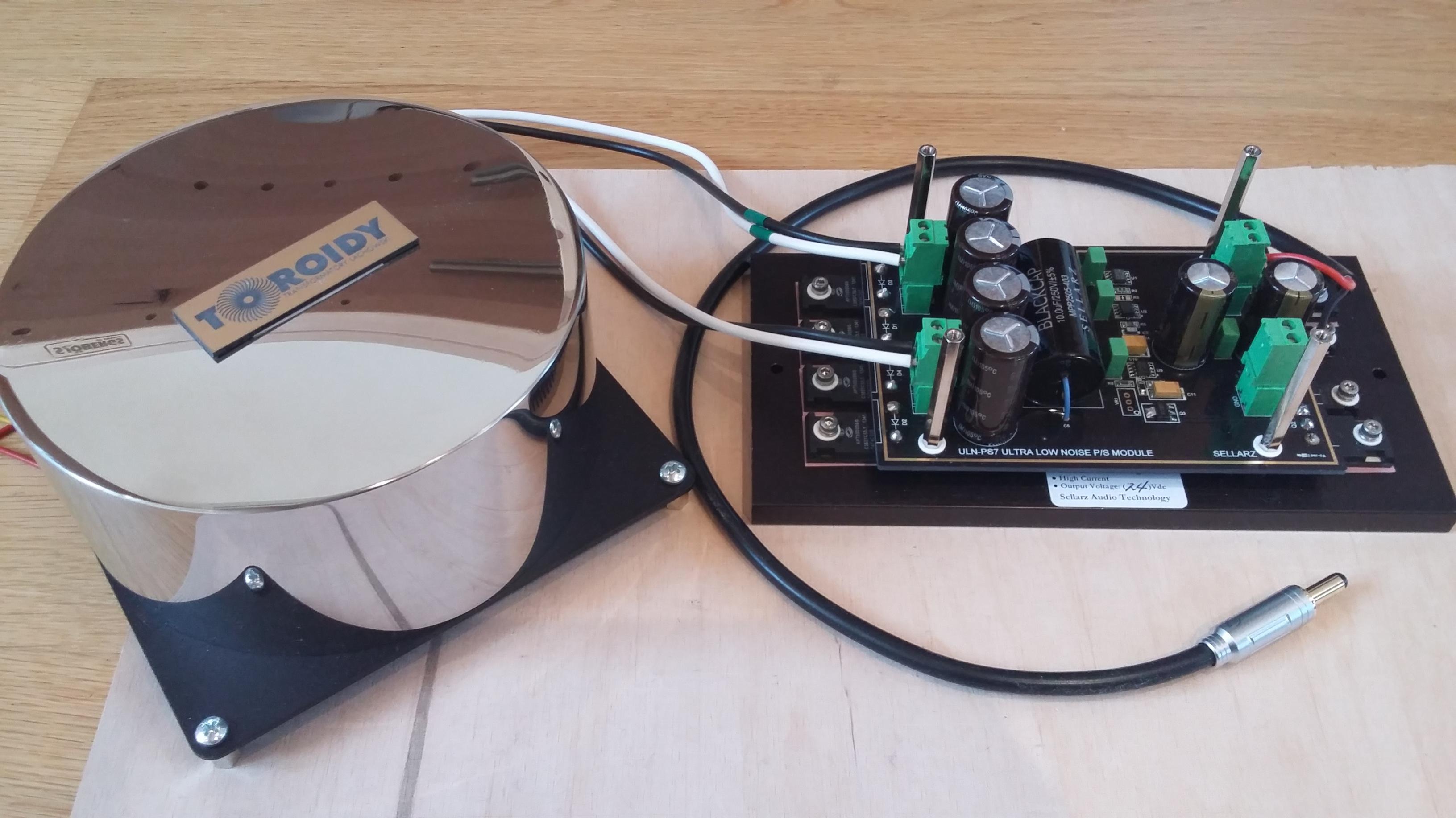

Possible Discrete Regulator for ACA
If I were to build a discrete regulator for one channel of an ACA, it would look like this:
I built four of these boards for my DIY version of a dual HiCap DR. (They are serious overkill for that application, in keeping with Naim standard practice for their separate power supplies.) The heatsinks for each of the output MOSFETs are 50mm tall. The rectifier diodes are MUR820, which I would probably replace with a chassis mount 35A, 200V bridge rectifier, as is best practice for the DIY First Watt amps.

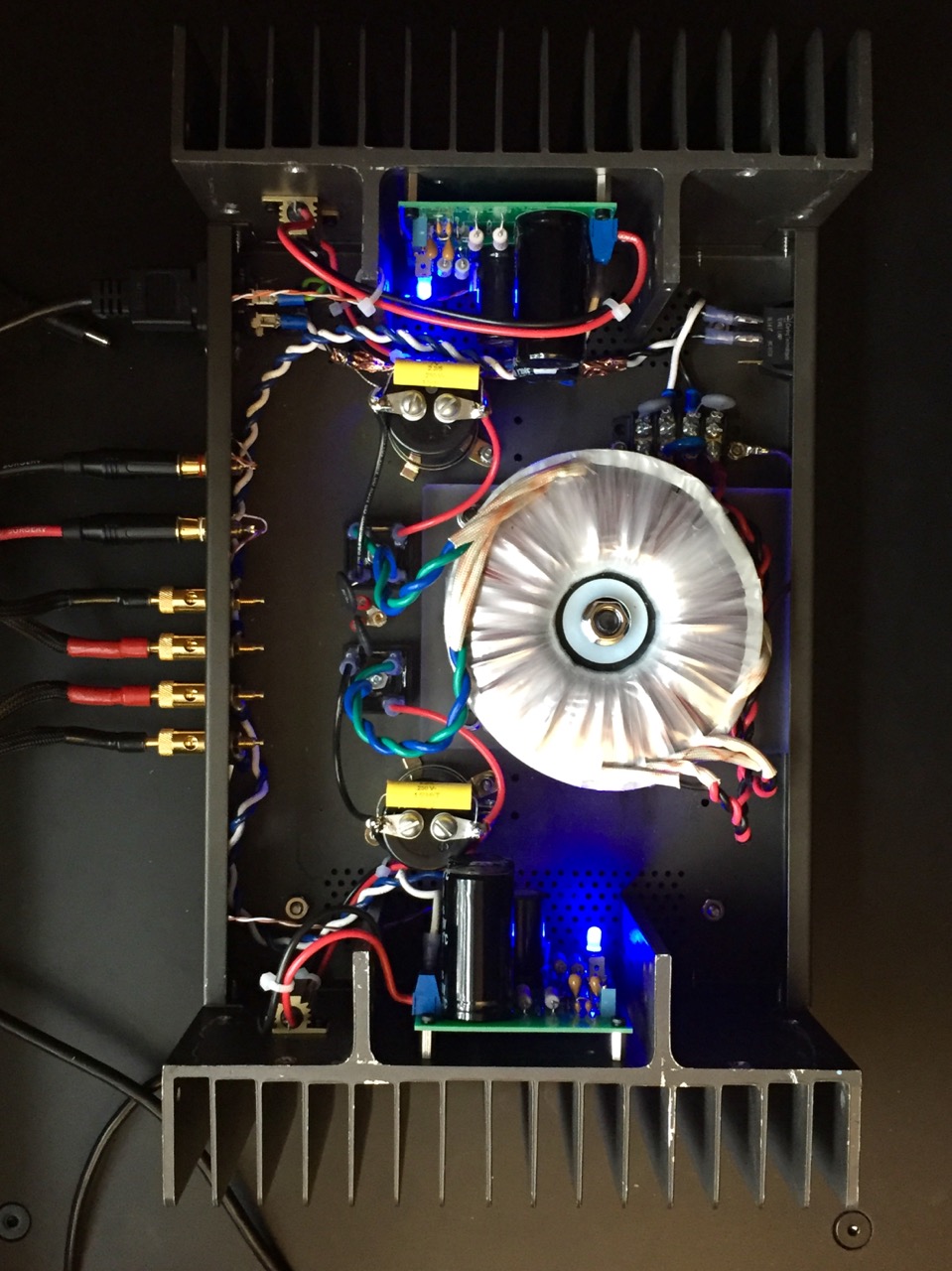

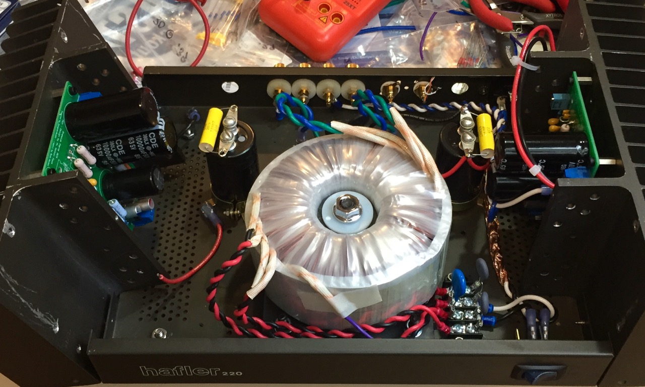

It Lives!
A few years ago, when I was working on my first set of Hafler DH-220 mods, I ran across a tidbit from Papa about the possibility of modifying the DH-200/220 circuit to run at Class A on lower voltage rails. Sadly, this idea never came to fruition, as the standard power transformer was only wired with a single primary and didn't offer an easy way to halve the voltage supplied to the driver boards. If anyone ever tried this idea with a substitute transformer, I never saw the write-up on the Diy forums.
Well, here is another solution – simply gut a Hafler chassis and drop in a shiny new ACA with a linear power supply! 😉

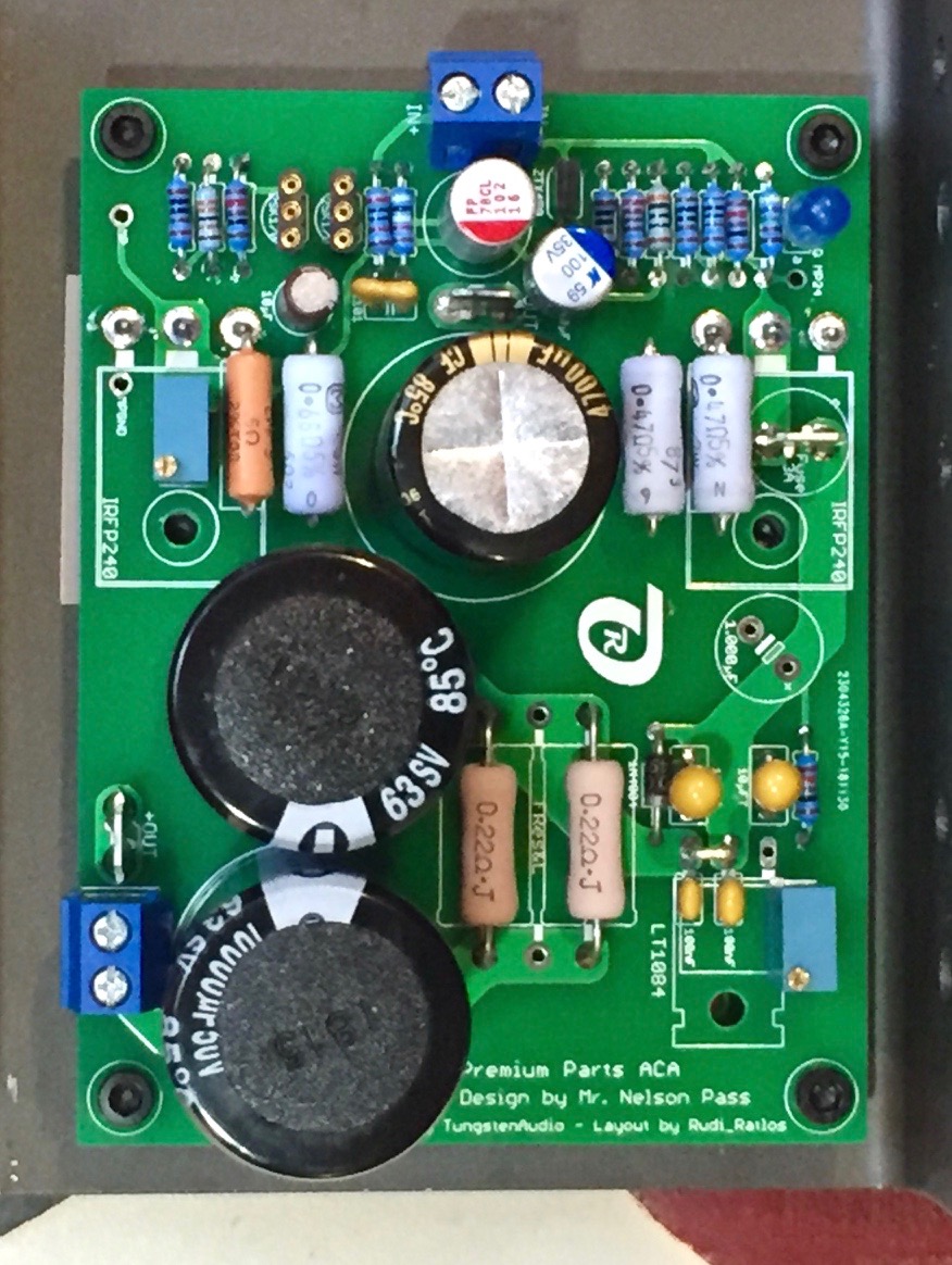

For a new set of PCBs to make this possible, I have forum member Rudi to thank. He was eager to try the "Premium ACA" circuit in a dedicated PCB with support for couple new features. We spent some time collaborating on the layout – that is, he did all the work as I kibbitzed from the sideline. We now have a small set of prototype PCBs that I will use for exploring various ideas over the next couple months.
I spent a few hours with it last night, and am very pleased with the results. First of all, there is no turn-on or turn off thump or other noises. The amp is completely silent until music starts playing. (So silent, that I wondered if it was working when it was powered up with speakers for the first time.)
And the amp sounds like the ACA that I have come to know and love. This build benefits from a dual-mono power supply, and presents the same three-dimensional sound stage that I've been enjoying from my parallel-bridged amps. While it is still breaking in, the absolute blackness of the background is doing a wonderful job of letting each recording come through with great detail. It is also simply a pleasure to listen to, as are the original ACAs.
My short term plans call for a simple voltage boost to the power rails. They are currently running at 23.7 Volts, with quiescent bias of 1.57 Amps and voltage bias of 12.2V. The first R of the CRCRC filter is dropping about 3.5V, so there is some headroom to work with. Even with a total of 37 Watts per side, the heatsinks are just nice and warm. I have another Hafler donor chassis waiting for a second build, and also have two of the Modushop mini 3U Dissipante chassis on order. Further experimentation will involve higher voltage transformers as well as a couple different sets of enclosed SMPS power supplies followed by linear regulation.
I'm looking forward to much quality time with this wonderful amp. Thank you, Papa.
