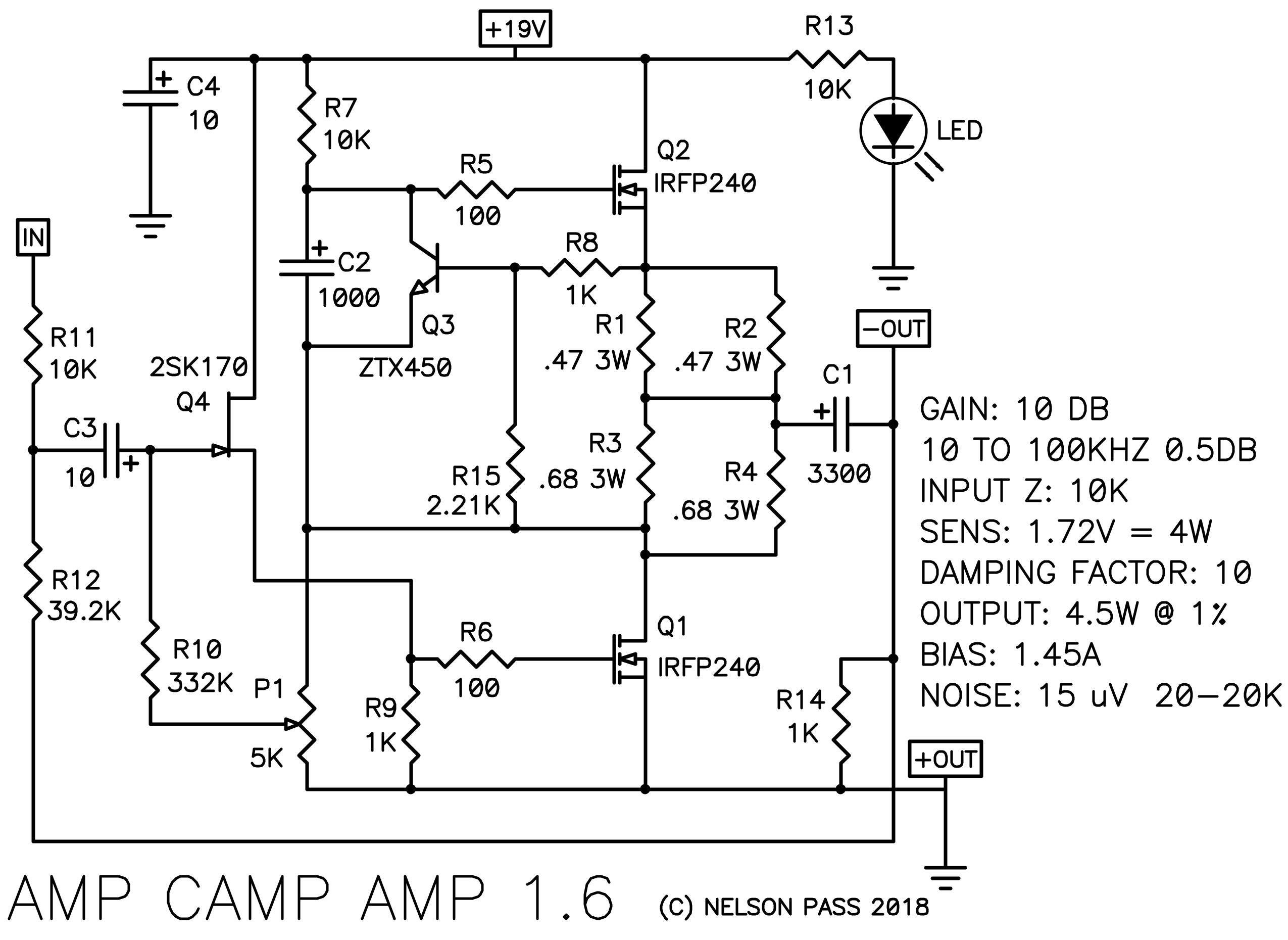

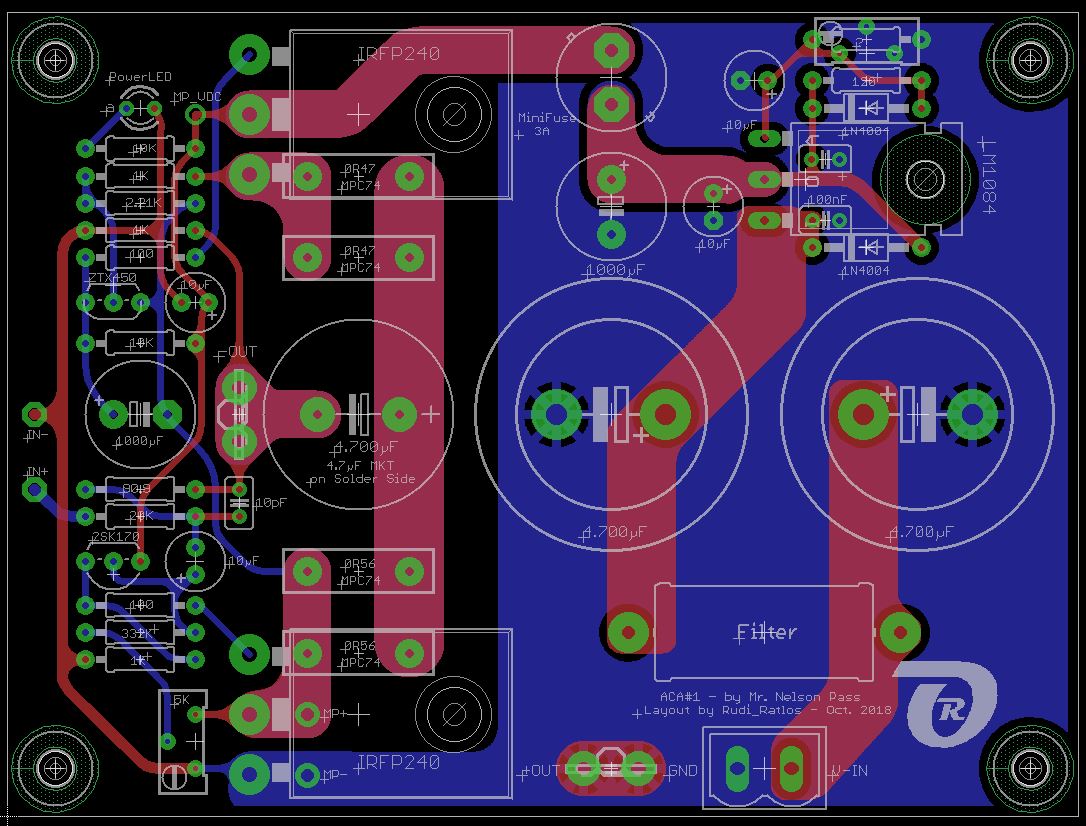

James, I have in the meantime drawn a layout for "one-half of a bridged ACA" (according to your proposals) and have already soldered and listened to a prototype of it.
I am driving this ACA from a 24VDC regulated PSU, consisting of a 2x19VAC/160VA torroid, full bridge-rectifier (mounted on the heatsink), 10mF reservoir caps
and LM1084 regulator, adjusted to 24VDC.
I would never think about driving a ClassA AMP from a SMPS. 😱
This ACA alone already plays beautifully, but I would like and bridge it , same as you did.
Can you please tell me, how to proceed with ACA#2?
For the ACA#2 I need an inverse input-signal (which can be derived from the output of ACA#1).
Is a "bridging resistor" (value: 68,1K, from where to where?) all that I need?
Don't I need a resistor-divider (same like in feedback)?
Once I am done with my "bridged-ACA", I will happily send you a pair of my PCBs.
Best regards - Rudi_Ratlos

it's not trivial , but certainly easier than it looks

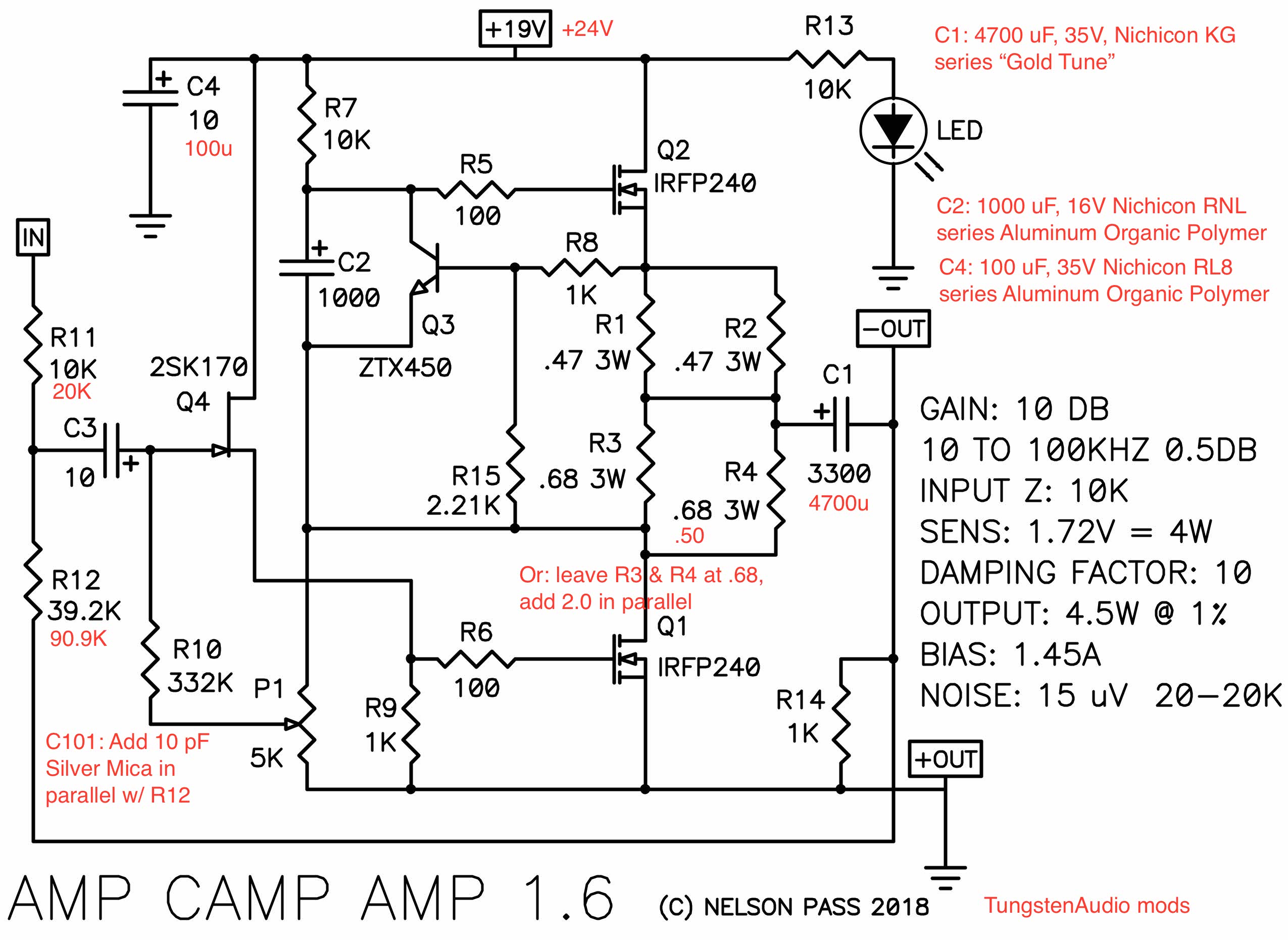

I changed the input resistor R11 to 20k and the feedback resistor to 90.9k.
So now R11 is 20k and R12 is 90.9k?
Shortly after making this change, I also added a 2.0 Ohm resistor in parallel to R3 and R4,

Nice work, Rudi!
I like this layout and use of integrated VR.

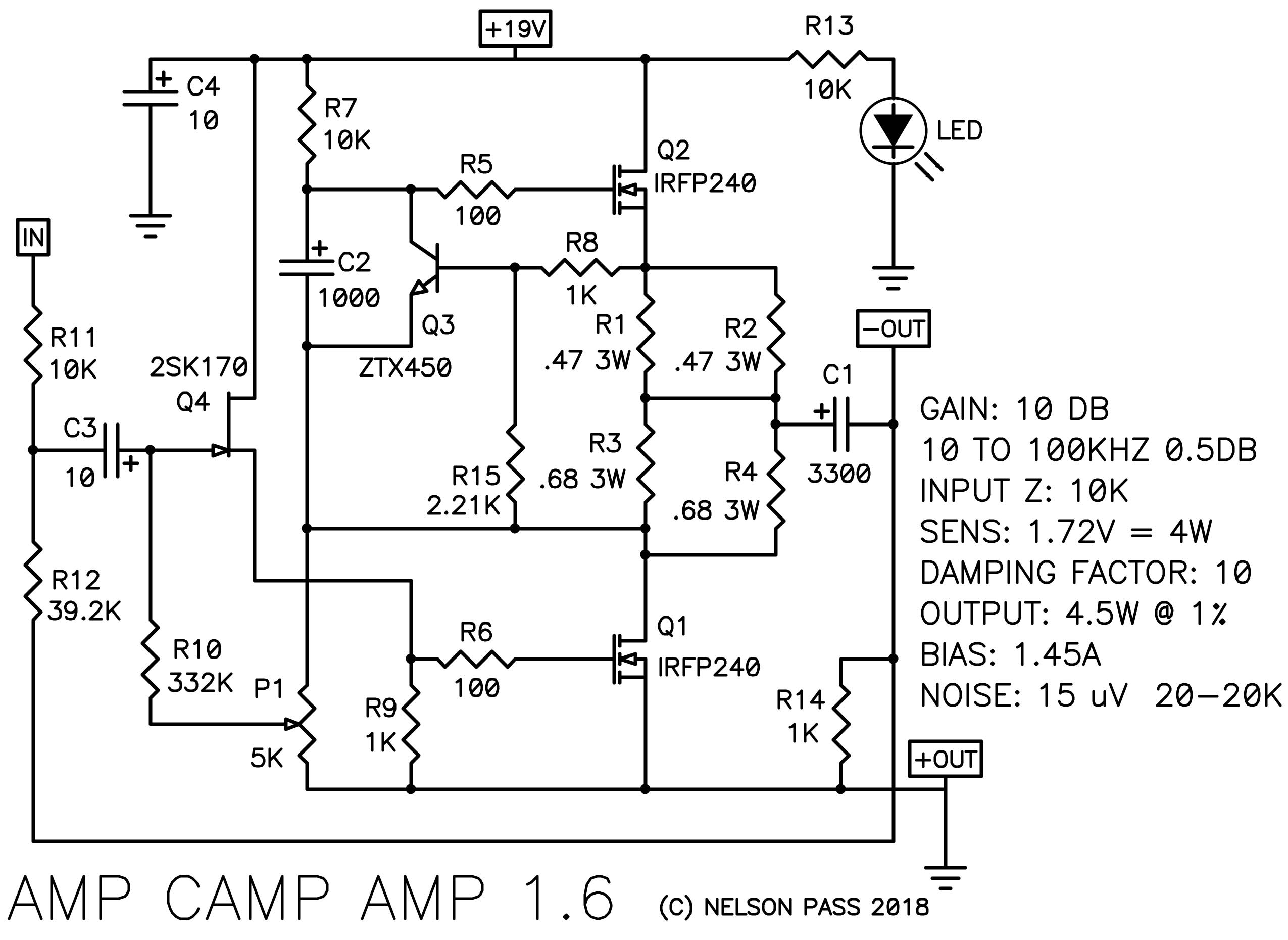

With the new ACA kits becoming available, I wanted to post this for those who might be interested in performing a few 'tweaks' to what remains an excellent design.
I have found the modified design to have improved clarity and spatial detail. I will also not that one of the best things to do with the modified design is to build two complete kits and run them as bridged monoblocks. Using a separate power supply for each channel makes very noticeable improvements in dynamics and imaging.
If one has chosen to use single-ended inputs (as I currently have), a bridging resistor of 68.1k Ohms will be necessary. Please refer to the ACA build guide and previous posts in this thread for the installation of the bridging resistor.

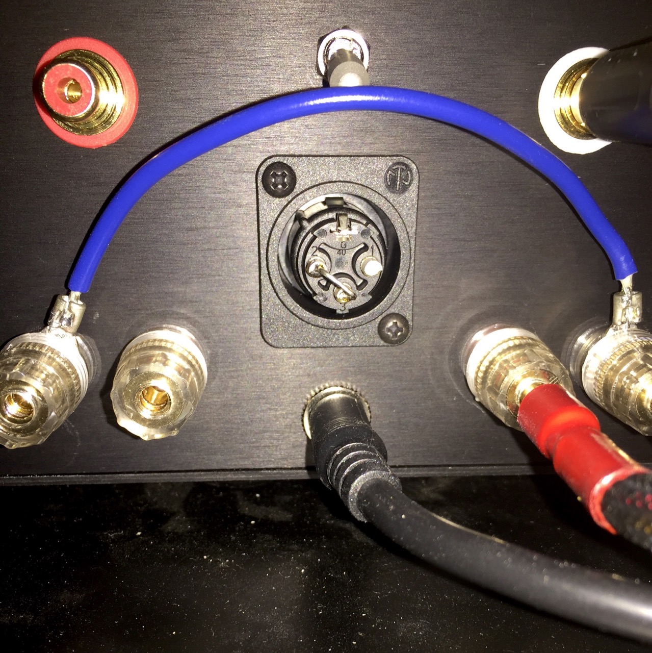

The way I have wired my bridged monoblocks allows the bridging resistor to be removed by flipping the toggle switch on the rear panel. This allows them to be run as individual stereo amps.
With some clever external wiring, a pair of stereo amps could be made to function as parallel monoblocks. A 'Y' adapter for the RCA inputs and some banana plug jumpers to connect the speaker outputs in parallel... I haven't tried this yet myself, but I don't see any potential issues. If anything, the 20k input impedance will help make the modified boards easier to drive when they are wired in parallel. I will leave this to the readership to discuss.

1. The values for R11 and R12 quoted above are correct. Also, 0.6W metal film will be fine for these. Adding the 10pF Mica cap in parallel to R12 might be difficult. You can certainly try the boards without this extra component. It is there to smooth out the top end when the amps are being driven close to full power.
2. R3 and R4 share about 1.5 Amps between the pair. They should be larger than 0.6W to provide some safety margin. I would suggest a minimum of 1W, and preferably 2W or 3W for these locations. The same recommendation applies to R1 and R2 as well, 2W or 3W preferred.
3. The Nichicon KG series cap that I used for C1 does have snap-in leads and is a direct fit replacement on the ACA boards from the DIY Audio store. The Mundorf cap that you link (4700 uF, 40V MGLO) also has a 10mm lead spacing and should fit into the board as long as there is no interference from other components. I am not familiar with the earlier ACA-Cap-multiplier boards from Rudi, so you will need check the clearance on these.
The Mundorfs should sound just as good as the Nichicons. I have actually considered using them myself on other boards where there is plenty of room. I expect that they will take about 20 hours of play before they break-in and start to sound their best. The Jantzen electrolytic caps that I have seen are high voltage and quite large. They seem to be intended more for vacuum tube amps.
My general preference when making component substitutions is to use parts that easily fit onto the original board. This is partly from my experience as a product design engineer, but also from seeing what can happen when bent leads eventually break from fatigue when components are not well supported. I have been known to use hot-glue to provide some support to dodgy dead-bug and flying lead component installations. Strictly for prototyping and one-off builds, of course. 🙂
