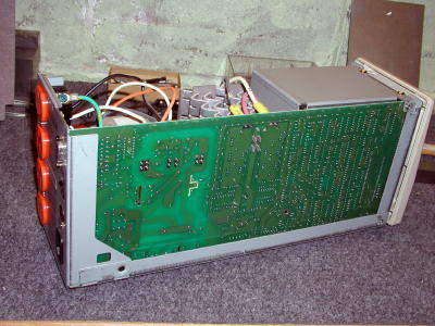

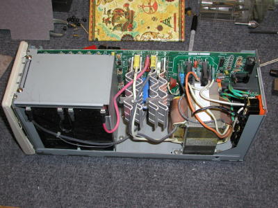

I just bought yesterday computer backup power supply. Surplus price was CAD$80. It is 400VA unit, using 2 batteries. power amp and big transformer, basicalyy the stuff we were talking about at the beginning of the thread.
I connected all source components to it and I can say that there is improvement in the sound. The background is blacker (seems like less noise around instruments), better bass definition and rhytm, more detail meaning that bacground vocals are more articulate.
When I tried to run it from batteries only I didn't like the sound at all, there was no comparison.
Overall sounds like a good deal to me. Now I have to find a way to increase frequency from 60 to 100Hz.

HPotter, the waveform from an UPS is generally considered woeful. When feeding a computer’s switch-mode supply this doesn’t really matter, but clearly defeats the purpose when feeding audio. When the mains AC is connected it also serves as a filter, probably leading to the improvements you mentioned.
Pete
Pete
You could probably just have a look at the one you have and build the filter part of it, as that's what's doing the work at the moment. However for that price it would probably cost you more to build your own v just going out and buying another.
