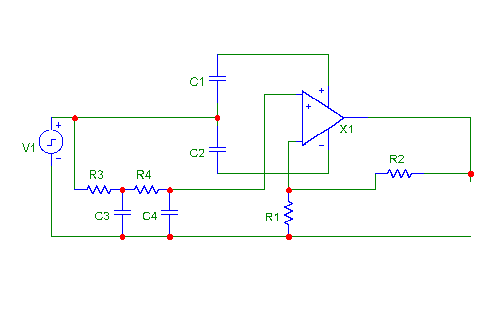

jam said:Fmak,
In this design I don't see a slight drift in frequency as much as a problem. All we need is a pure sine wave. There are several modifications to the Wein-Bridge circuit that improve its performance . I recall the use of a fet in place of a thermistor or light bulb.
On the other hand I am open to any suggestions you may have to help Peter out.
You will get a very low D sine wave with this. The problem is instability when you want to change F. I don't know what this may do to amp.
Why just 400 Hz?

Why not just use a generator to get your higher freq? You could just take a normal 120V generator and crank up the RPM so you get higher frequency and voltage. You can then reduce the voltage to whatever.
Harry,
What kind of bulbs were you using in your circuit and what amp would be best for that? Maybe I should built one more Aleph?😉

Bulbs... I will have to reseach that one. Highest voltage lowest current minature bulbs with leads that I could find at Radio Shack.
You want the highest resistance measured with a VOM that you can get to make the feedback a reasonably high resistance for the op amp to drive. I will try to figure out what I used. I would buid a big Class AB amp with at least 50 volt rails. The turns ratio of your output transfomer will determine the swing needed by the amp.

New (?) idea:
How about regenerating the ac line by a small added signal ?
--> only rel. small power amp needed, if max. distortion on line is about 10% and system power cons. about 200W, a 25W amp would be sufficient to clean the ac line and lower the virtual impedance of the line. What do you think about ?
(added simpl. schema.)
alf
alf
