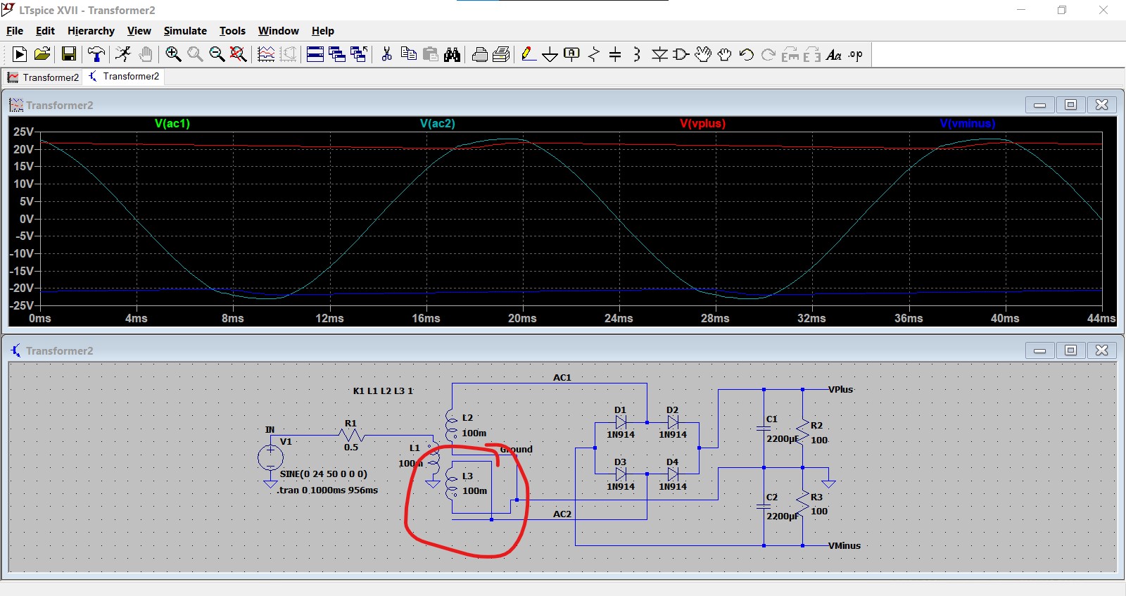

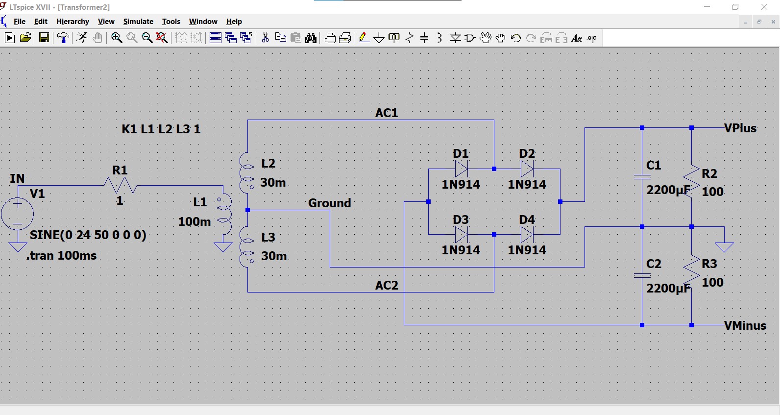

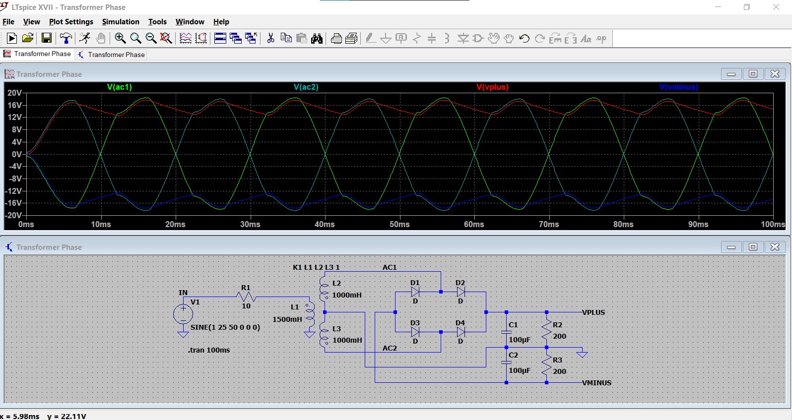

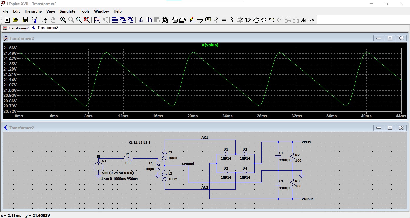

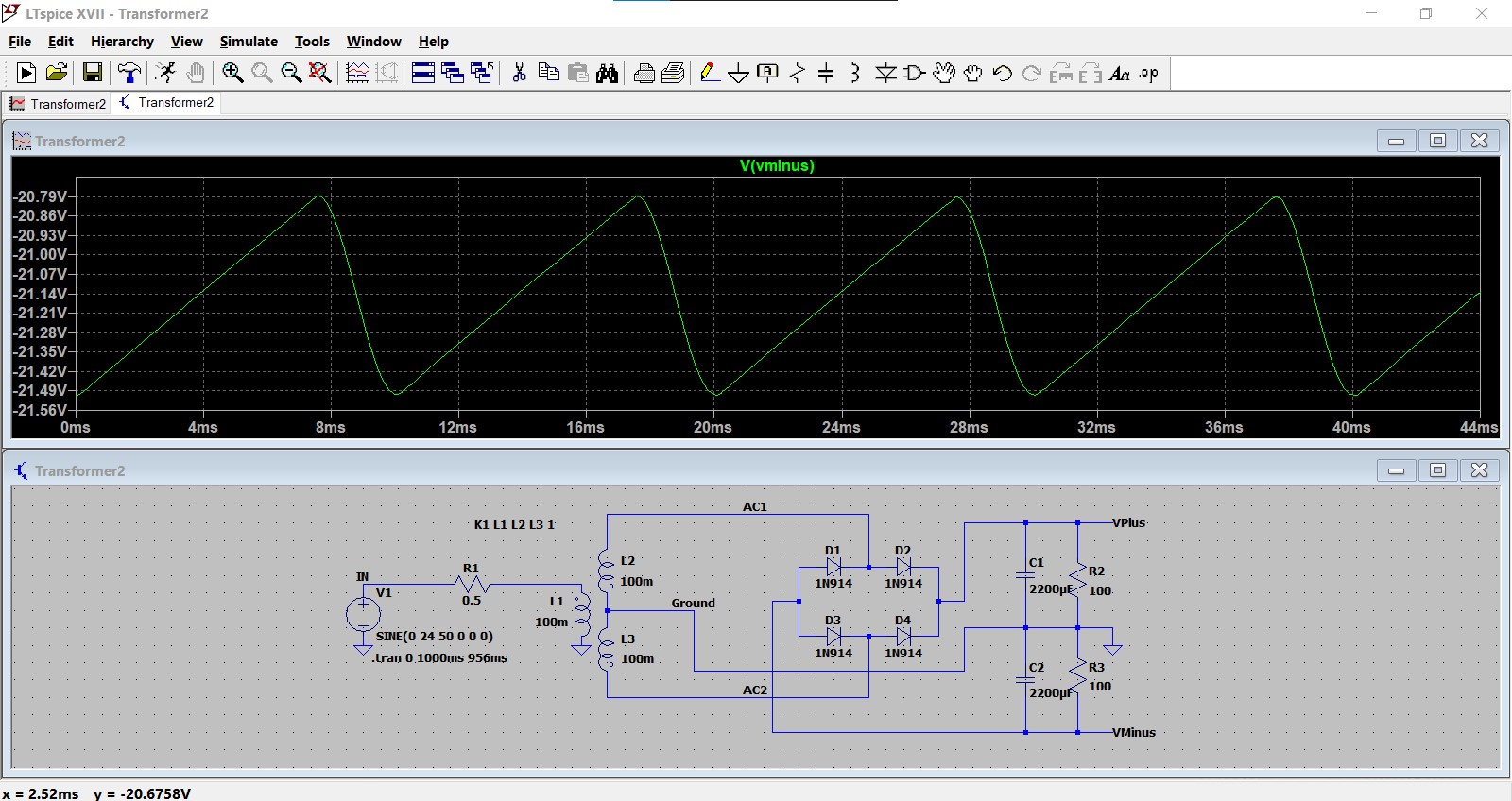

This is a working simulation of a power supply like yours. Look at the four points marked AC1, AC2 VPlus and VMinus. These are shown on the scope traces at the top.
Look at the ripple voltage and the frequency. There is 10 milliseconds between any two similar points. Frequency is 100 Hz.

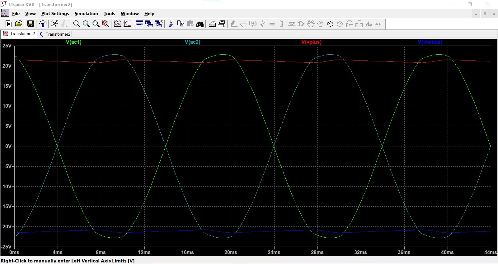

Now look at the two AC voltages. The phase is 180 degrees apart. There is now 20 milliseconds between similar points meaning the frequency is 50 Hz.
If we put it all together and show all four traces we can see the relationship between them all.

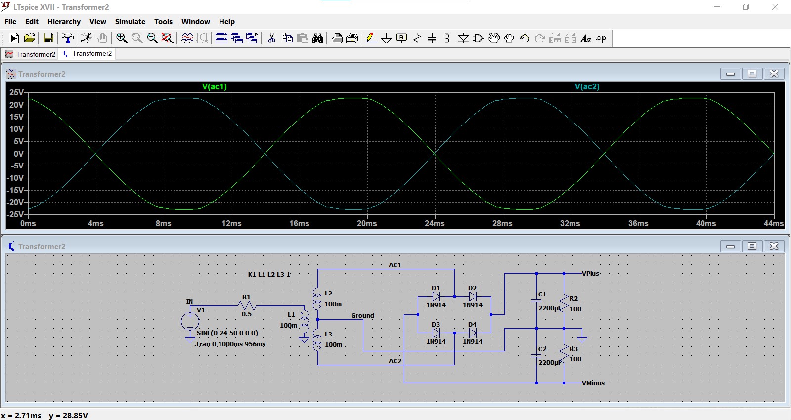

If we reverse the phase of one winding we get 50 Hz ripple and not 100Hz. The two AC traces are still there but now overlay one another. They are now in phase. Image 6.
(your meter reading test shows this isn't happening)

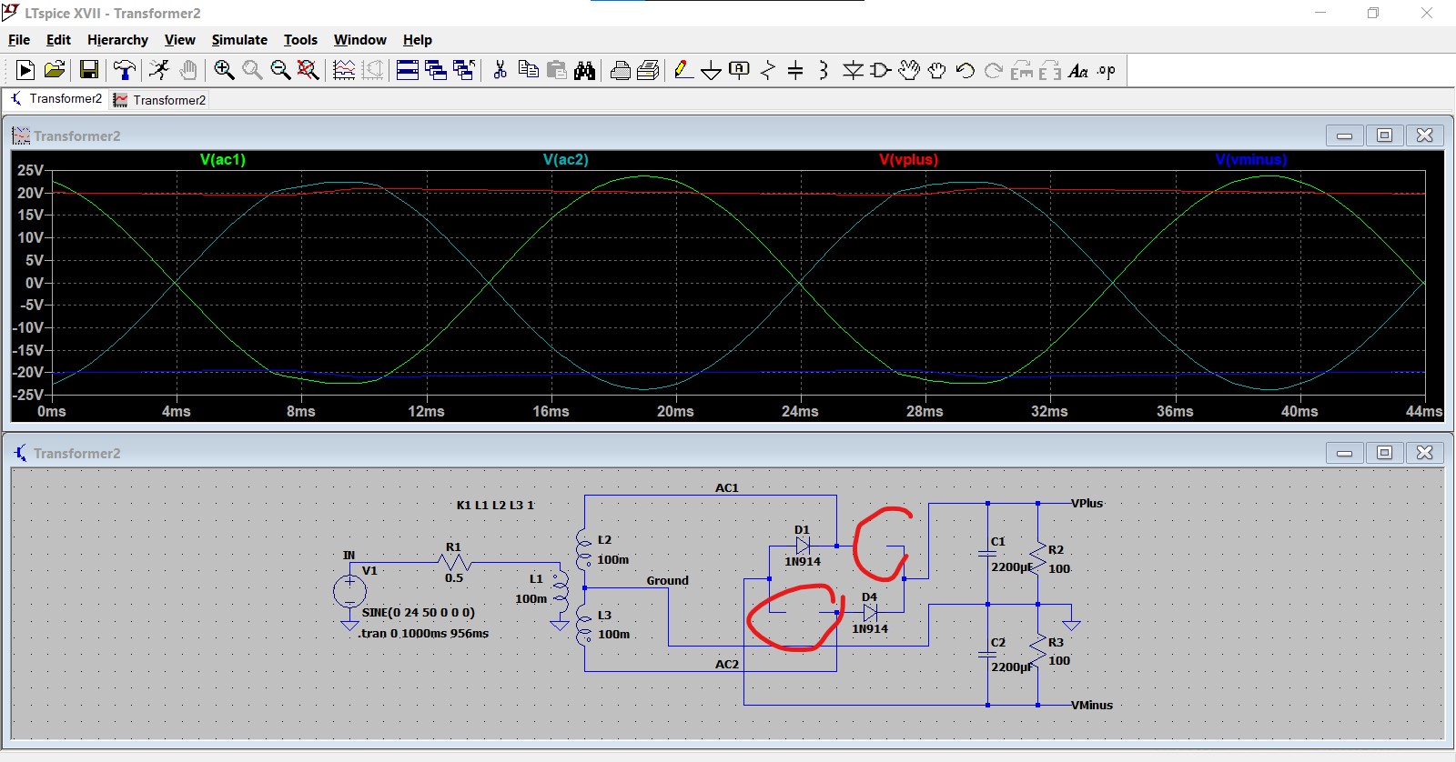

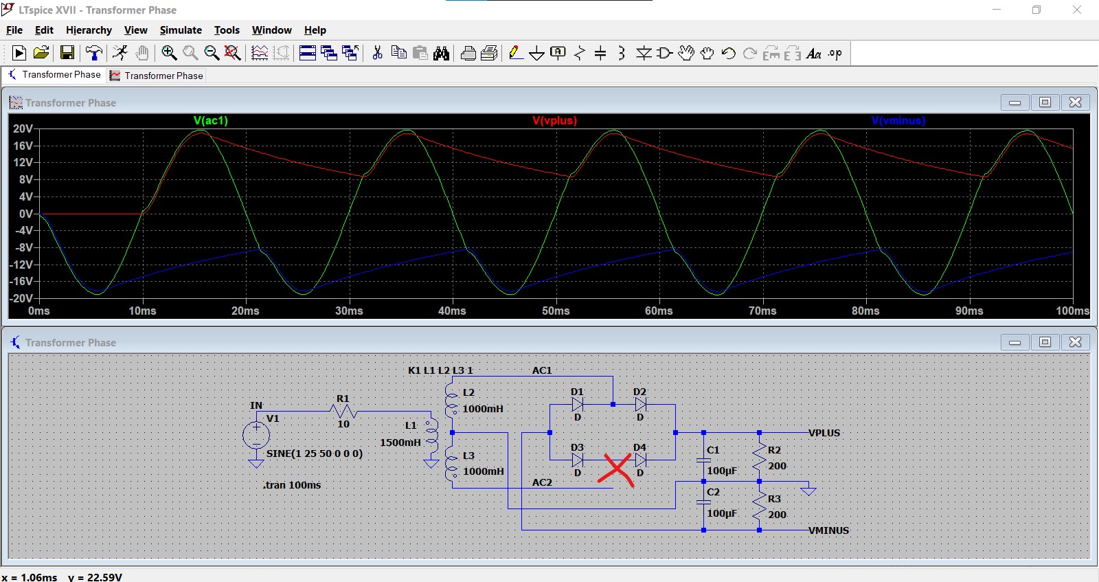

Last image shows what happens with one diode from each half of the bridge open circuit. Now it all behaves as a half wave rectifier and we get 50 Hz ripple again.
Note... the ripple is shown superimposed on the DC voltages and so that is why it looks small.

The ground connection can be floating and not connected to anything. The probe will show voltage picked up by you from all the stray 50Hz fields in a house.
However... your scope would be OK given its 50 volt input rating to measure the secondary voltage and frequency directly. To do this connect the ground of the scope to the power supply ground as normal and then touch the probe onto either secondary fuse.
You should see a sinewave. The frequency will be 50Hz and the voltage will be around 17 volts rms (what your meter would show) but the scope will show the peak to peak voltage which will be around 48 volts from top to bottom. This is the peak to peak voltage.
The load from just the regulator idle current is enough to show the ripple voltage... normal 🙂

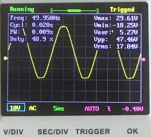

Here is the measurement taken at the secondary of the transformer as advised with no load on the output of the power supply.
So are you saying that either one of the secondaries is reversed or The Bridge rectifier is damaged and that both of these conditions would give the same 50Hz measurement instead of the correct 100 Hz?
That looks fine. The frequency is correct as displayed and it also calculates out correctly. F=1/T which is 1/ 0.02
It is 0.02 because you have the timebase at 5ms per division and so four squares at 5ms is 20ms in total.

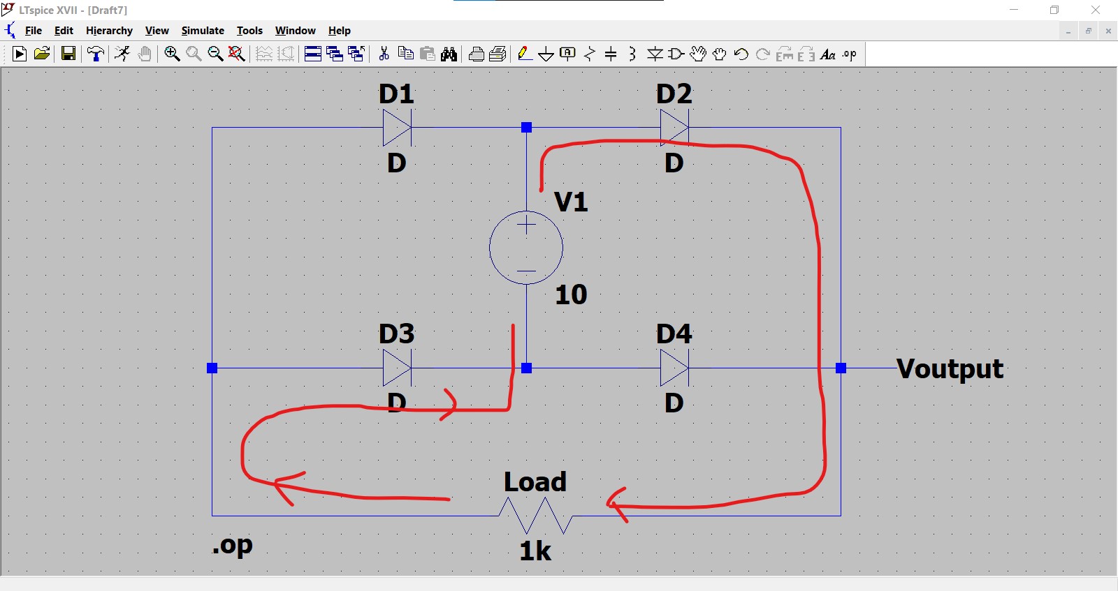

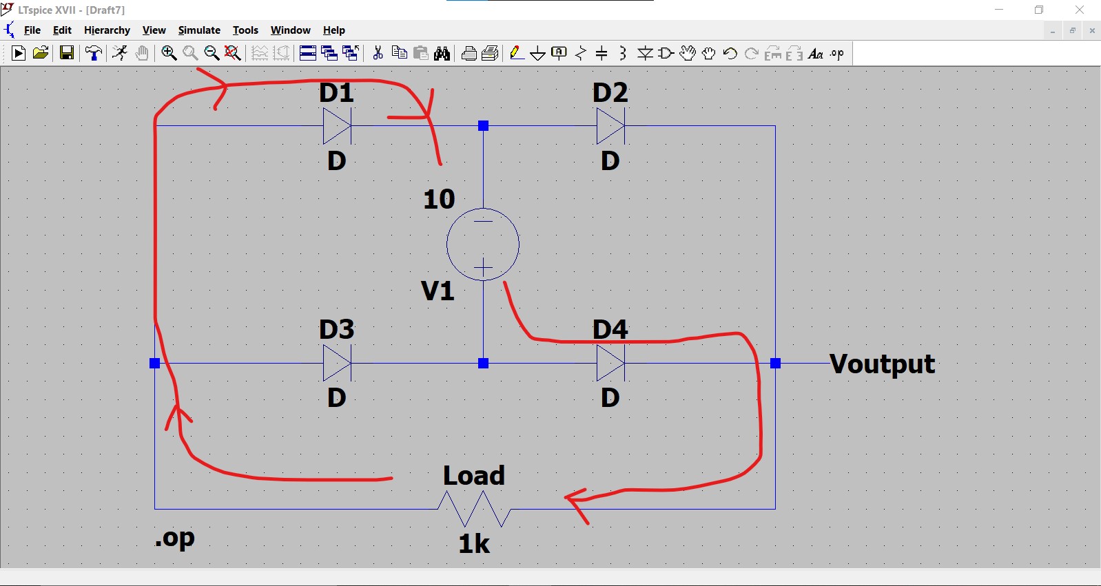

Like this. The only difference between these two images is the polarity of the battery.
The current can only flow via D2 in the first image into the load, then from the load it can only flow back to the battery via D3. You have 10 volts on the anode of D2 so it conducts. The load sees 10v less the volt drop of the diode which is about 700 millivolts.
The other end of the load sends its current back to the battery via D3. The anode of D3 is more positive than the cathode and so it to conducts. Again we 'lose' around 700 millivolts across that diode.
So the load see a voltage of 10v less the total 1.4 volts lost across the pair of diodes.
The second image reverses the supply and now the other pair of diodes conducts in exactly the same way.
The circuit converts an alternating polarity of input voltage to one of constant polarity.

One other variation on these scenarios that can cause 50 Hz ripple... but it can't be this if you are measuring on the pins of the bridge itself... would be if one or other of the windings was not connected to the bridge. In effect that is the same as two diodes going open circuit.
Here just D1 and D2 are working with each providing a half wave rectified supply and so with 50Hz ripple. The second winding isn't connected and D3 and D4 are doing nothing.
The second image shows how the complete circuit works. The second winding now tops the caps up every 10ms instead of every 20ms and so you get the 100Hz ripple.
Hope that makes sense. All points are labelled so that you can see how the voltages combine. The two AC voltages in the second image are 180 degrees out of phase (which is correct).
