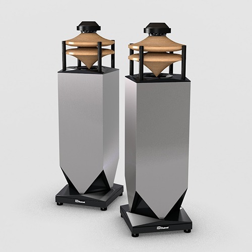

Assuming we have a Ripole as a subwoofer and are using DSP anyway, is it possible to get rid of the boxy sound
in this kind of Duevel desingn. I might try using a coax insted of two separate units:

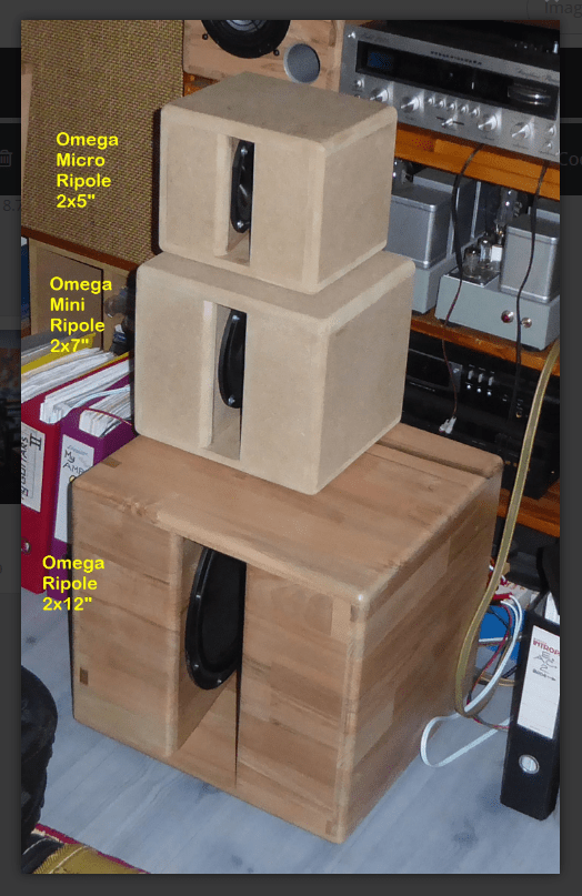

I've tried Ripole 3 times with two different kind of woofers and always has some nasal sound and never sound right when compared with simple OB. All three times they were built to push 1/4 resonance as high as possible, resonance was damped by DSP, and LP filter was at least 1/2 octave below, but still.
Maybe there are some (unknown to me) other ingredients but was not successful for me.
Before I build these I visited someone who successfully used them up to 200hz.
That is an additional plus as the midrange open baffle can be kept small.
Happy new Year
Despite what @Radian wrote - and exceptions are the rule, OK ? 😉 - all the tests I made with different Omega Ripole sizes...
... Proved rather unsuccessful for frequencies over 60 to 80Hz and over, cut at 24dB/Oct. and yes, they have then that famous nasal sound for the higher frequencies, as described by @danibosn.
A friend of mine, with its two big 2x18" Ripoles, cuts them at 60Hz, after tests at higher frequencies :

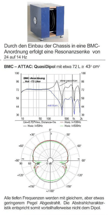

Axel Ridtahler, the Ripole principle inventor, mentions a high and sharp resonant peak of the chambers located from 200 to 400hz usually, depending on the size of the Ripole cabinet and the speaker used :
This would explain IMHO that unpleasant boxy nasal tone, occuring for frequencies approaching from near or far these critical resonant frequencies.
With my Omega Ripole (2x12", the smaller have been dismantled now), I set the FC at 40Hz to 60Hz with 12 or 24dB/oct. I use them only as an infra-bass complement, under the natural cut-off of the enclosures they work with.
IMHO, this is the best way to use Ripole principle : infra-bass only. But as I wrote, and in accordance with @Radian : there's exceptions, I guess !
@danibosn : maybe you choose a too high FC or a too smooth crossover slope ? 🤔 At least, it's the 1st idea coming to my mind, by my experience...
