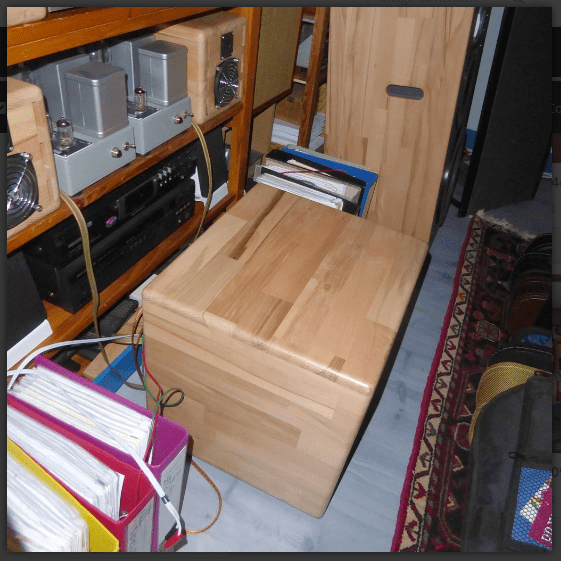

Oh, I'm sure that you can find such products in UK ! We have this in France for years in Pinewood, Oakwood, Beechwood, Acaciawood, Teakwood, usually in 18mm planks, or thicker if it is for kitchen worktops. These are available in DIY supermarkets here (Castorama, Leroy-Merlin), and you certainly have the equivalent shops in UK...
@tubelectron Do you have any more details on that sub? I seem to remember seeing it before, but not sure where.
Yes. Mr Axel Ridtahler is the inventor or the Ripole principle, but the Omega Ripole design idea is from me (AFAIK !). Have a look there :

Ditto to all you said. And the floor space can even be reduced to half.This is the only parameter where a Ripole Subwoofer would not be at his advantage : dB per Watt ratio. Otherwise, for all the others ratio mentioned in your post, @perrymarshall, the Ripole principle could compare very favorably to the other type of Subs.
---> Compact (mine below is 400x400x440mm, 2x12")
---> Lightweight
---> very low extension (15Hz for mine below)
---> unobtrusive but wide dispersion (effect of deep floating bass, when placed at the center of the main speakers)
---> no boxy tone or port resonance (there's non)
---> excellent damping and step / transient response (like a QTC=0.5 to 0.71 sealed enclosure)
