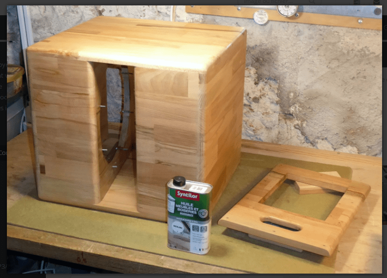

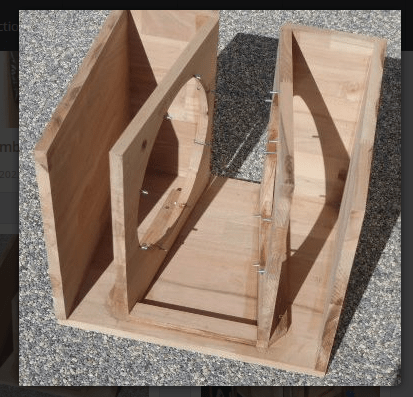

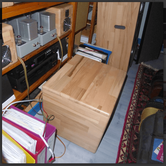

This is the only parameter where a Ripole Subwoofer would not be at his advantage : dB per Watt ratio. Otherwise, for all the others ratio mentioned in your post, @perrymarshall, the Ripole principle could compare very favorably to the other type of Subs.
---> Compact (mine below is 400x400x440mm, 2x12")
---> Lightweight
---> very low extension (15Hz for mine below)
---> unobtrusive but wide dispersion (effect of deep floating bass, when placed at the center of the main speakers)
---> no boxy tone or port resonance (there's non)
---> excellent damping and step / transient response (like a QTC=0.5 to 0.71 sealed enclosure)
T
If one need to compare different type of boxes in bass region, best is to compare SPL level per driver cone amplitude, in other way it can be called acoustical efficiency.
