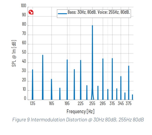

I am attaching the IMD results for a very expensive and very well regarded driver, used in very expensive hifi speakers
I have two questions
1) why the graph is truncated in the lower range ? (the 30Hz test tone is missing from the graph)
2) testing at only 80dB/1m makes much sense ? (considering that some music peaks can reach easily 100dB the IMD at let's say 95dB could skyrocket )
Please give me your opinion/advice

Manufacturers don't post IMD because they don't have to. They sell drivers without it. Because the box design and crossover can affect IMD, measuring that on a standard baffle is not much use. You'll note the HD chart post 14 was for a packaged speaker, not just one of the two drivers. That published number didn't sell many speakers, 99.99% of the SP2(2004) model sold to bar bands that like their guitars rather distorted. They buy pedals to do just that. Hardly anybody bought SP2(2004) because it reproduced Steinway grand piano accurately @ 1/8 watt. Many that like the latter test bought Klipsch Heresy at about 3 times the price of the SP2(2004).1) why the graph is truncated in the lower range ? (the 30Hz test tone is missing from the graph)
imho IMD together with FR and CSD can be very useful to select a driver
The graph you posted was IMD 30 hz + 255 hz, @ 80 db, so obviously 30 hz line would be the same as the 255 line shown, 80 db.
You will see from the HD chart post 14, HD was 10 db higher at 10% rated power (50 W) than at 1% rated power (5w). So if a manufacturer is puffing IMD, he wants to show it as low as possible. Besides, home users listen at 80 db quite a lot, me somewhat lower, 75 average. Bar bands OTOH play at half or more rated power 90% of the time.
