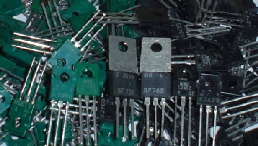

For the VAS, Fairchild's KSC3503/KSA1381. Mouser carries these devices for pennies. They are Sanyo's 2SC3503/2SA1381 clones.
Myhrrhleine,
Here are the requirements:
Faster than 150MHz
Cob less than 2pF
Flat hfe from 1mA-20mA across a wide voltage range
Strong SOAR curves to resist 10-20mA with Vce of 100V
hfe up around 150 minimum
For these reasons I go for 2SC3423/2SA1360, though Syn08's choice is a good one too. I find the NPN has slightly lower Cob and higher beta.
Hugh

MJL3281A and MJL1302A are good, provided of course you can guarantee getting real ones!
KSC3503/KSA1381 are indeed good devices. Generally, look at any transistor designed for CRT driver use - they are generally fast, high voltage, with low Cob.

But instead of going back to assembling overpowered amps with loads of antiques lying idle overhere , i'll rather pick NEC A1142/C2682 if more voltage is needed than the Toshiba A1360/C3423 handle.

I just tried out the 2sc3953 (Video driver originally from Sanyo, but I tried the Fairchild clone), and it is nearly perfect for NPN VAS use: 120V, 0.2A, 1.3W, 400 MHz, Cob=2.1 pF. Hfe was on the low side at ~60 on a DMM, but they were clustered like peas in a pod - a batch of 10 ranged from 59-62.
It works and sounds extra-fine and super-detailed to me, even with the low gain, in a single-ended VAS with bootstrapped load and 68pF styroflex miller cap. I'll experiment with smaller miller caps later, but it's already exceeded my expectations sonically. The 'tish' sound of cymbals now extends for several seconds, and one can clearly hear inhalations of performers playing pipes and trumpets.
There's nothing to prevent the 2sc3953 from being used as the upper transistor in a cascoded NPN VAS or Wilson Current Mirror - with a high-beta, low Vceo transistor as the lower transistor (almost anything will work here - BC550c, 2sc3112, or maybe even a FET).
Another choice for the upper transistor is the Philips BFQ232, with an fT of 1200 MHz, but that's probably overkill.

These VHF transistors often have low gain. It seems to be intrinsic to the construction.linuxguru said:I just tried out the 2sc3953 (Video driver originally from Sanyo, but I tried the Fairchild clone), and it is nearly perfect for NPN VAS use: 120V, 0.2A, 1.3W, 400 MHz, Cob=2.1 pF. Hfe was on the low side at ~60 on a DMM, but they were clustered like peas in a pod - a batch of 10 ranged from 59-62. .............................Another choice for the upper transistor is the Philips BFQ232, with an fT of 1200 MHz, but that's probably overkill.
Going to slightly slower, <=300MHz, can usually get a more satisfactory gain.
Sanyo's 2sa1407/c3601 is an example of an exception to this rule but it is rather expensive for VAS & Pre-driver. Cob is slightly high cf Aksa's specification, but I'm told it works very well for this duty.
I like the sound of the 1360. It's cheap and performs.
