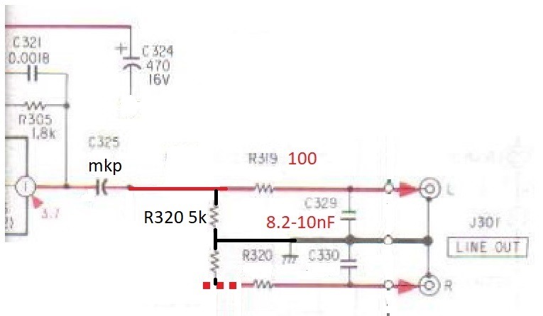

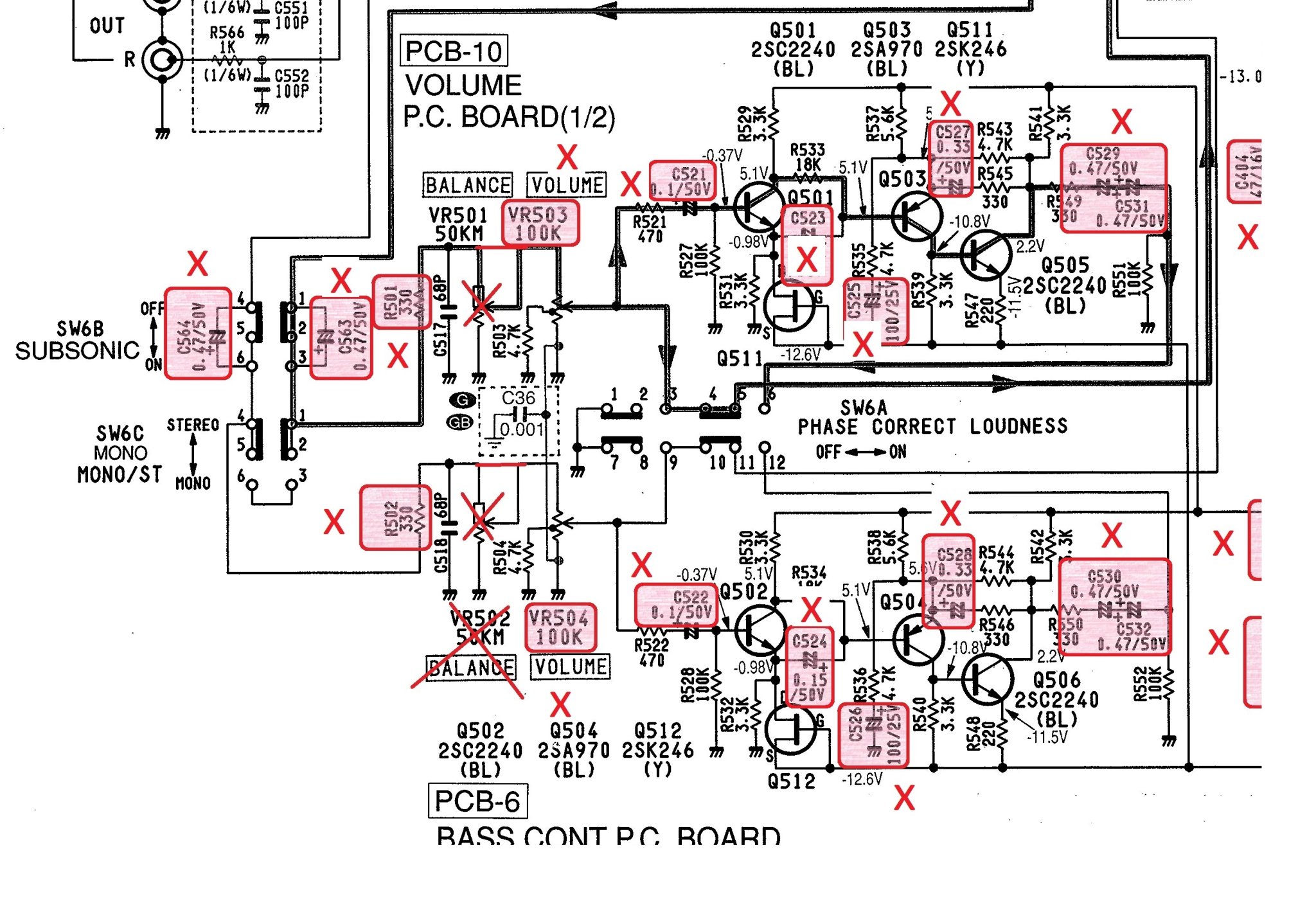

Modifications :
the output stage + muting are visible on the jpeg.
I placed a filter on the sector, the ground (floating) is connected to earth.
Soon I will dismantle the facade.
Can you guide me to correct my error please ?
You will have to back track over all the work and modifications you have done. The transformer heating up quickly and humming points to short or near short on a supply line. DO NOT let the transformer run for to long like that because if there is an embedded thermal fuse it WILL fail when hot enough and then the transformer is scrap.
Nothing you have done in the output and muting could cause this unless you have introduced a short somehow. Make sure any PSU caps are the correct way around. Feel them and make sure they are all cold.
