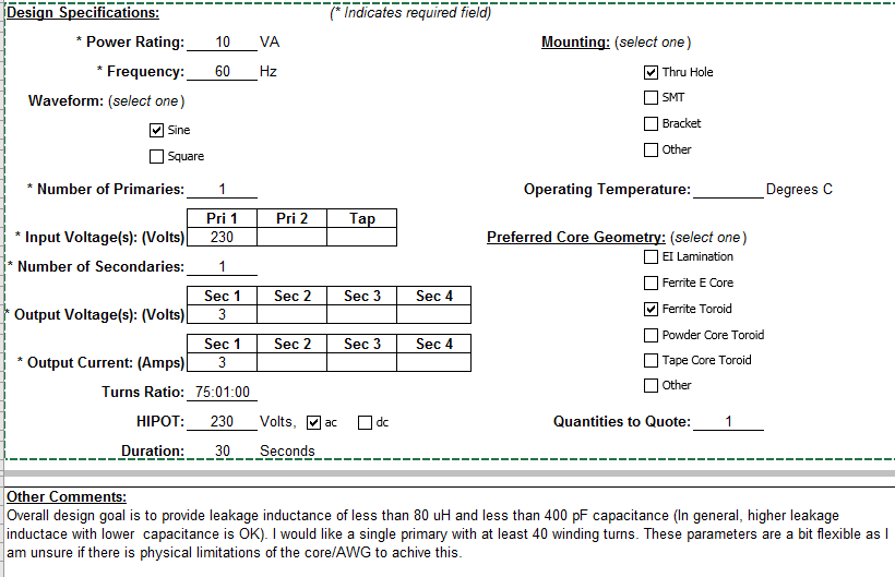

Oh no... not winding them myself :). Just trying to put together a spec to have a professional transformer shop build it for me (just getting a quote).
Attached is what I got so far... (appreciate any feedback).

Hi
If you want to keep within the transformer manufacturers normal play area, I would use a silicon-steel tape-wound toroidal core, as is normal for toroidal power transformers. You can play games with using materials with a more linear permeability for the core e.g. ferrite, but the cost is higher and there is almost nothing to be gained.
If you want the simplest and cheapest quote, I would suggest sticking with a 50 Hz 10 VA 230p/6s with a single secondary winding and buying eight of them (4 for each ESL)
Moving to transformers that operate directly at the higher voltage is not so simple and certainly takes him into a new part of the sandpit . If you want to do a pair at 1:75 step-up ratio with 60 Hz rating, then the low voltage winding needs to be 7.2V (to compensate for the slightly higher frequency) in and the high potential side must be 540V (=7.2V*75). As a secondary condition you want leakage inductance below 80 mH (I note you used uH on the sheet) and winding capacitance below 60 pF. But in my experience, transformer manufacturers are not so hot on getting the design right when you specify the impedance measurements. This is likely to more hit and miss unless your manufacturer is particularly approachable.

Thanks for the help.... I will submit that to him and see what comes back. Good catch on the units for inductance... a typo on my part :).
@ 10VA it would have a max current of 1.4 amps on the secondary. I am curious as to what kind of impedance/load this would present to my amp throughout the bandwidth (250hz to 20ish khz).... i.e. I don't want to smoke it (or more likely, trip the protection limiter).
Even if this doesn't work out at least I am learning something about ESL transformers :).
Again, thanks for all the advice/help....
