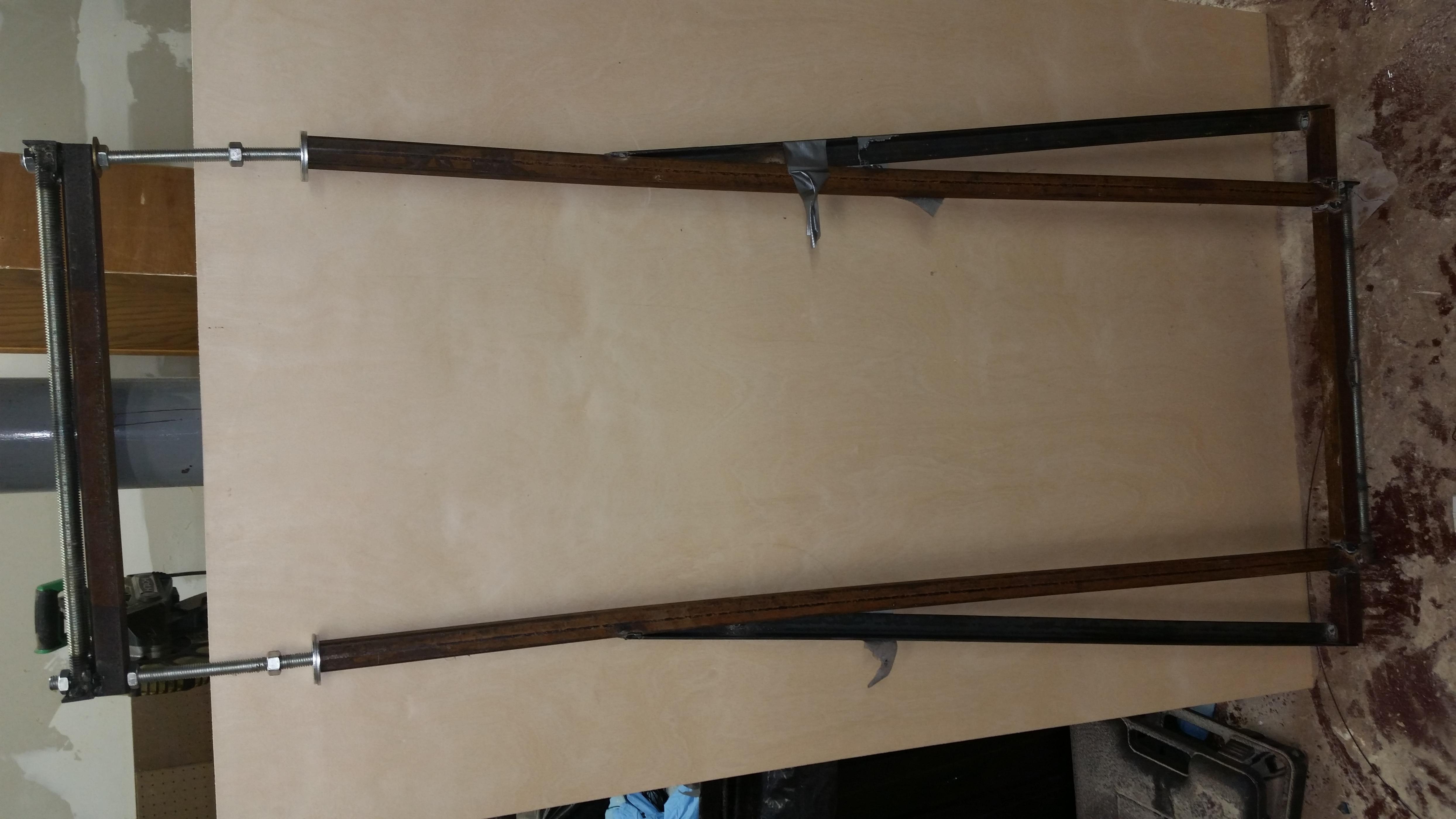

As mentioned in other solid PVC wire stator build threads, the wire is stretched 2% - 6% to straighten and cold work(strengthen) the copper wire. Then, tension is released and the wires glued to the frame. The completed stator frames lay perfectly flat with no warping.... Beyond the yield point wire tension will remain constant with an increased stretch (neglecting the strain hardening etc).The purpose of this should be to align and straighten wires. If the tension is left, then panels may/will warp due to uneven relaxation of wires...
I stretched my wires somewhere around 1%-2%. Enough to get them very straight and flat. I released most of the tension but left a little to keep the wires straight and then glued them down.

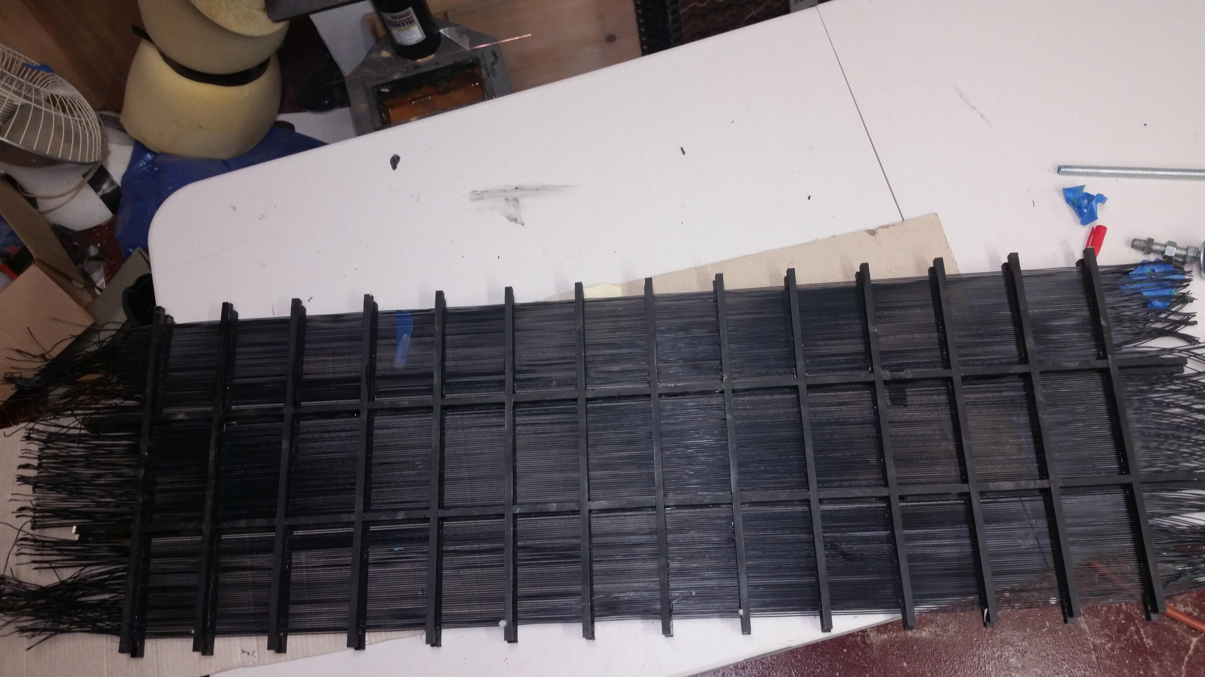

Been out of town etc... for a awhile since I last posted so I thought I would give an update.
I've completed one set of wire stator panels (2 more to go). Had a lot of difficulty dealing with only being able to partially wind a pair due to the jig bending but managed to get together a set of grids that are a "matched" pair. Aesthetically, I am not terribly happy as the space on the vertical spacer is not symmetrical but I do have 3 groups of 49 wires (7 per physical seg).
So, one lesson learned here is do not underestimate the strength need for the tensioning jig, especially for wider panels. I saw a picture one jig made out of wood and I don't know how that worked unless they were fairly narrow panels (didn't have a good sense of scale).
I am not entirely happy with the E6000 glue either. I used the medium visocity, self leveling glue variety and I found myself "pushing" the glue down thru the wires (in my case it is applied on top of the wires and soaks thru to the grid frame). It did "level" pretty good but it is not flush with the wires... you can feel a little bump with your hands as you go over it. With the spacing running about .065 I worry about every .01 inch 🙂.
Next steps is to wind up the next set, which I expect to go significantly smoother with the mark 2 version of my stretcher...... though... believe it or not; it is still not strong enough for my liking.... but it is good enough to get the job done.

I've attached some pictures.

Glad to see you're back on track (also wondering if you saw the PM I sent you a couple of weeks ago).
I haven't tried double stacking foam tape. It would probably work OK, although there would be at least twice the lateral creep in holding the diaphragm tension.
From the photo of your panel I don't see any edge members along the sides and ends to attach the foam tape spacers to. Just wondering how you're going to do that.
I was going to suggest that you slice up some wooden spacers on a table saw of same thickness as the wires, rather than using two layers of foam tape-- but I don't see any edge members to support the spacers.
