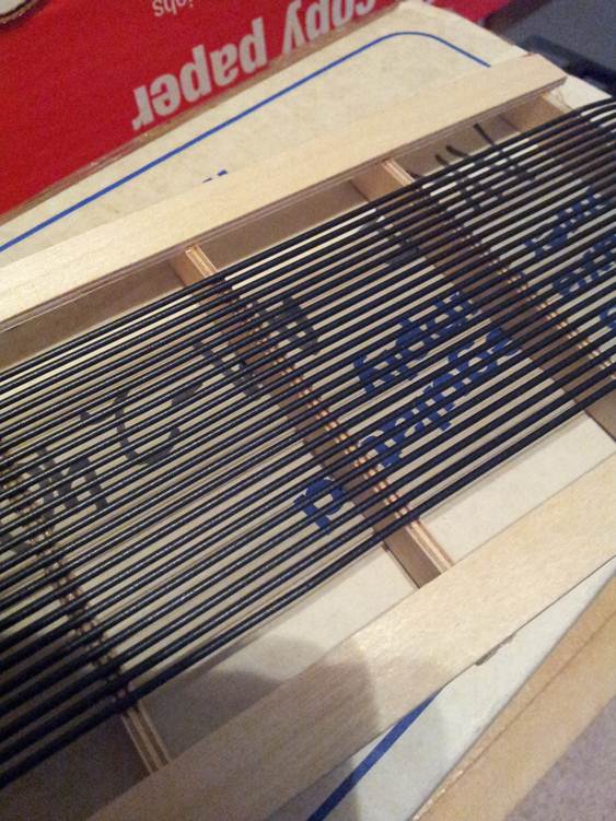

I regularly build test panels using 1/8” thick by 1/2” high crossbars made from 5-layer birch plywood. It is plenty strong. You can get 1/8”, 3/16”, and 1/4” thickness from local hobby stores, then all you have to do is rip it into 1/2” strips. Solid oak like CharlieM used is likely even stronger.

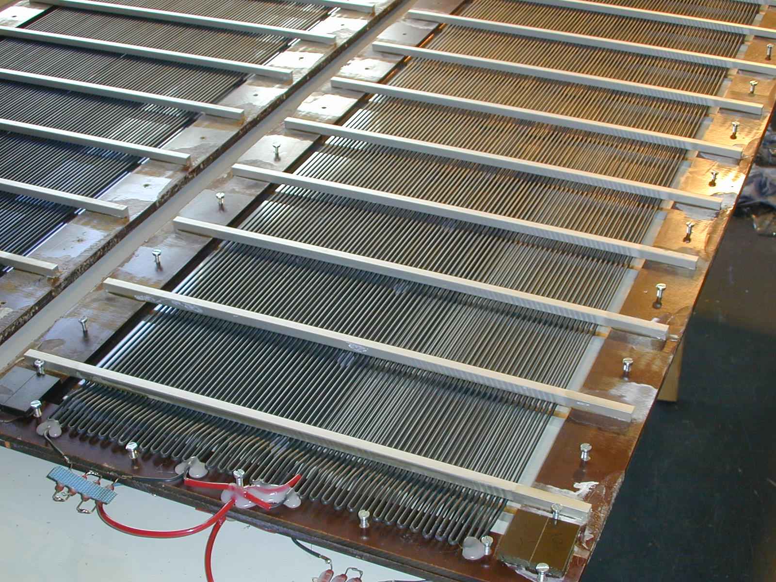

It is hard to tell, but those Acoustat panels spacers look 3/8" ish in width
Are you talking about the Audiostatic (not Acoustat) aluminum cross bars that was shown in the first pic?
If so, I think they were 8mm on the smaller models and 10mm on larger. Using metal from cross bars is good from a strength perspective, able to span large distances with minimal thickness and height, giving a nice clean look to the panels. But, they form a bypass capacitance around the ladder resistors, undoing some of the segmentation that you are trying to implement to improve dispersion.
For more details see: http://www.diyaudio.com/forums/plan...ostatic-baffle-step-filter-4.html#post3385741

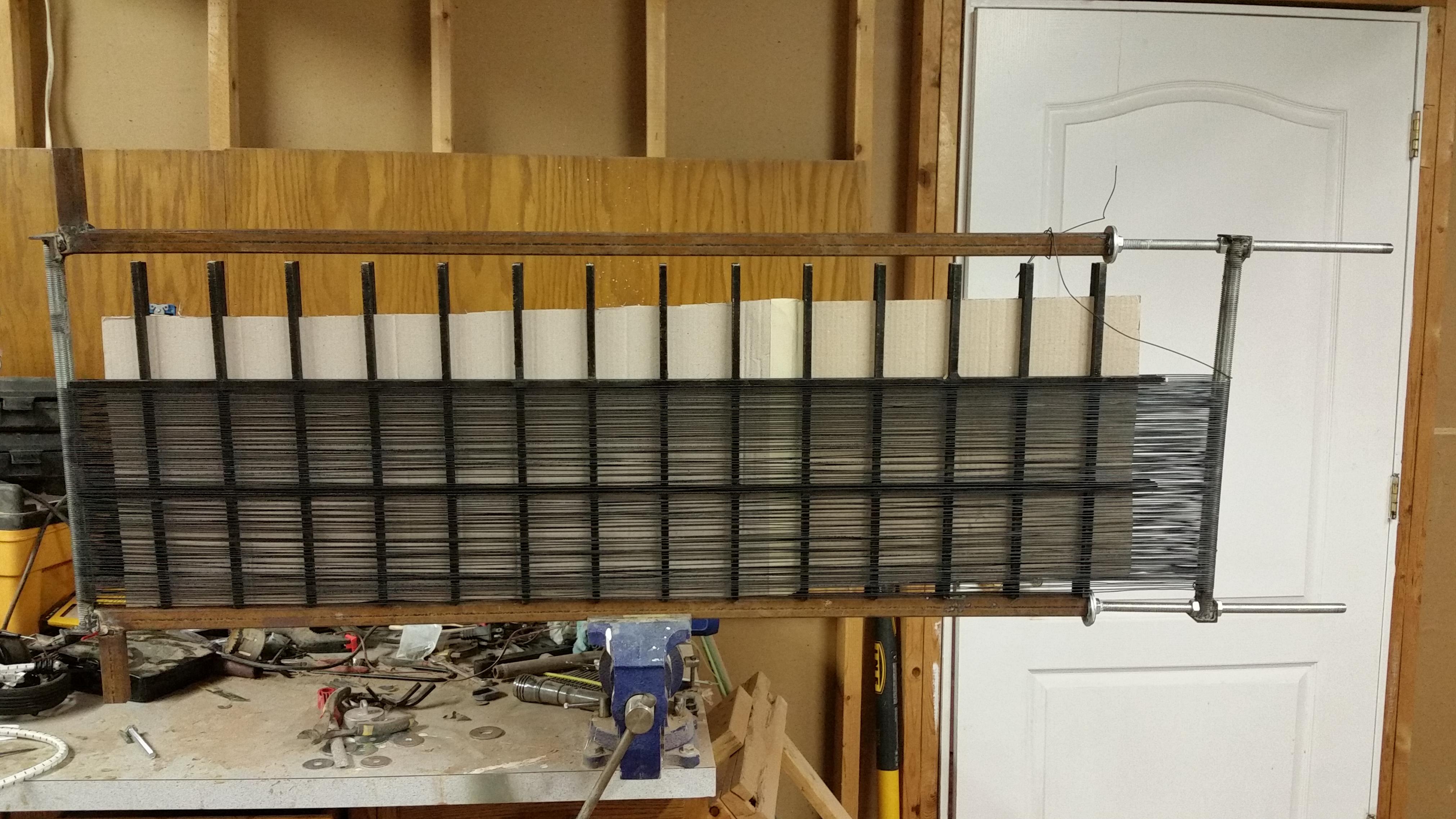

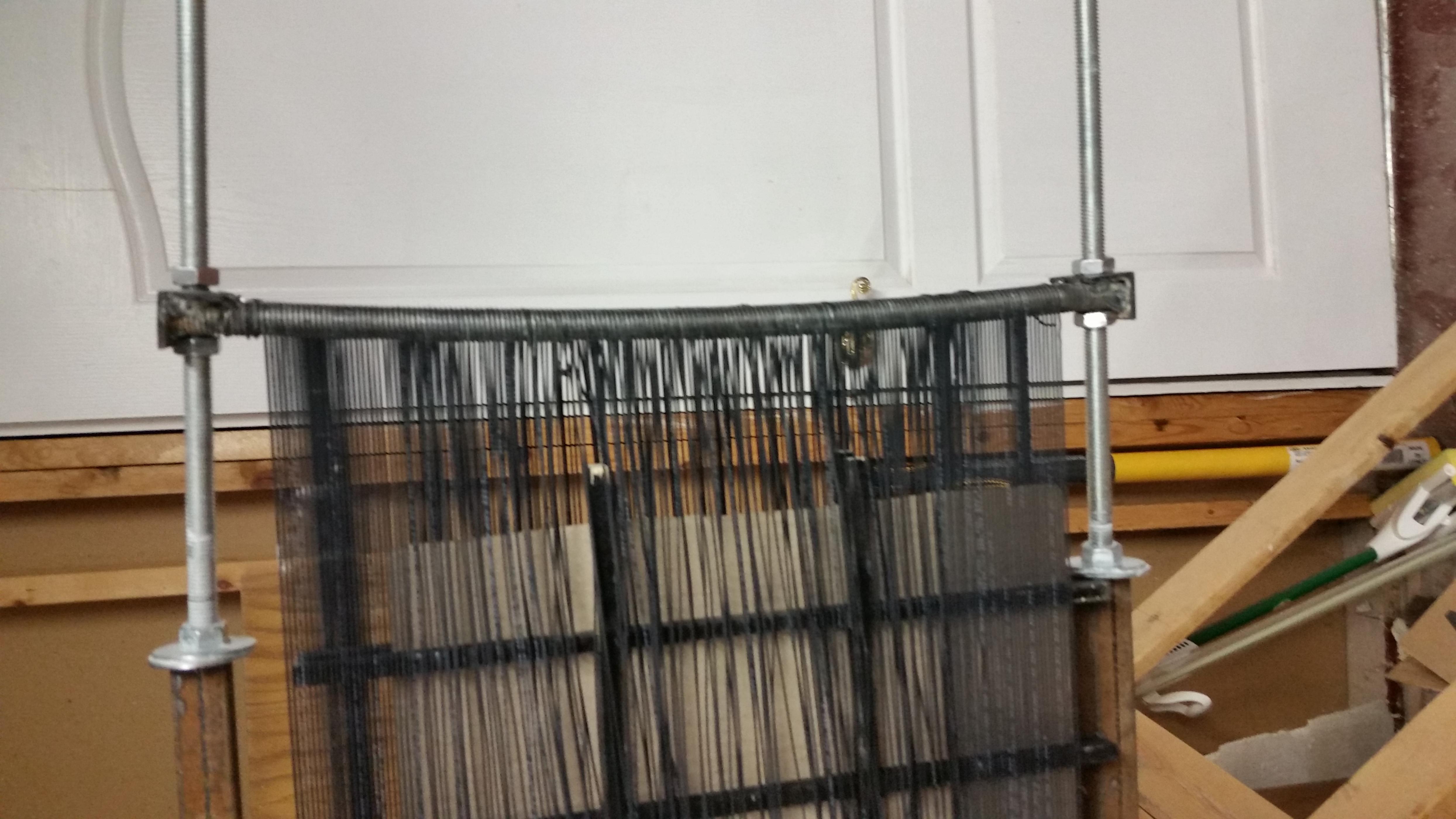

So got around to winding some wire over the weekend and thought I would share an update.
Attached are a couple of pictures of my winding jig about 2/3's wrapped.... the bad news is I ran into trouble when stretching.
Apparently, 2 5/8" rods welded together are not strong enough by themselves to stretch this wide of a panel (my jig has about 16" inside width).... so to share in my fail 🙂......I've attached a picture showing it bowing quite a bit..... The net result was, the outside wires stretched nice and straight but the inside wires didn't even come close.
Rather than "unwinding" the jig, I am going to try and salvage the situation by gluing down the outside straight wires, cut them, then stretch the wires toward the center, glue them down etc.....
Once these 2 stators are removed from the jig, I will make a new end piece and it will be strong enough......
I should've known better but oh well, live and learn 🙂
