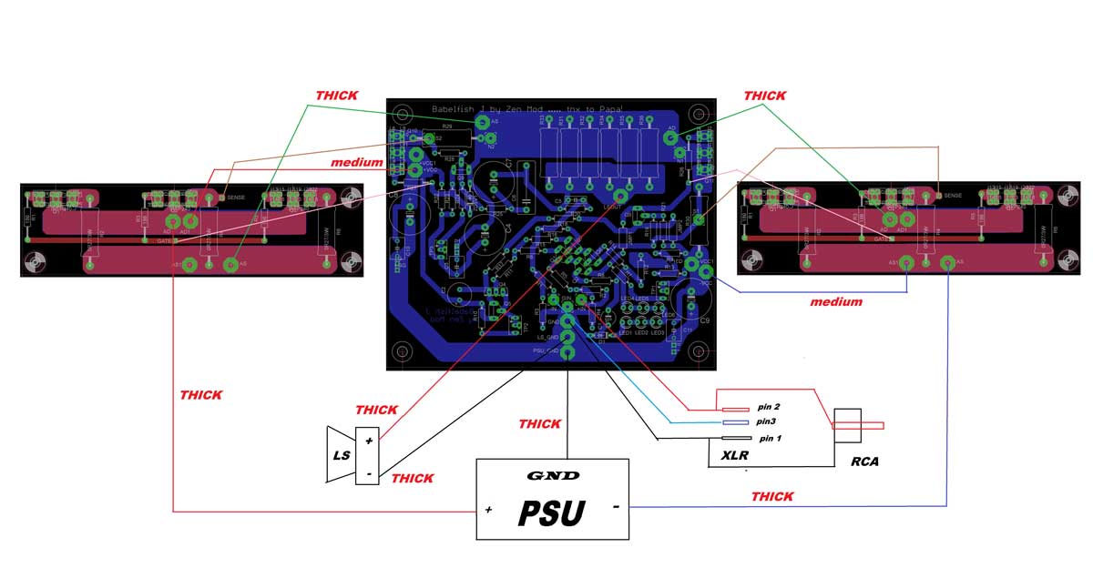

Finnaly , some graphical mishmash about Biggie version
attached pic as preview info , high resolution jpg and pdf on click
Do not mount Q10 , Q11 , R26, R27,R29 , R30
Mount (all of ) R31, R32 , R33 , R34 , R35 , R36
wire as shown
thick dia wires marked , medium dia wires marked , rest are thin
